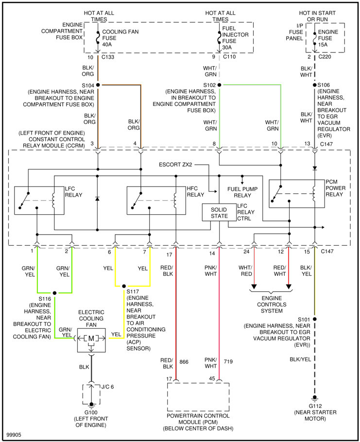

Theory of operation of the cooling fan system.
The electric cooling fan system consists of a fan and electric 2-speed motor attached to the fan shroud. Engine temperature is monitored by the Engine Coolant Temperature (ECT) sensor. Fan is controlled by Constant Control Relay Module (CCRM) with inputs from Powertrain Control Module (PCM). The electric cooling fan is wired to operate only when the ignition switch is in "on" position.
On Escort, when coolant temperature reaches 221°F (105°C) or A/C (if equipped) is turned on, cooling fan motor will turn on.
On all models, when vehicle speed is greater than 45 MPH and coolant temperature is less than 220°F (104°C), cooling fan motor will turn off.
Please look at the diagram attached below, first check the cooling fan fuse, 40A, in the engine compartment fuse box.

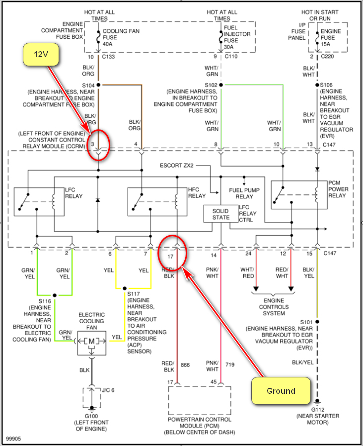

If the fuse is intact, please next check at the CCRM that there is a constant 12V at pin 3, black/orange wire. This can be done by either using a test light or a voltmeter.

Have you confirmed that there is 12V present at the CCRM pin 3?
Also, I would suggest checking if the PCM outputs a ground to pin 17. This should happen when the cooling fans are supposed to be switched on.
The switched ground from the PCM is from pin 17, red/black wire.
You can also test if the cooling fans work by supplying your own ground to pin 17 at the CCRM. If 12V is given at pin 3 of the CCRM then the fans should turn on.

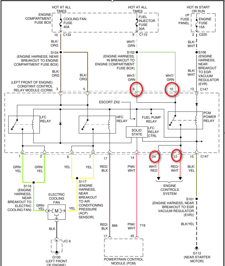

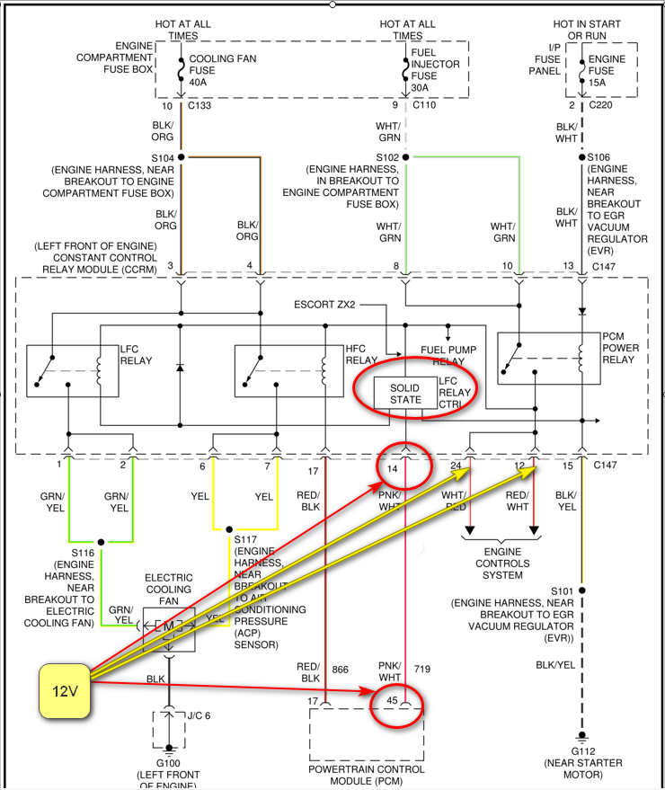

The CCRM houses both cooling fan relays and the PCM power relay.
The LFC relay, low speed, is switched on via a solid-state relay inside the CCRM.
The PCM will trigger this relay by switching 12V from pin 45 via pink/white wire to pin 14 at CCRM. The solid-state relay will then supply a ground to the LFC relay to trigger it.
The HFC relay, high speed, in turn is triggered by a switched ground from PCM pin 17 via red/black wire to CCRM pin 17.

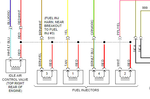

The PCM relay switches 12V internal in the CCRM to power the relays and outputs 12V at pins 12+24 to the PCM. Red/white and white/red wires (yellow arrows on diagram).

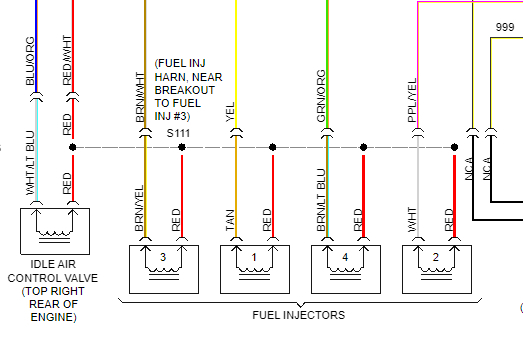

The red/white wire supplies 12V to the idle air control valve and fuel injectors, see image 2
The white/red wire supplies the EVAP purge valve, EVAP vent solenoid valve, both oxygen sensors and MAF sensor.
It would be good to check what voltage is being supplied from pins 12+24 with the vehicle running bad. Constant 12V is supplied by fuel injection fuse via 2 white/green wires to pins 8+10 at the CCRM, see image 3.
