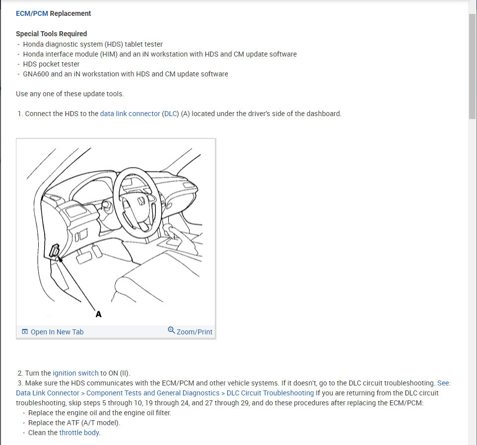

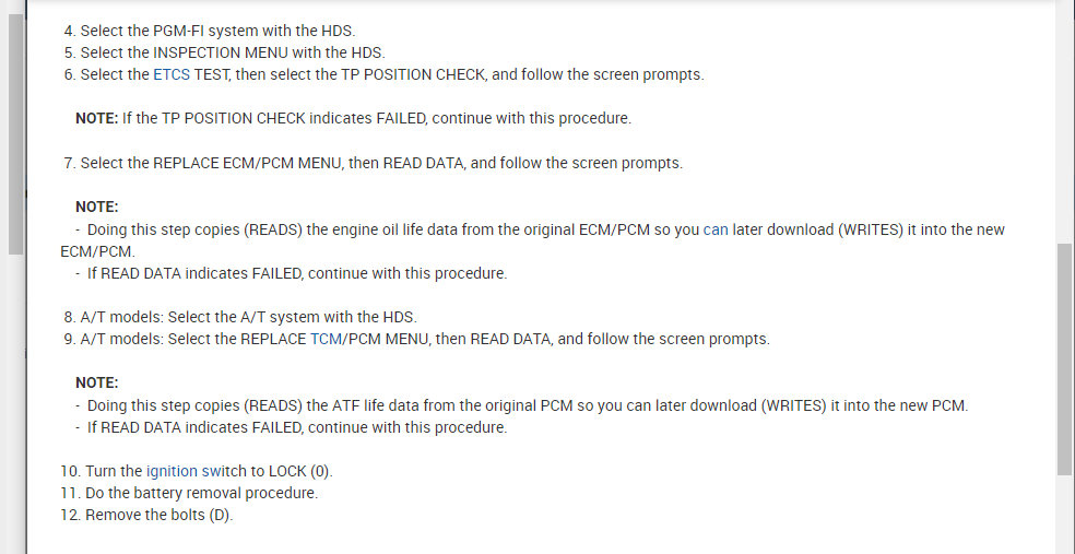

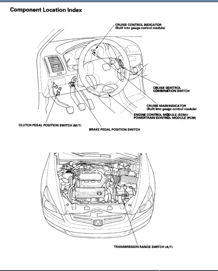

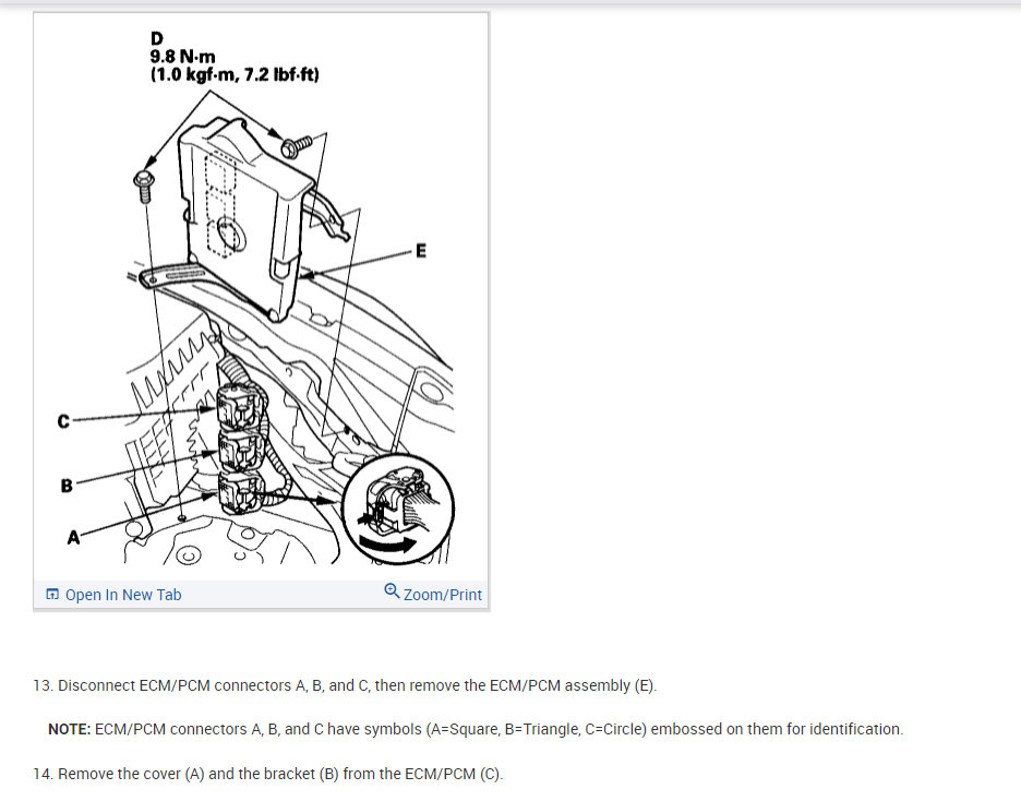

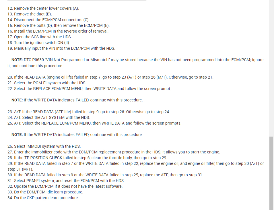

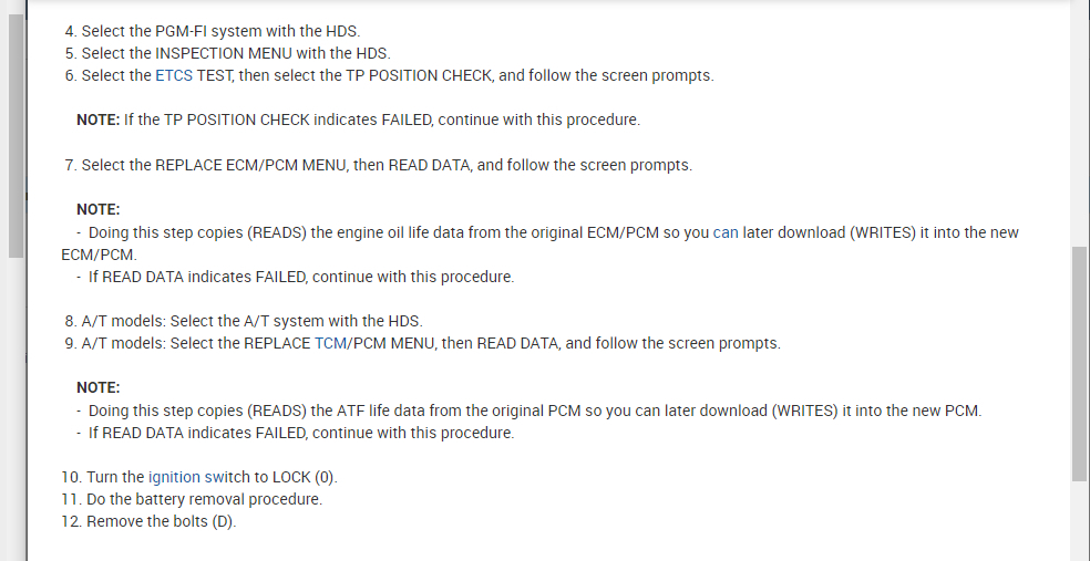

I know that others have done this but I have never actually removed the chip or altered the PCM myself to know which years that works on. So your vehicle may or may not be one that this works.
What I have done is basically get a replacement PCM that comes with this system deleted from it already.
From what I researched this year is not able to do this but I am not positive about this. I would look for a PCM that has the system deleted.
