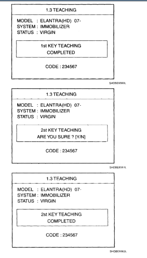

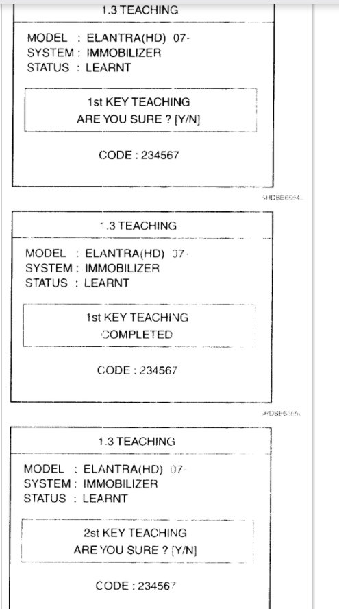

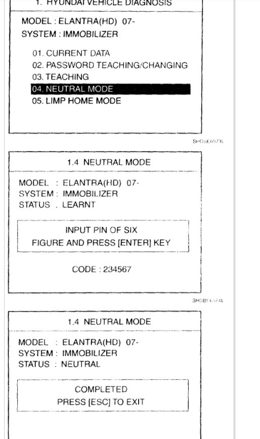

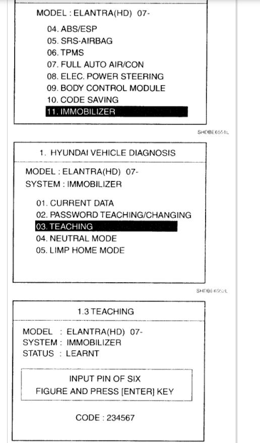

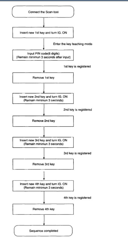

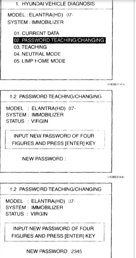

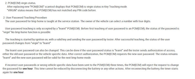

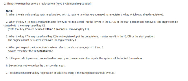

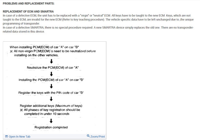

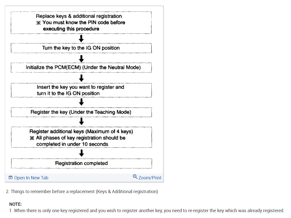

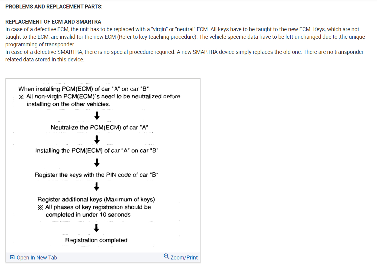

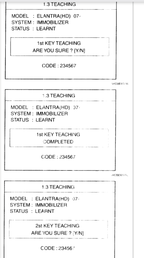

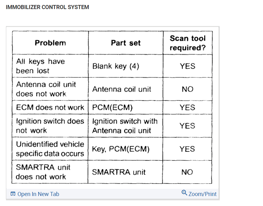

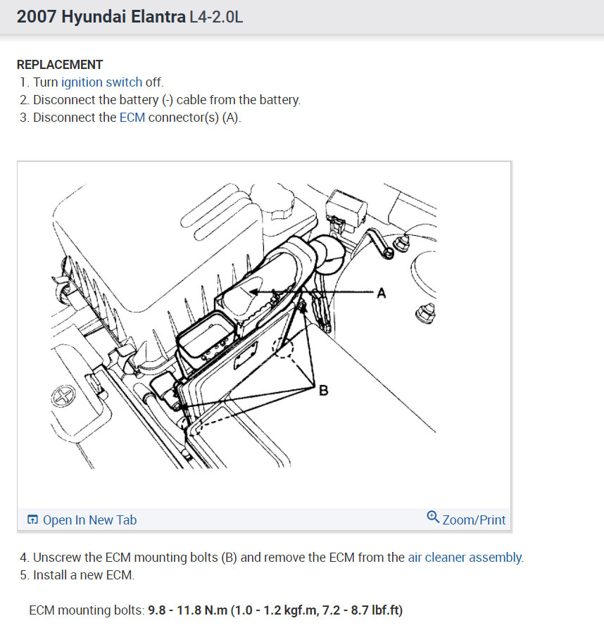

Whoever you have do the programming will need the entire car because not only the keys need to be programmed but a few of the other modules will need to be programmed to the new ECU and the VIN in the replacement ECU will need to be reset to match the VIN of the car. What was the reason for the ECU change?

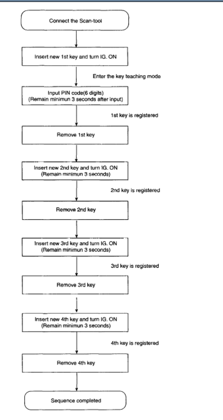

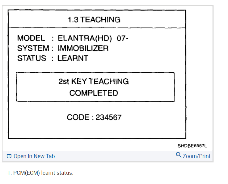

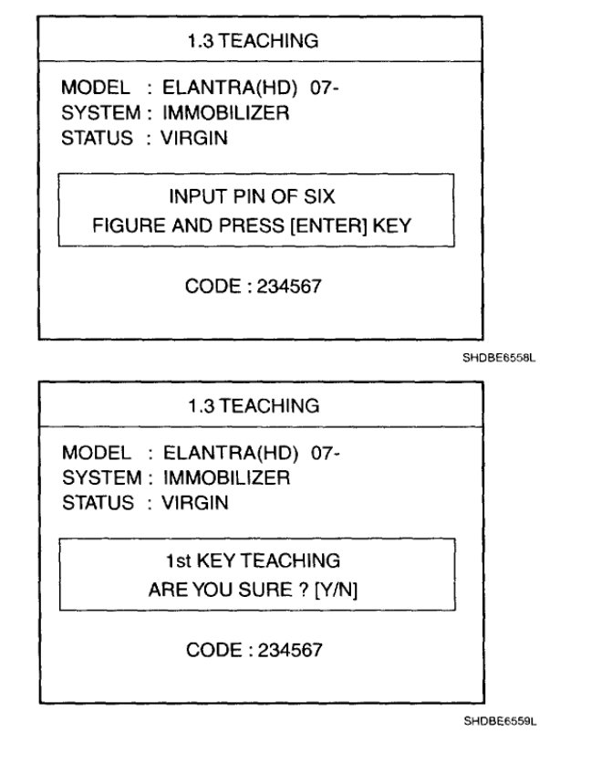

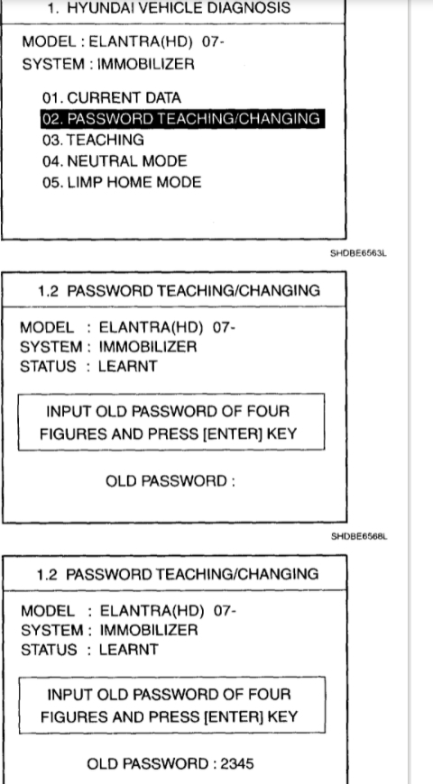

Programming keys for a 2007 Hyundai Genesis Coupe typically requires specialized equipment and procedures that are often performed by a dealership or a qualified automotive locksmith. While some modern vehicles allow for key programming without bringing the car in, this is not usually the case for older vehicles like the 2007 Hyundai Genesis Coupe.
