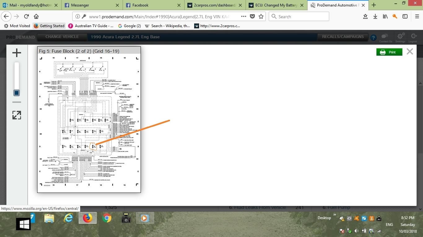

i cannot find a better picture, but this shows fuse number 5.

Thank you! I looked and fuse is good. I am thinking about buying another ECU at salvage yard to test if i get same results.
