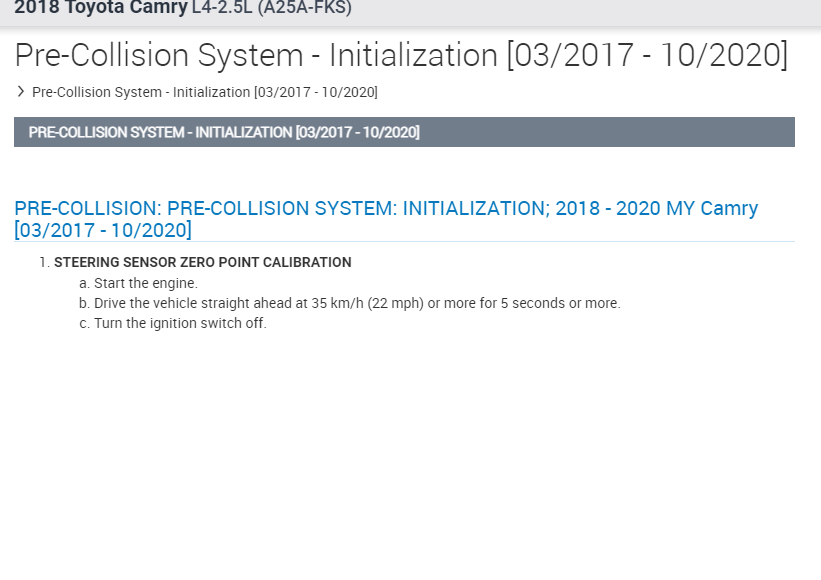

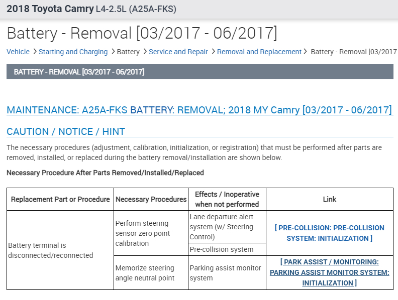

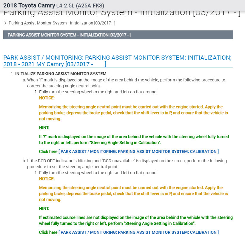

After the battery is replaced, there are two procedures need to be performed.
1.Perform steering sensor zero-point calibration
2.Memorize steering angle neutral point
I have attached the both of those procedures below.
Thank you.

According to Toyota those are the two relearns needs to be done after a battery change.
As for the codes, if any issues still exist it will get triggered again and you will be able to read them.

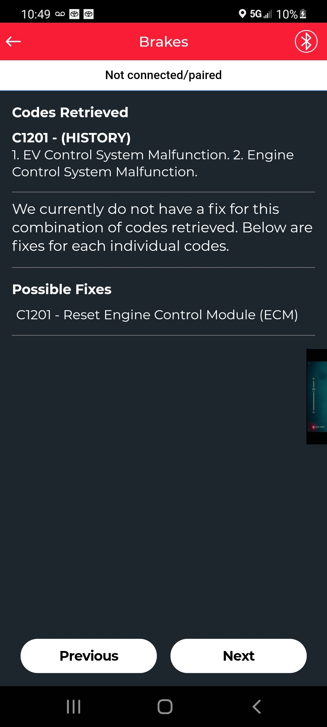

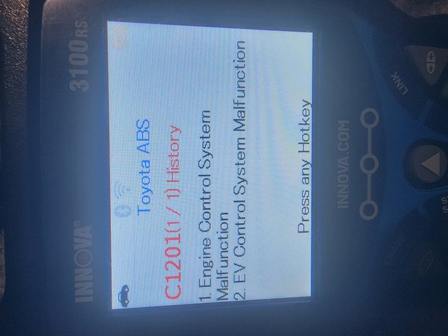

Ran my obd scanner and this is what I founded:

So those are historical codes. Are you currently having any specific issues?
Inactive code can be stored in the computer but that will not impact the drivability.

I have no codes when I run my obd2 test, but I know it just doesn't feel the same I know there is an issue.

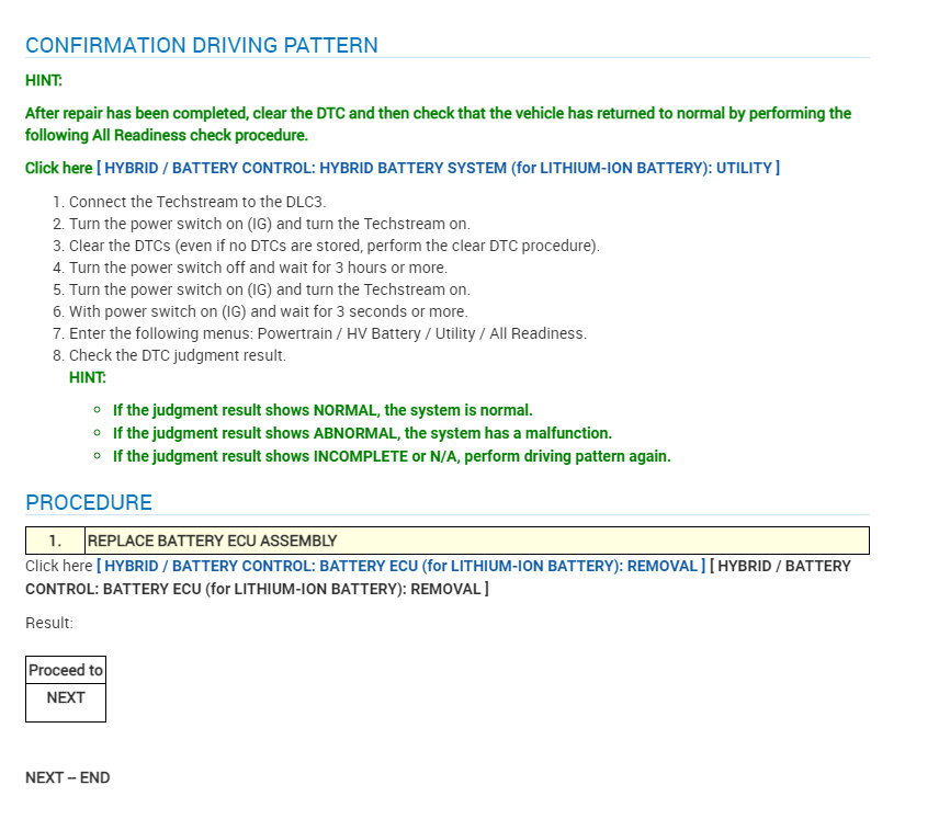

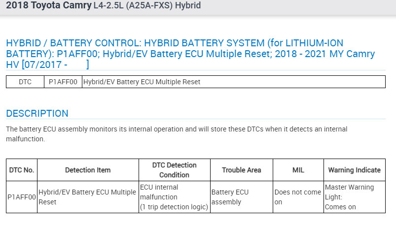

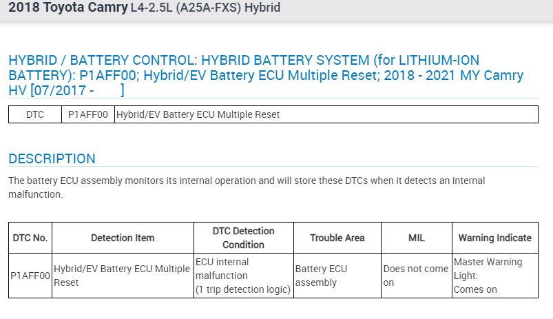

I have attached the reset procedure for the hybrid ECU below. Let me know if you are able to run through those steps.

Hey, my car is not a hybrid? Will the same process still work? FYI my car is in the auto shop to fix my rear bumper damage.

  • 6,383 POSTS
Well, the code showed to be for the Hybrid Camry. And that procedure is for the ECU of the Hybrid system.
