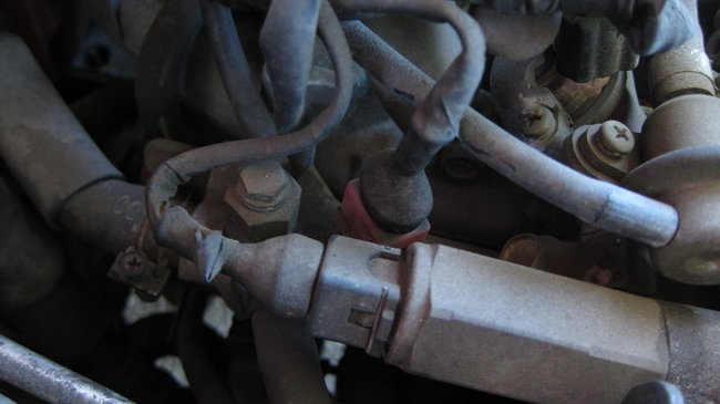

I believe that this gizmo with the red cap is the ECT sensor. Is that correct? It looks very different from what you have in your video. Sigh.

The red cap is the connector. That is the sensor.

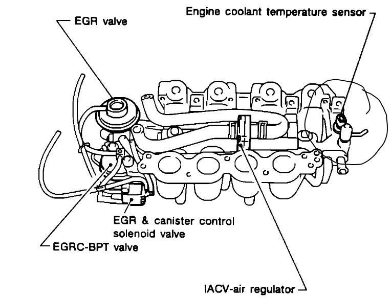

I attached a picture of the location for you.
