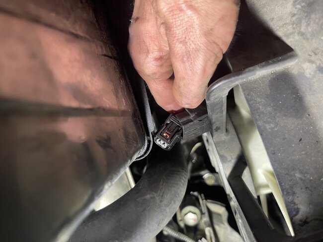

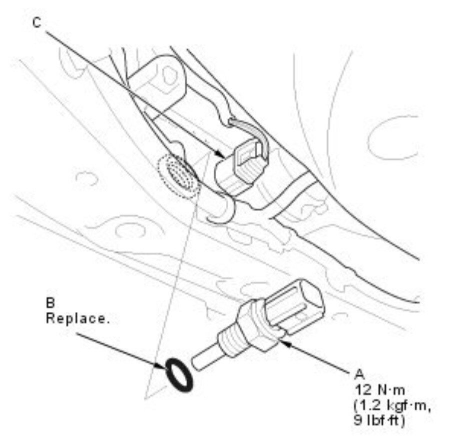

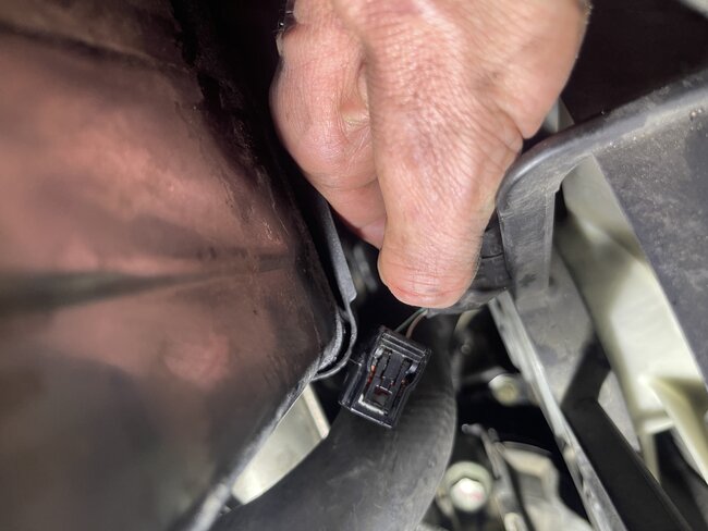

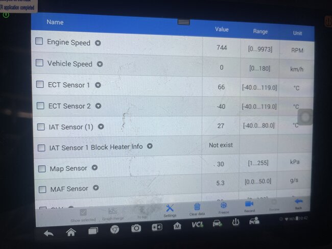

Where is the ect sensor on these v6 3.5l motors? I replaced the motor, and this is all the codes i have. I replaced the one on top of thermostat from old one, still says ect 2.
