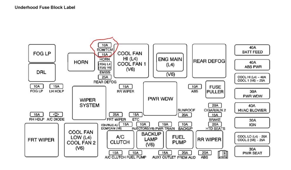

ECM/TCM keeps blowing to the point can't put a fuse back in.
Feb 21, 2021 at 1:37 PM
Good morning,
I would start by disconnecting the engine control module and see if the fuse still fails when the key is turned on.
If it does, there is a wiring issue between the fuse and the engine control module.
If it clears, then the engine control module is the issue.

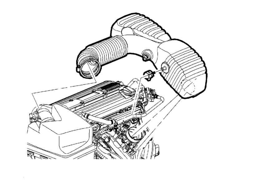

Removal Procedure
1. Using a scan tool, retrieve the percentage of remaining engine oil. Record the remaining engine oil life.
2. Disconnect the negative battery cable.
3. Disconnect the intake air temperature (IAT) sensor.
4. Loosen the clamp at the air cleaner assembly.
5. Remove the push pin attachment from the outlet resonator/duct assembly to support bracket.
6. Loosen the clamp at the throttle body assembly.
7. Disconnect the positive crankcase ventilation (PCV) fresh air hose at the cam cover.
8. Remove the outlet resonator/duct assembly.

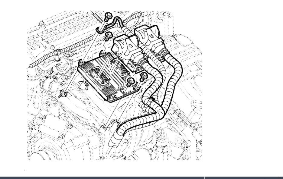

9. Remove the J 1 and J 2 connectors at the engine control module (ECM).
10. Remove the 4 ECM attachment bolts.
Installation Procedure
1. Install the ECM.
Notice: Refer to Fastener Notice.
2. Install the ECM bolts.
Tighten the engine control module bolts to 8 N.m (71 lb in).
3. Connect the J 1 and J 2 ECM electrical connectors.
