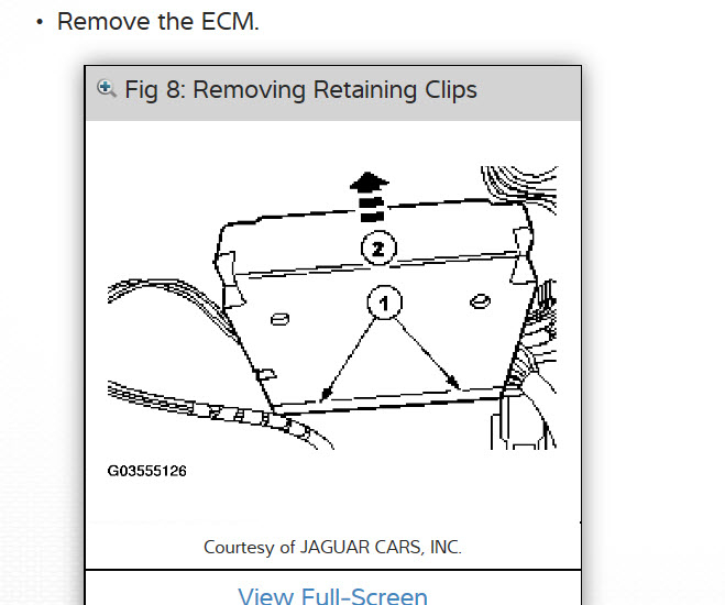

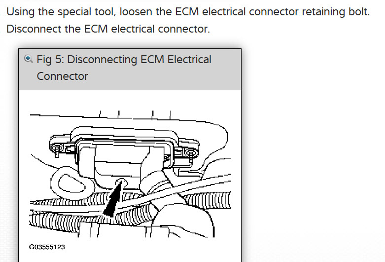

how do I remove my ECM? I have removed the glove compartment and have access to it. Do I need to remove the air filter/holder on the left side of the engine compartment (looking rearward) to get to any plug bracket etc?
