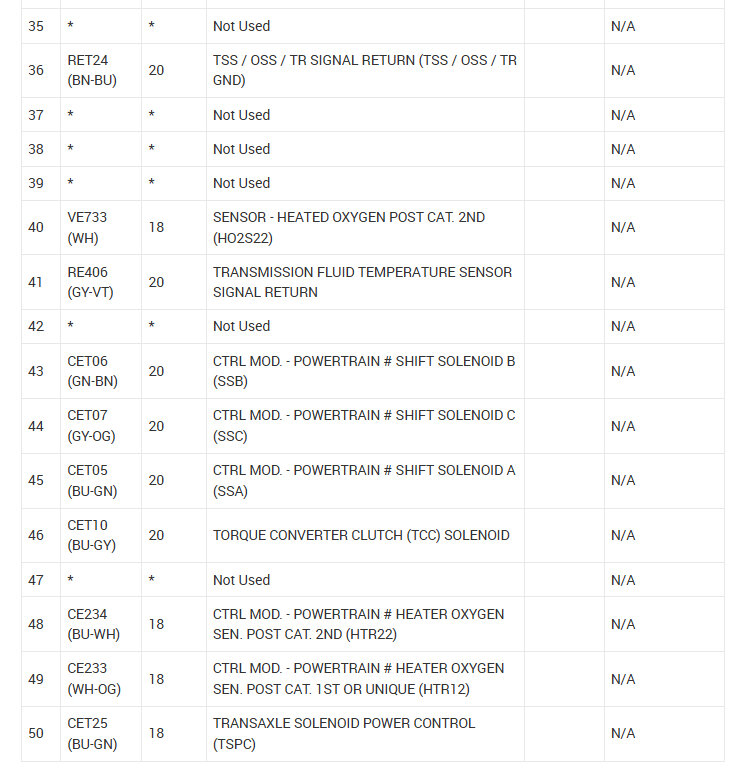

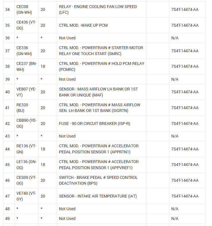

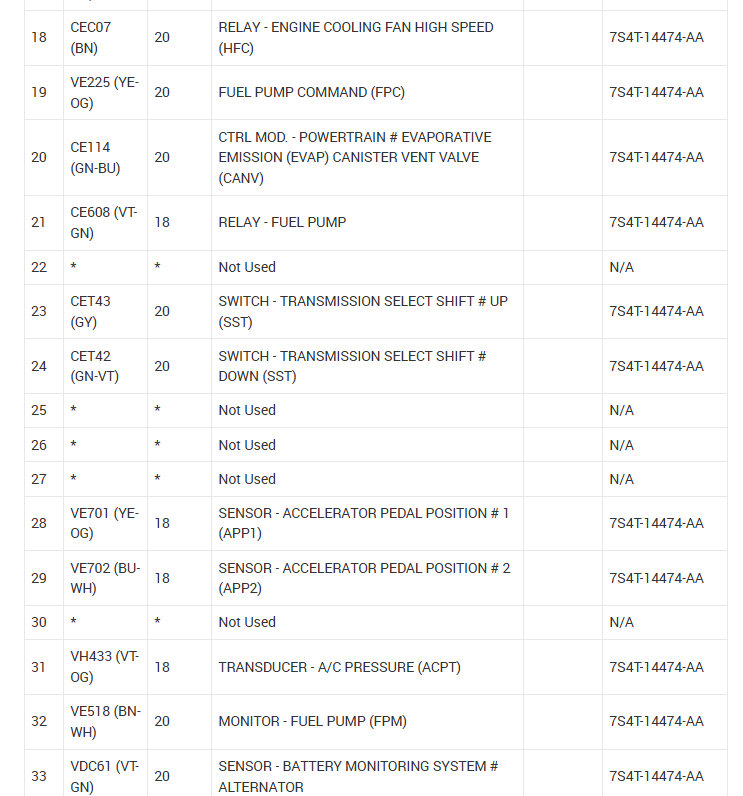

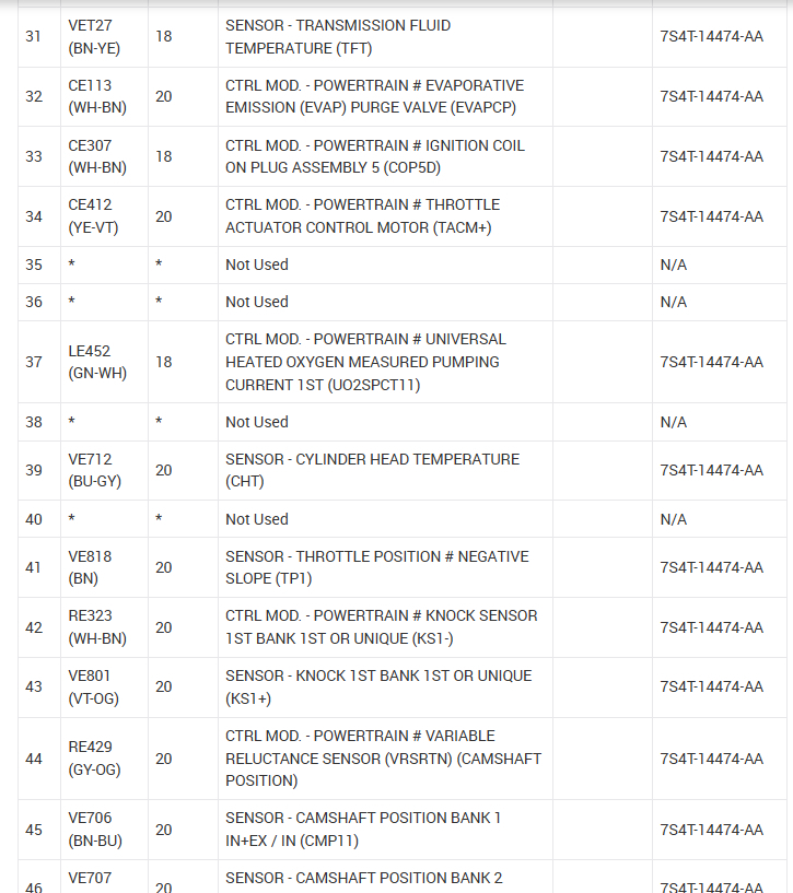

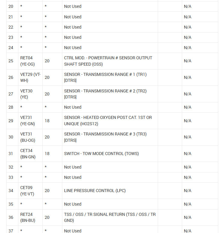

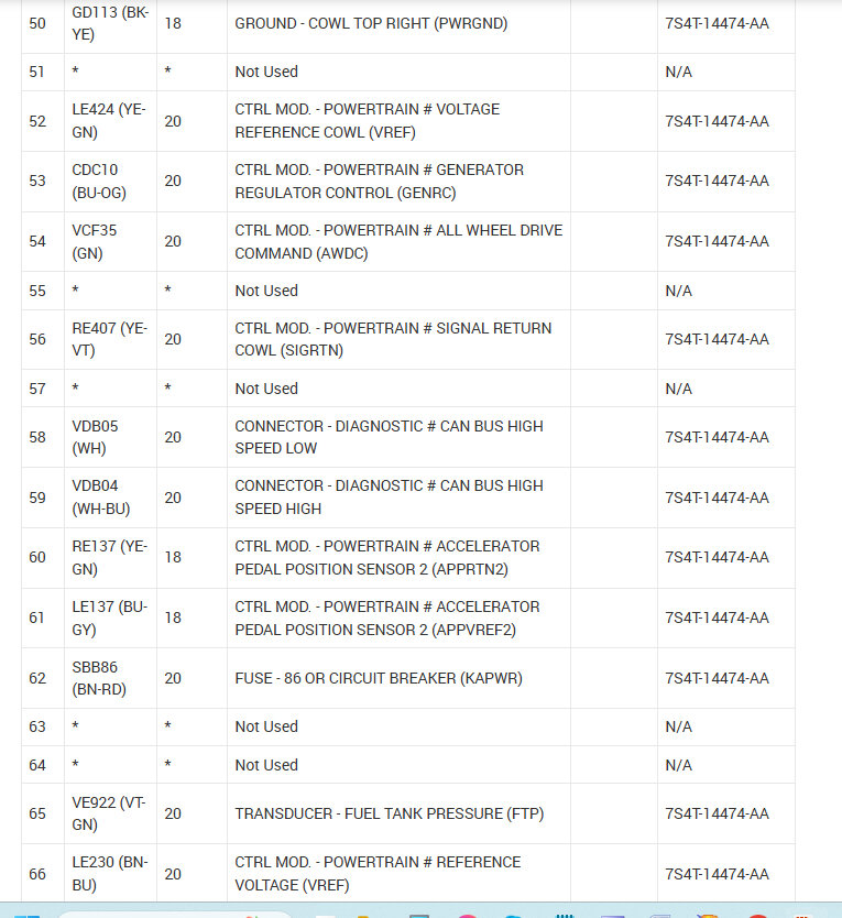

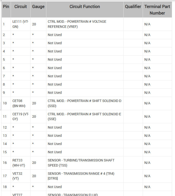

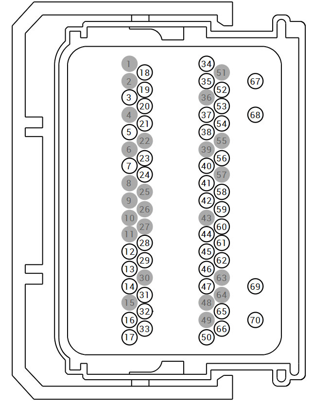

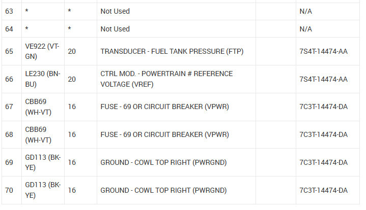

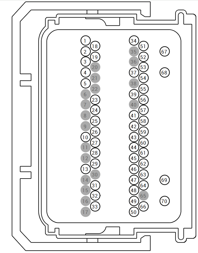

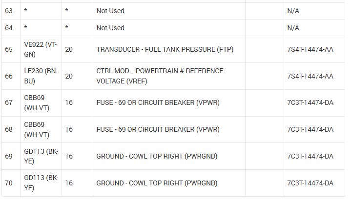

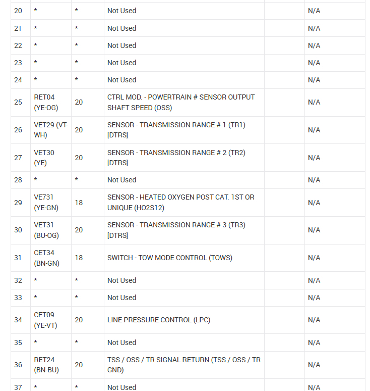

I’m having some issues with a cylinder misfire, all components have been replaced, spark plugs and coil pack and injector. I’m still having issues, and I need to know the pinout of the ECM wiring harness plug to test for any broken wires or bad connections.
