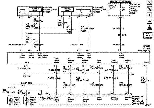

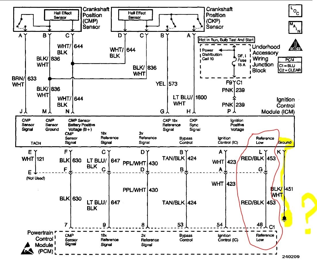

Pin 48 is a reference from the ignition module.
I attached a picture for you. It sounds like your new ECM is no good.

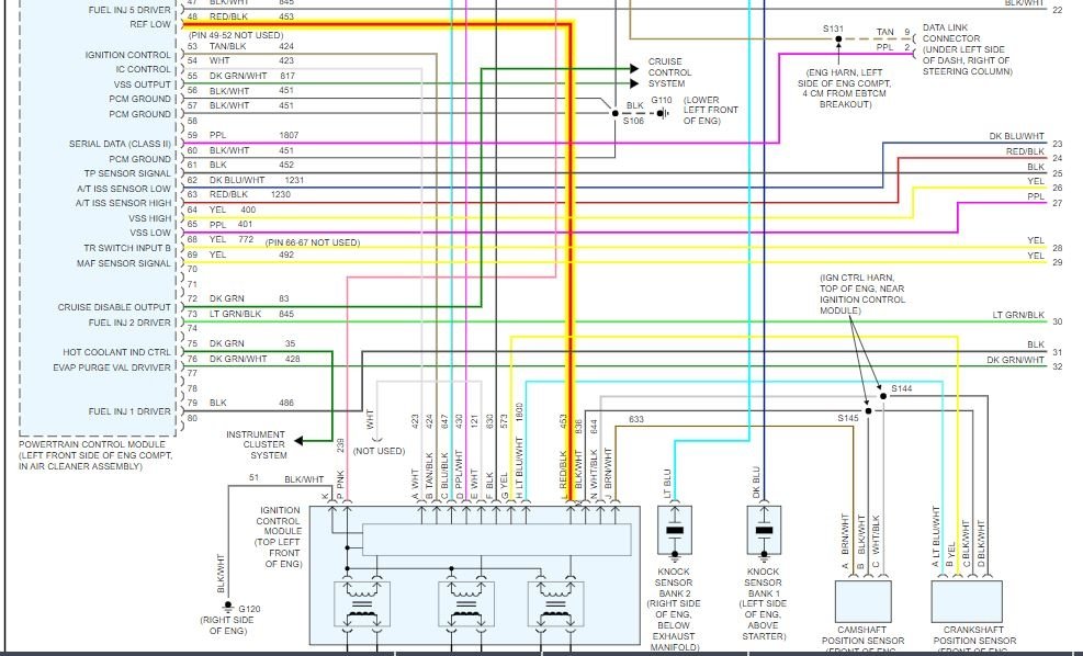

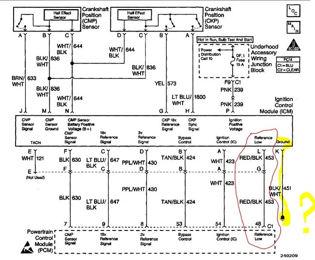

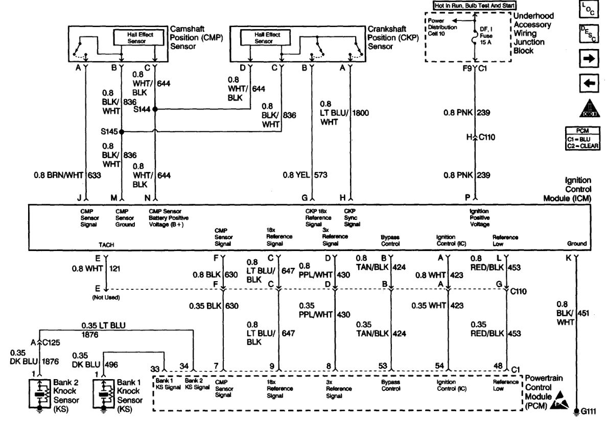

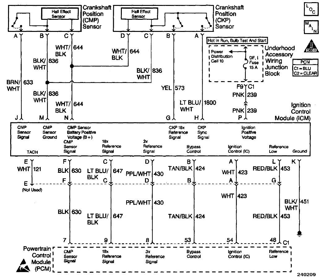

Pin 48 is the low reference (module to module ground) to the ignition module. I would grab a VOM and measure the pin on the ECM and then check the same wire at the ignition module. I suspect you will find there is voltage on the coil side. Check the ground for the coil packs and if you have the old one connect it up and check it for the same issue. Could be that the coil pack itself is defective. If pin 48 still shows a ground when you test it compared to other grounds the ECM should still be okay.

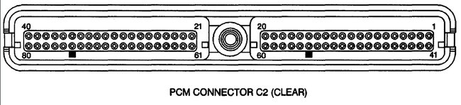

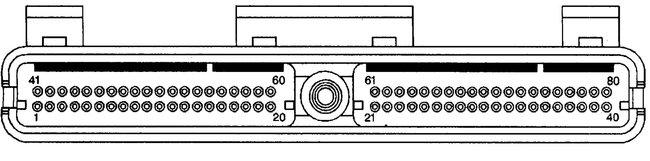

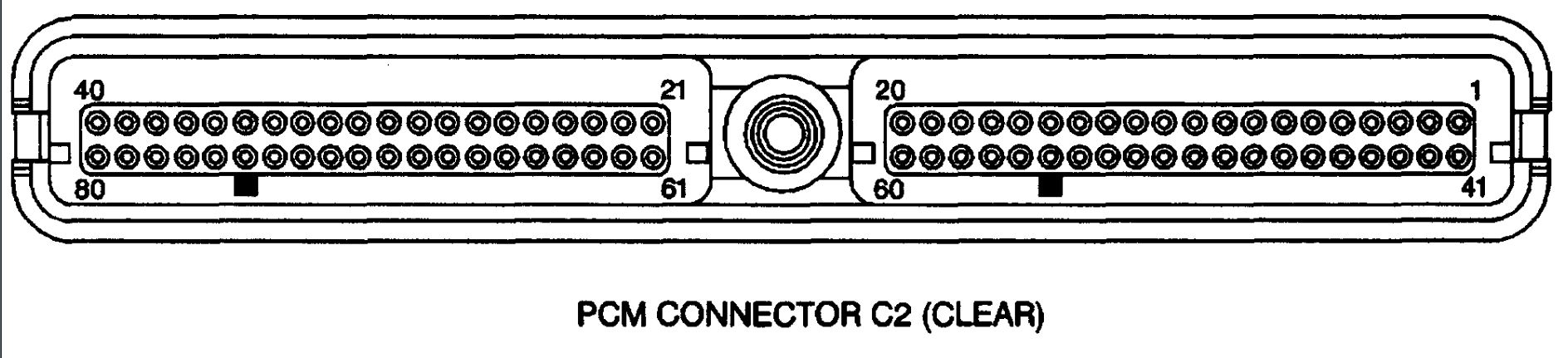

I found a pinout for a ECU but it is not clear if you are showing the ECU or the harness and which side of the harness that I am looking at. can you clear that up? thanks
Mar 11, 2021 at 3:36 PM (Merged)
STEVE W.
  • 15,113 POSTS

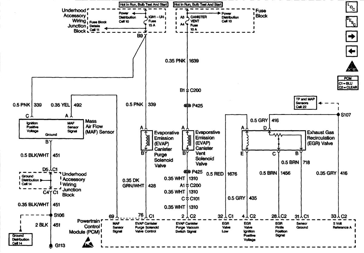

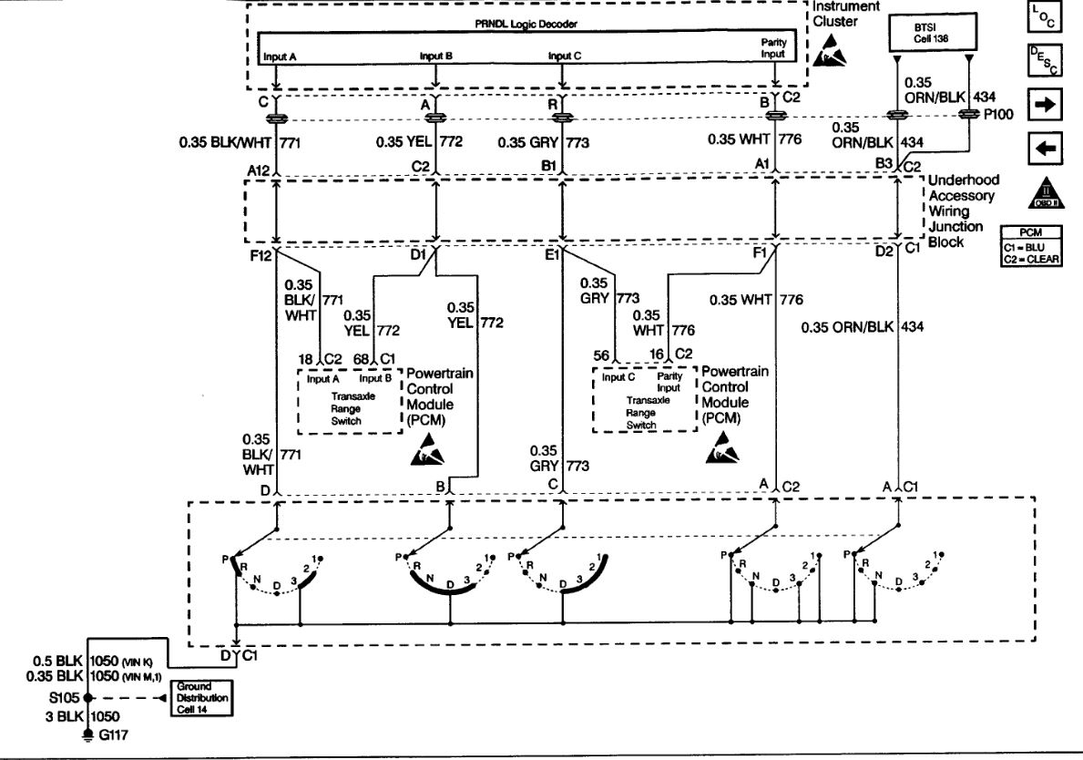

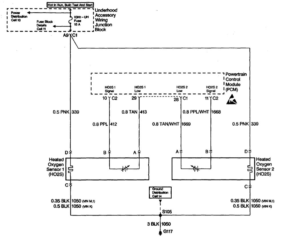

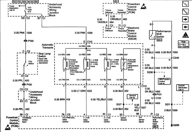

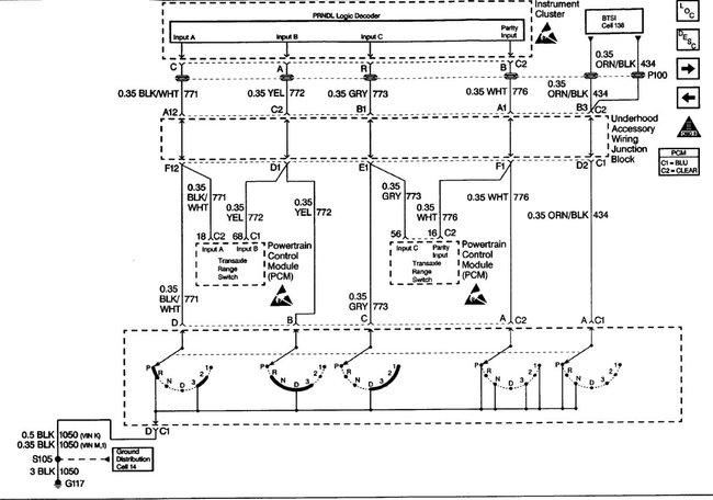

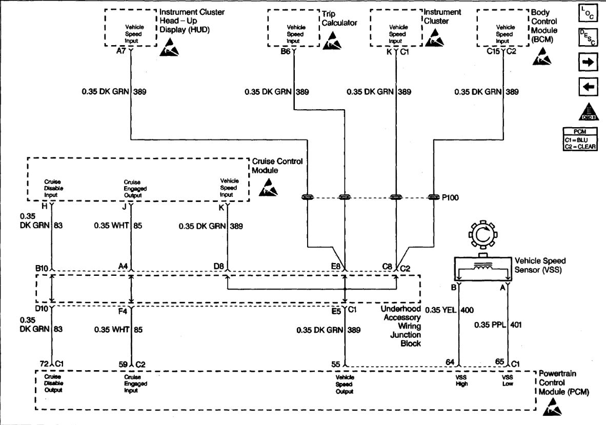

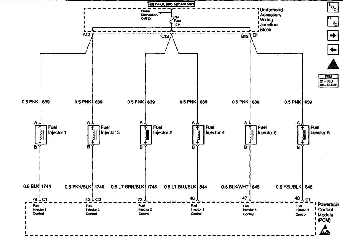

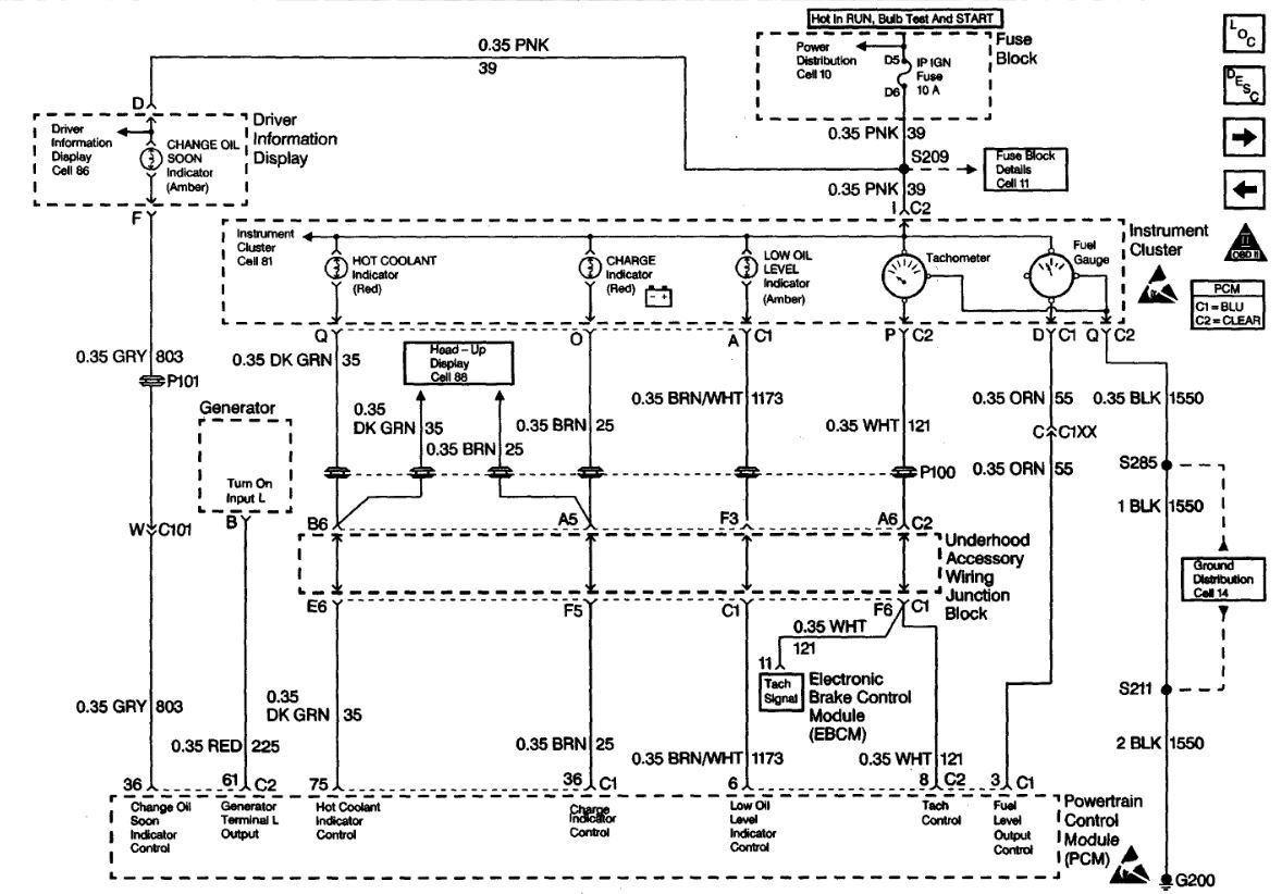

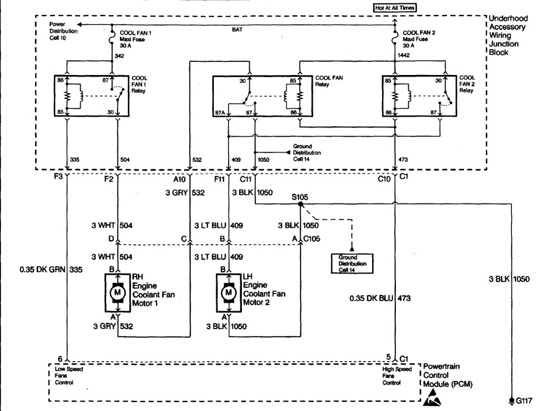

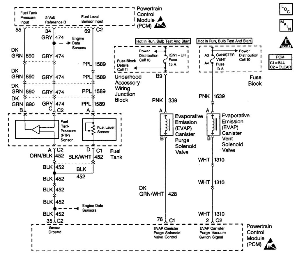

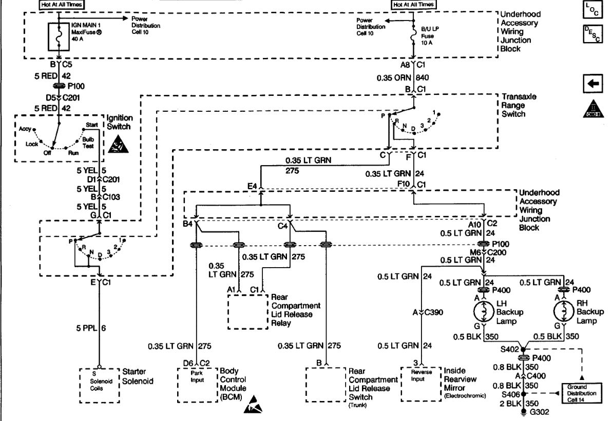

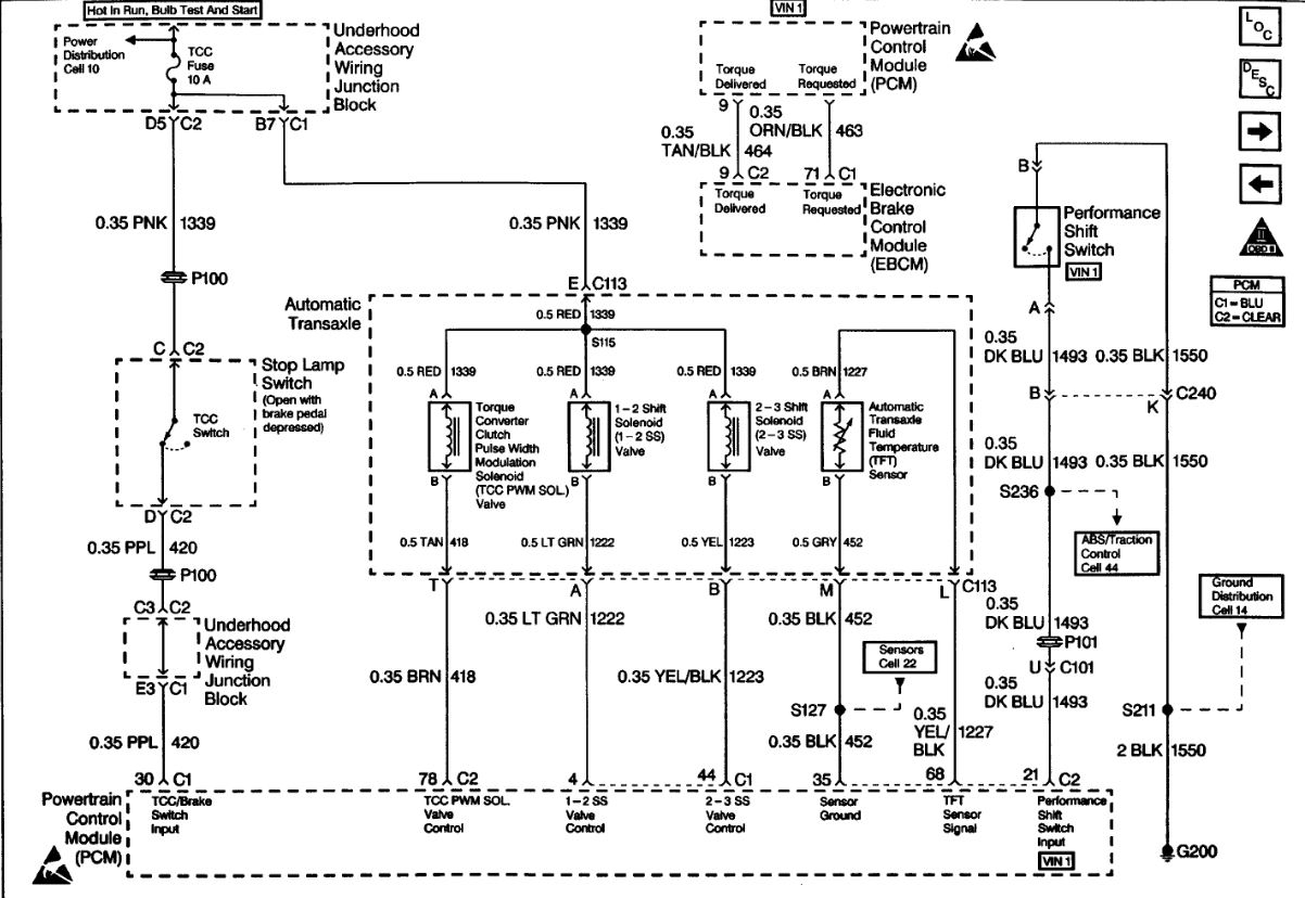

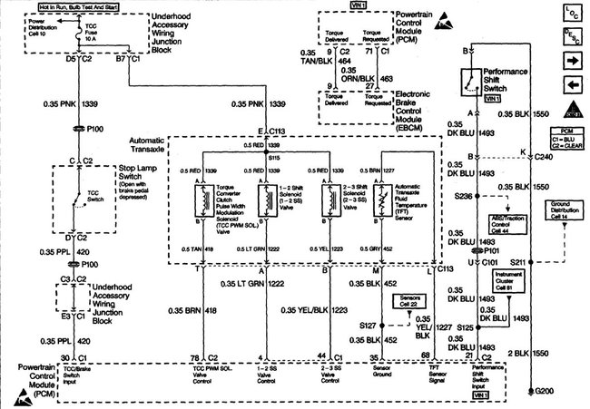

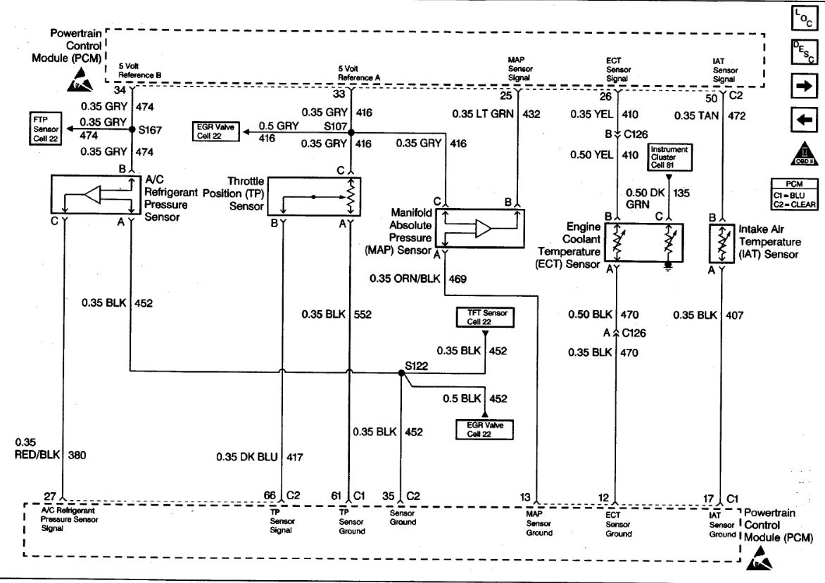

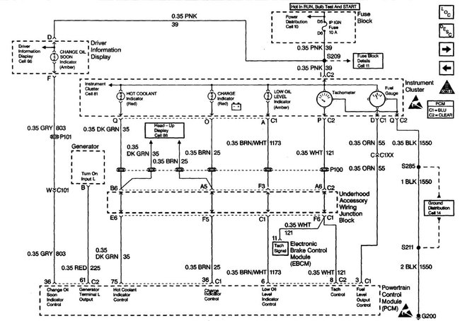

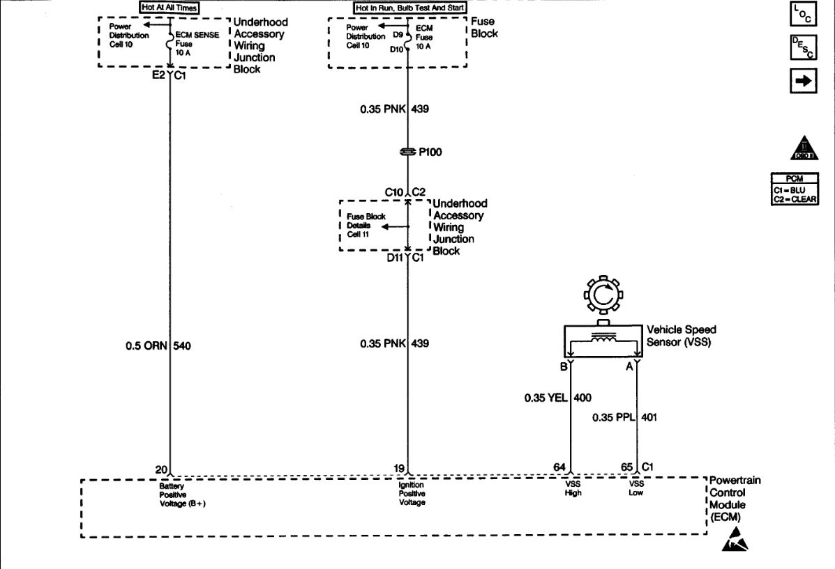

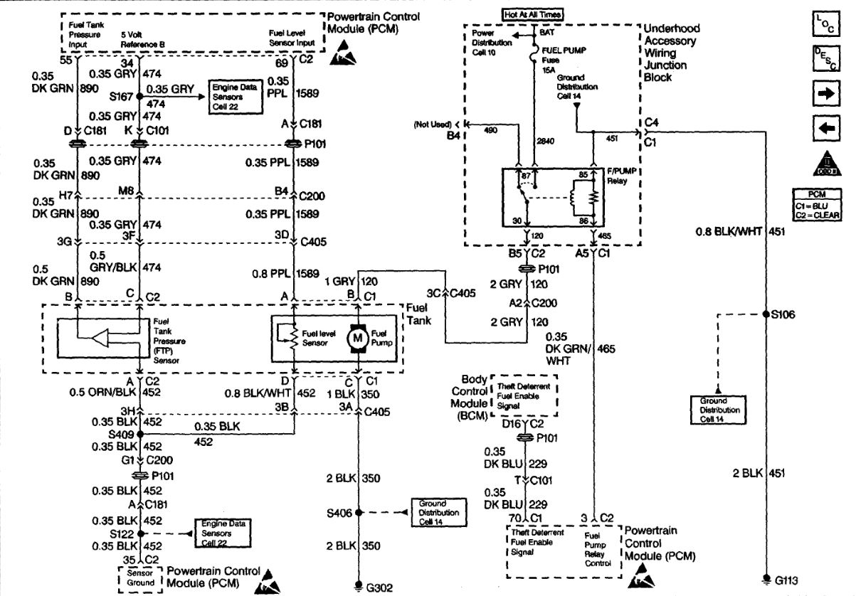

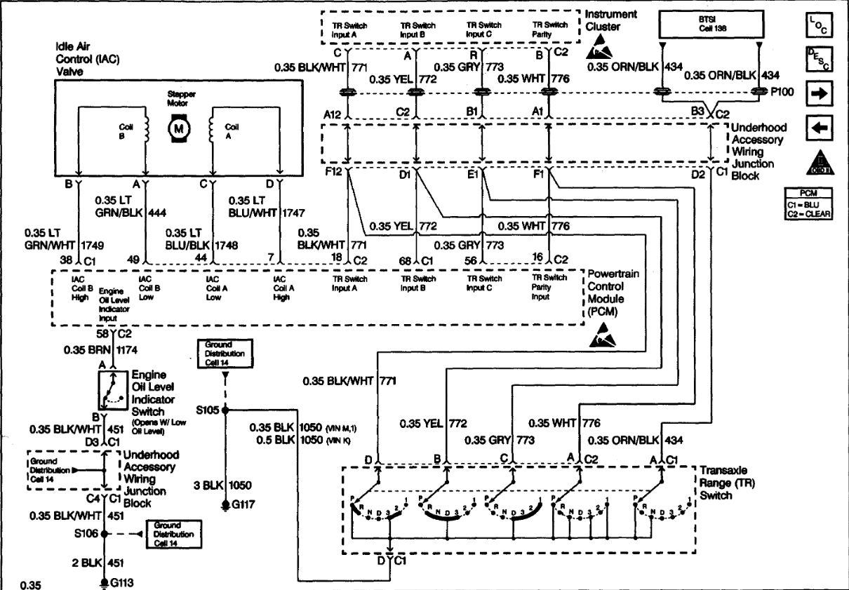

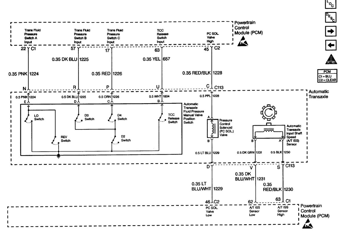

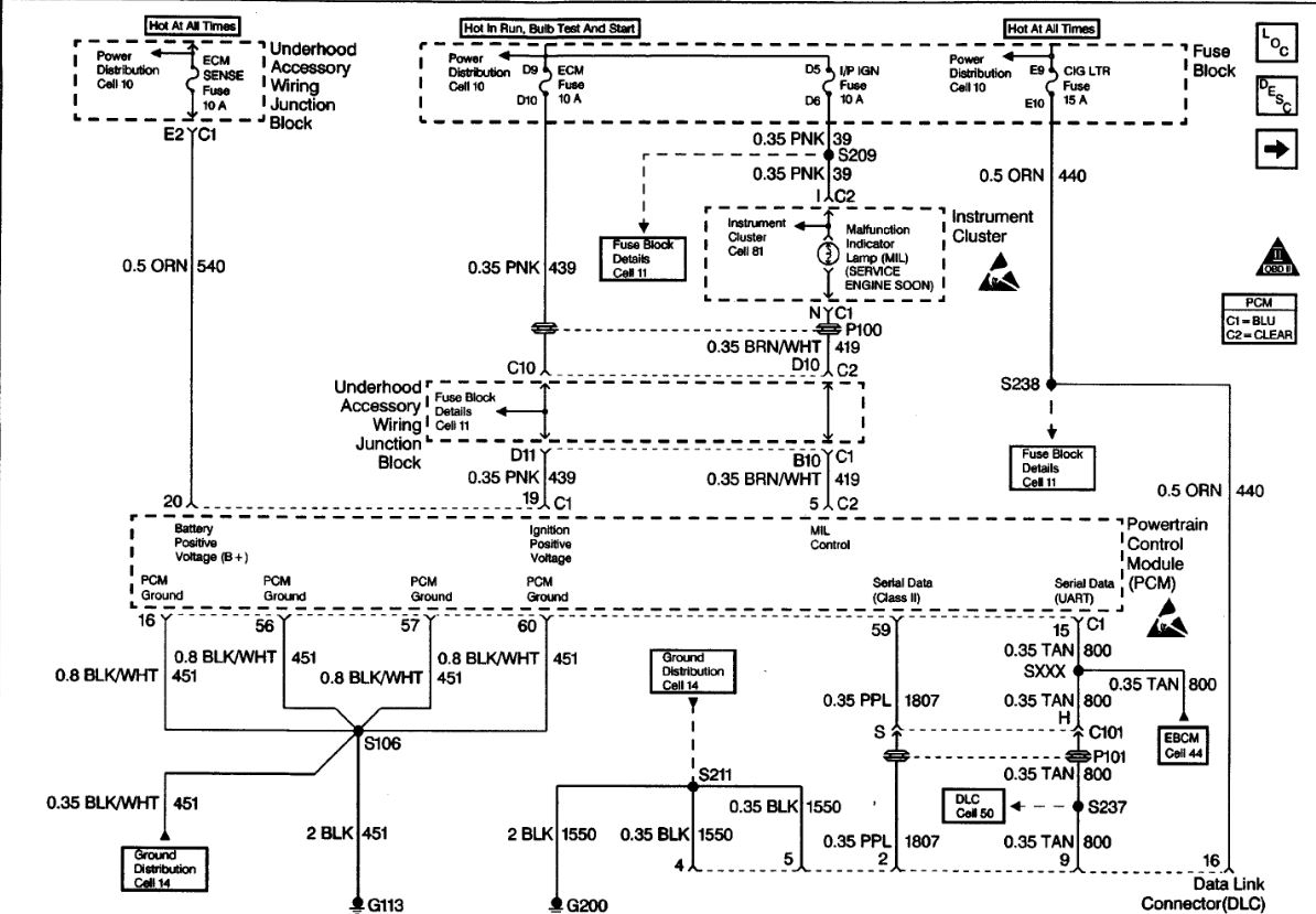

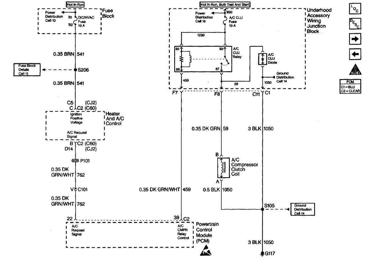

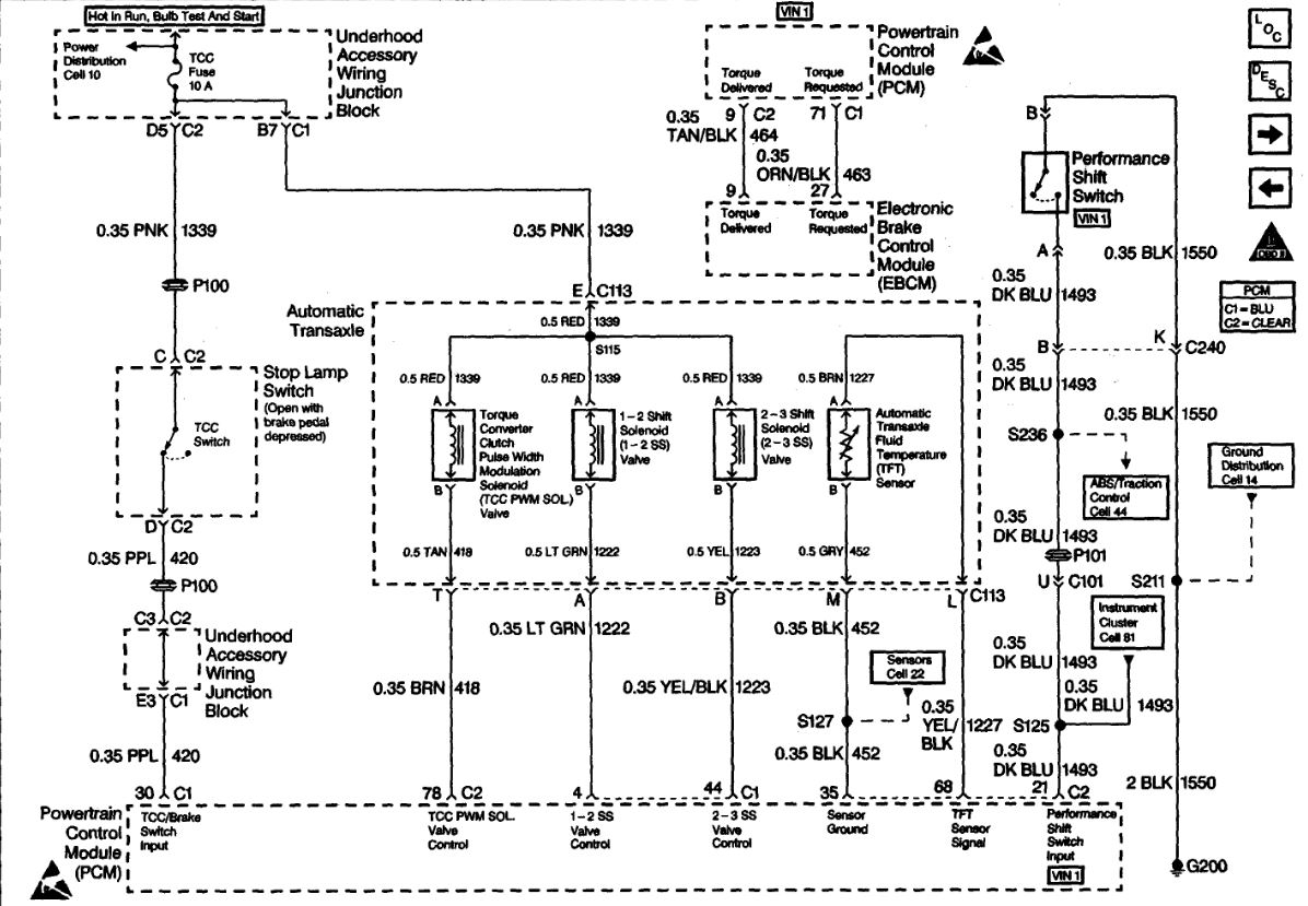

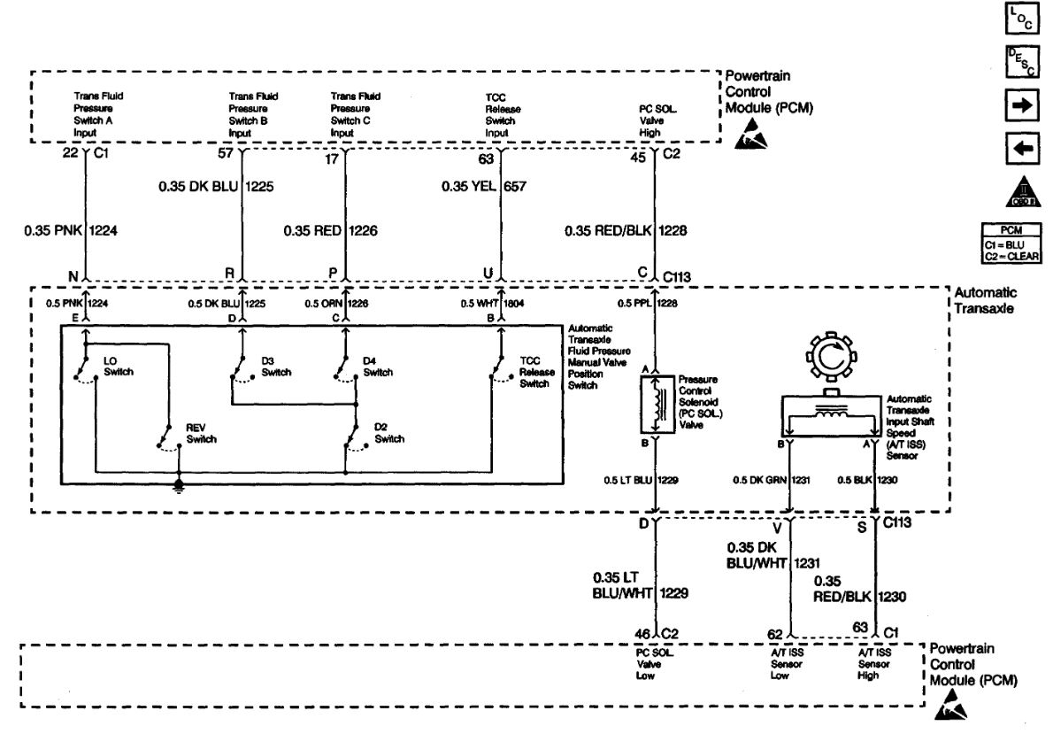

Perhaps these will help. They are the various wiring diagrams that connect to the PCM. The C1 connector is Blue while C2 is "Clear" aka dirty white normally. These are both looking at the face of the connector on the harness.
The others are the wires and what they control from the PCM.
