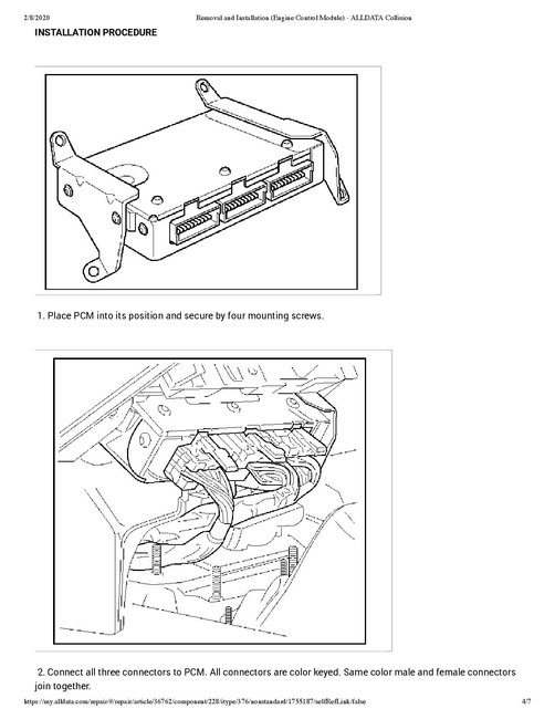

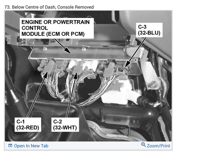

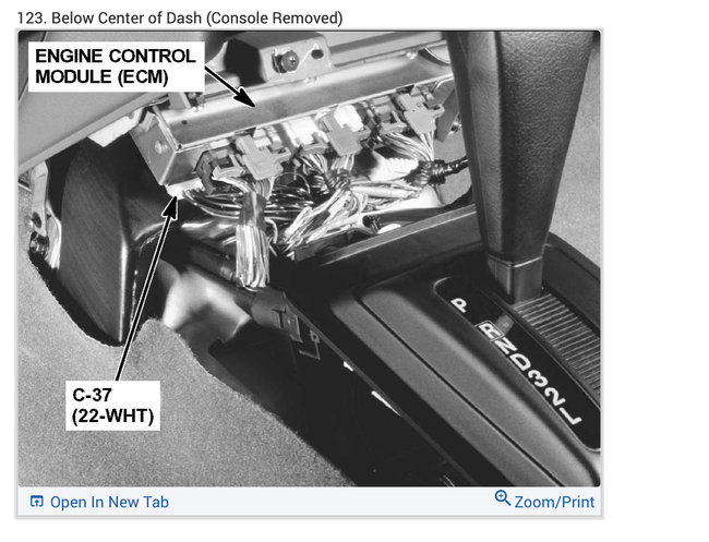

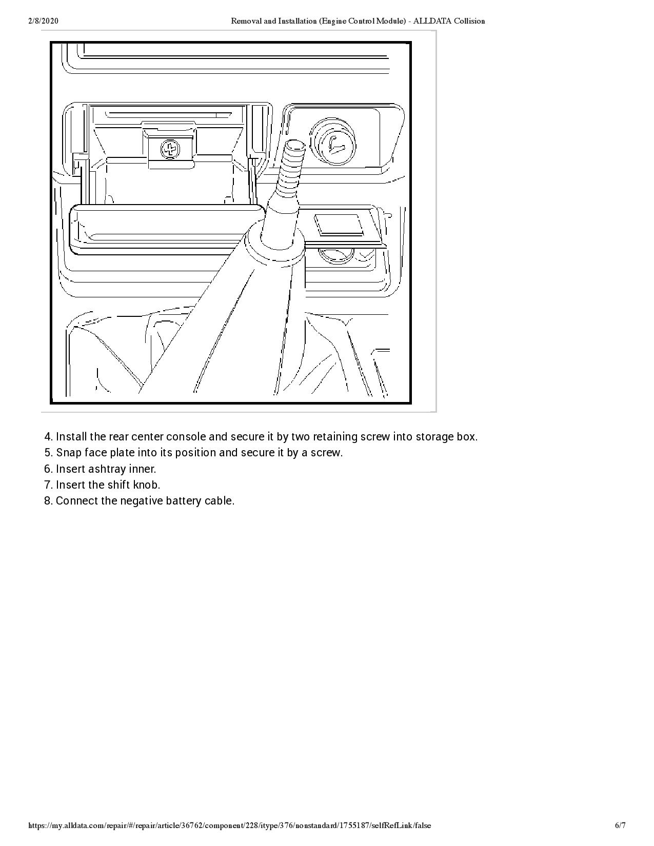

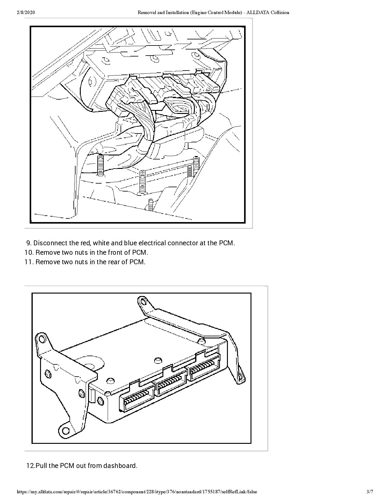

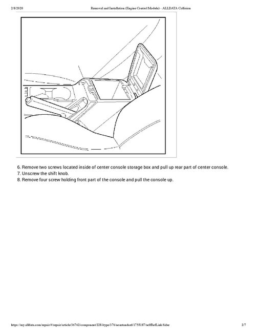

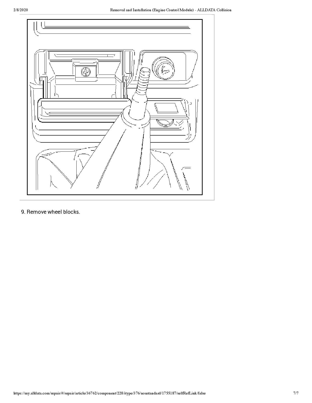

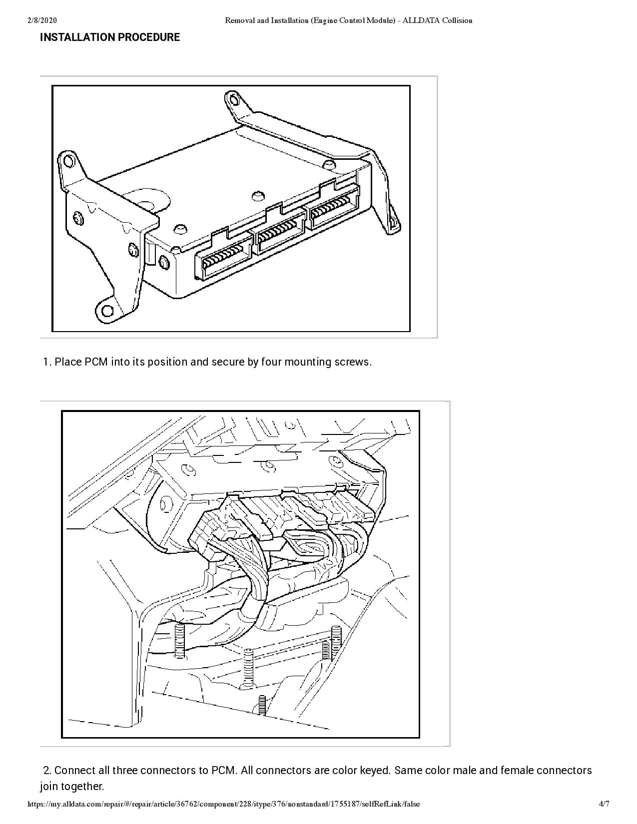

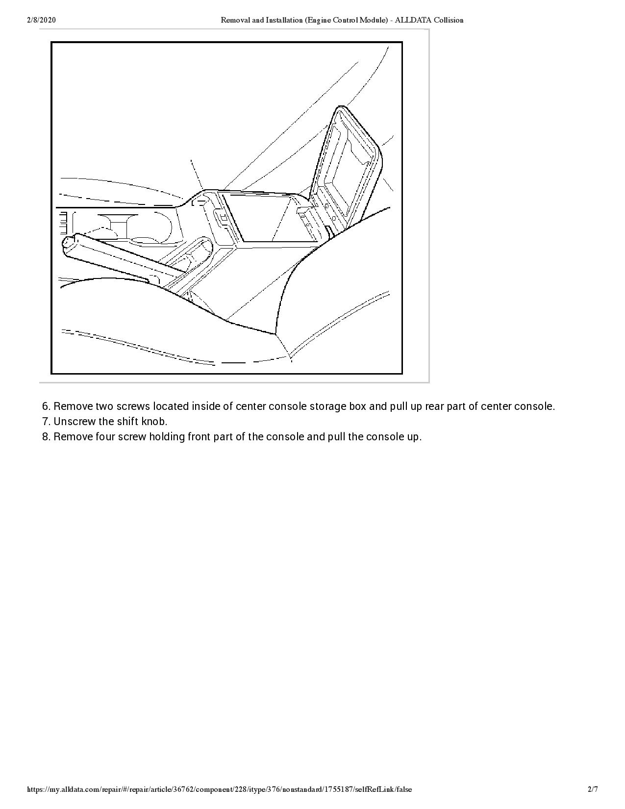

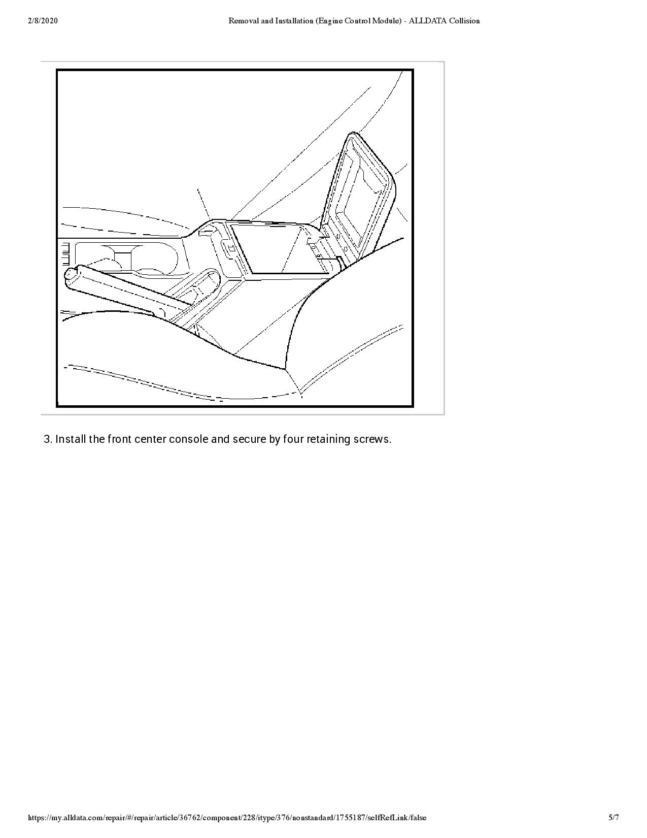

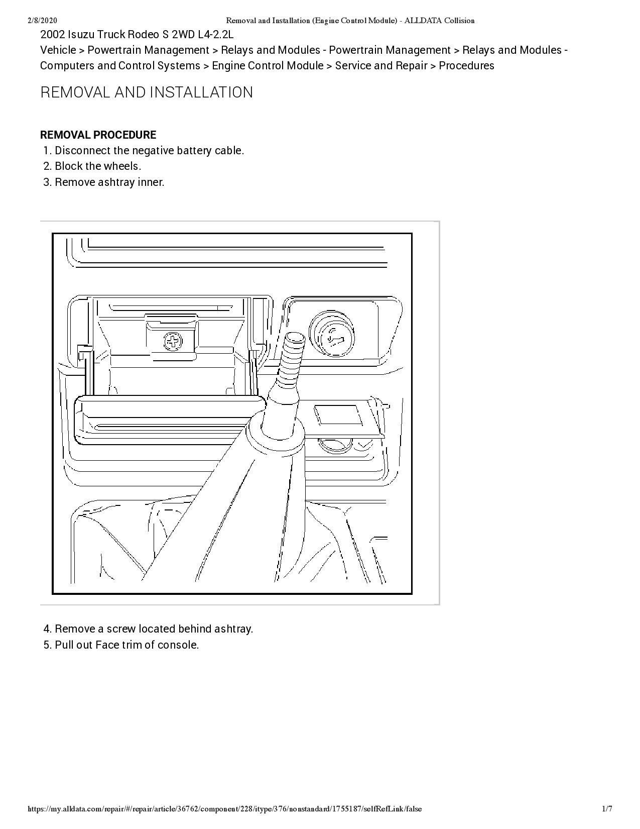

Hey BMT54,
It looks like your Engine Management Control Unit/powertrain control module (PCM) is behind the console in front of the shifter.
I have attached pictures below to show the location and instructions on how to remove and replace the PCM.
Hope that helps, let us know if you have any further questions.
Regards, Joe
