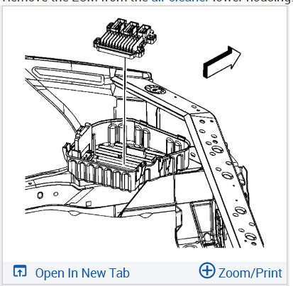

Here is the location of the ECM so you can swap it out if confirmed, you can get a preprogrammed unit by searching Google or Ebay.
Check out the images (below). Please upload pictures or videos in your response.
