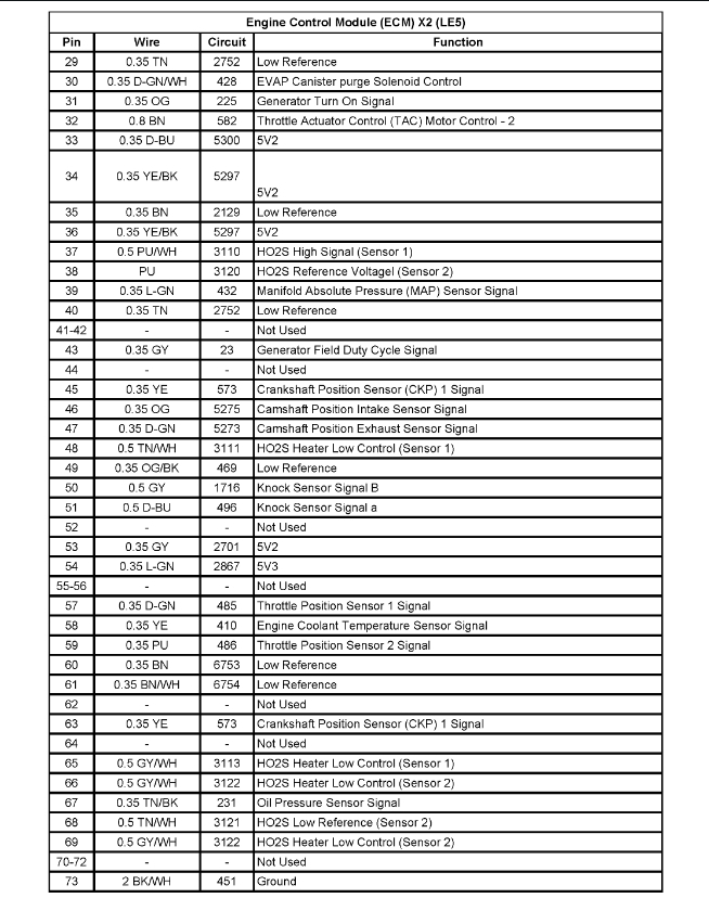

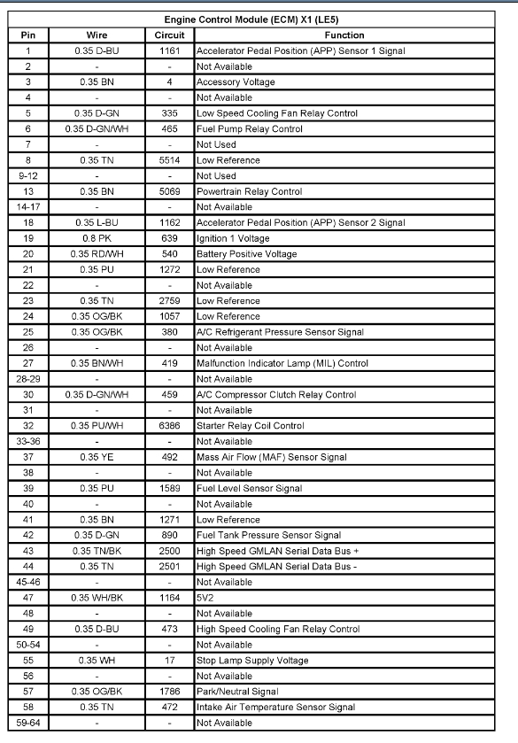

ECM connector, how do I find out exactly what each wire going to connector is for and color?
2008 PONTIAC G6
140,000 MILES • 2.4L • 2WD • AUTOMATIC
SHAWNAWAYNE
  • 8 POSTS

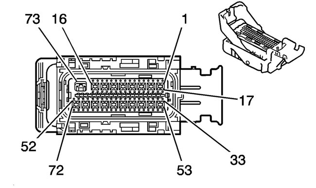

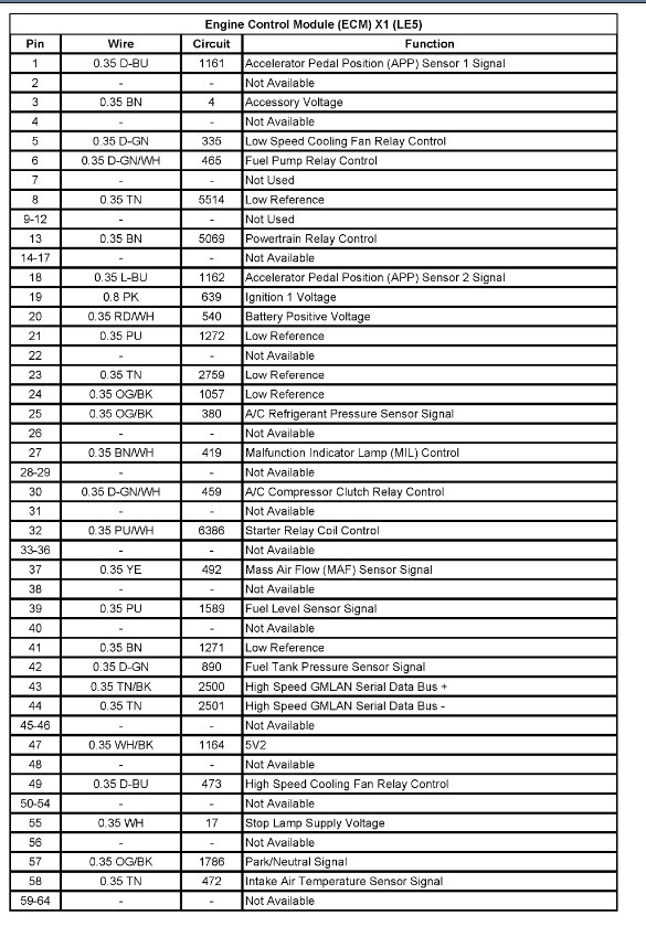

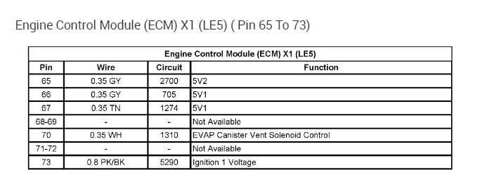

2 pins on my ECM are bad. how do I find out exactly what each wire going to connector is for and color. We bought a new connector and replacing pins as well as ECM, but we want to make sure to wires that were burned at the pins have no shorts before connecting ECM and having it happen again, I cannot find any diagram anywhere for pins.
May 30, 2023 at 8:04 AM

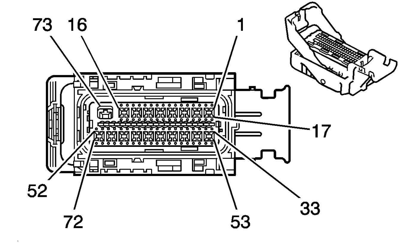

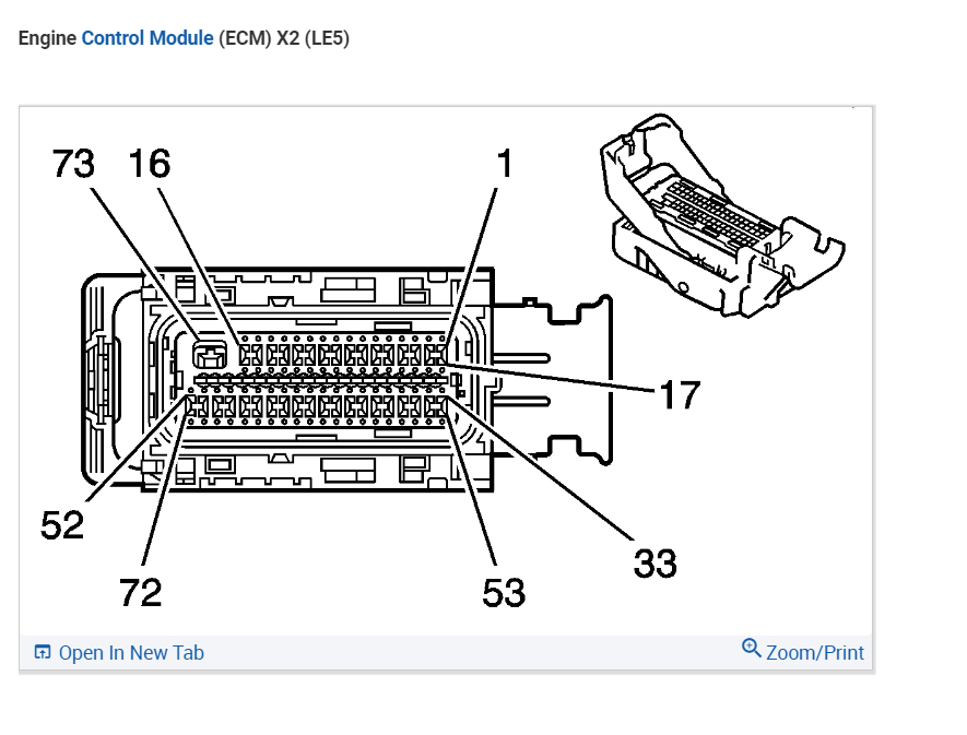

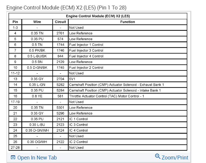

Sure, here are the PCM pinouts for the color and operation of the wiring to the PCM controls. Check out the images (below). Please let us know if you need anything else to get the problem fixed.
