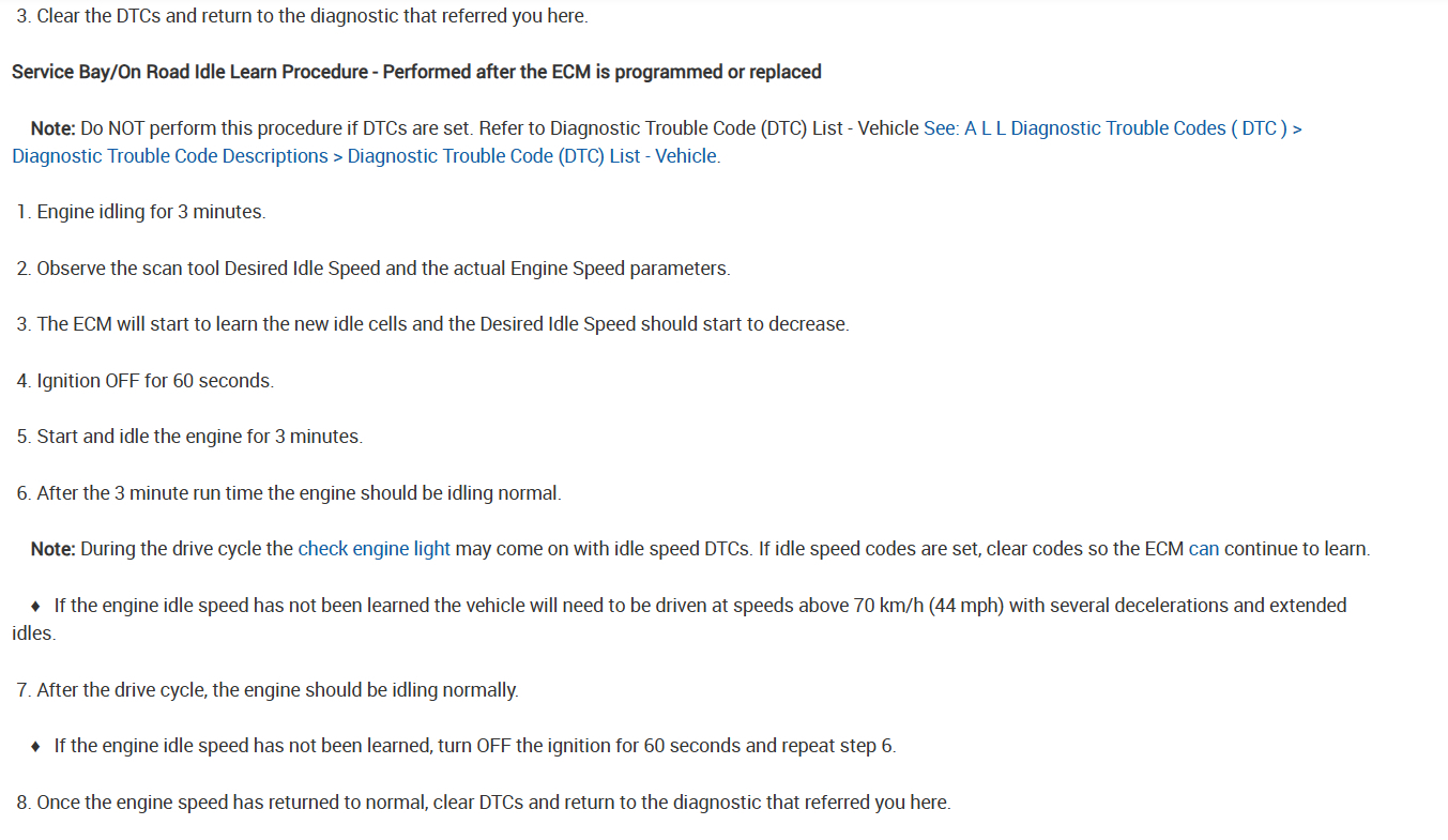

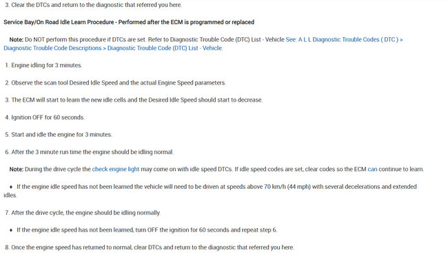

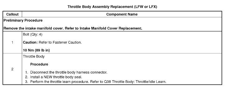

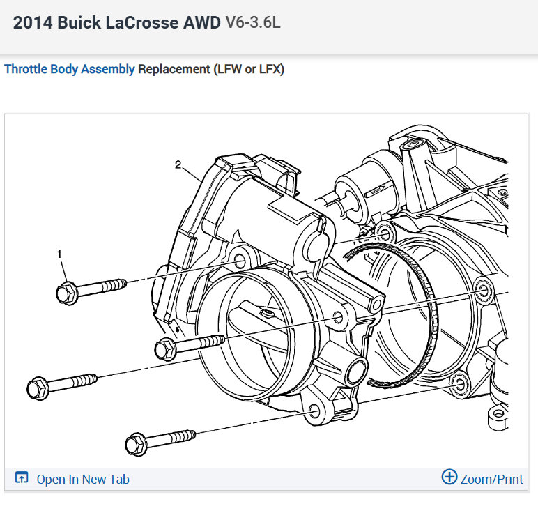

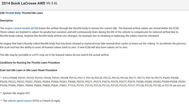

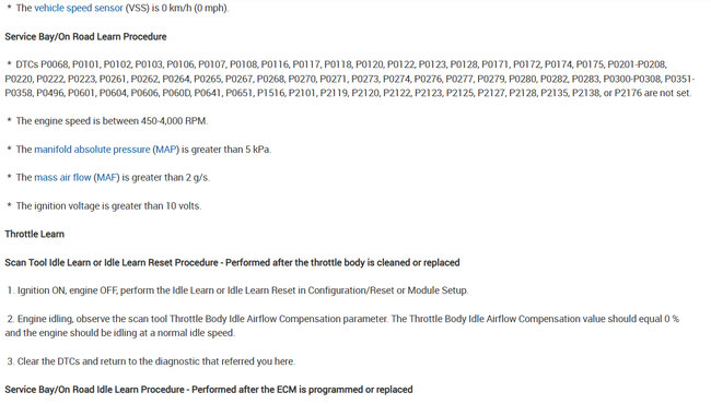

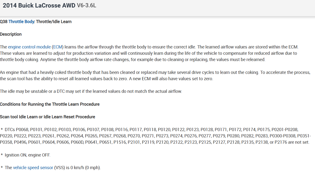

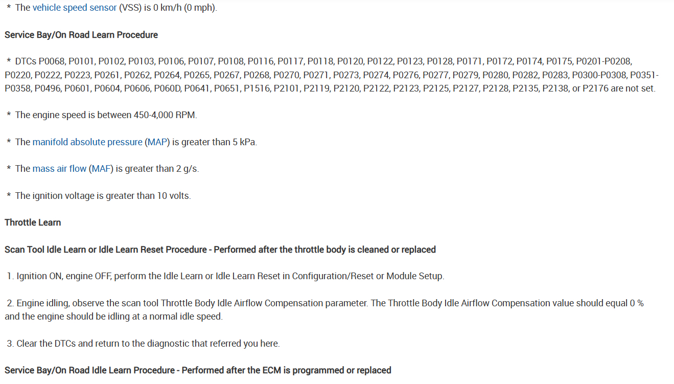

Here is the correct way to replace the throttle body. Clear the codes once completed. Check out the images (below). Please let us know what happens.
