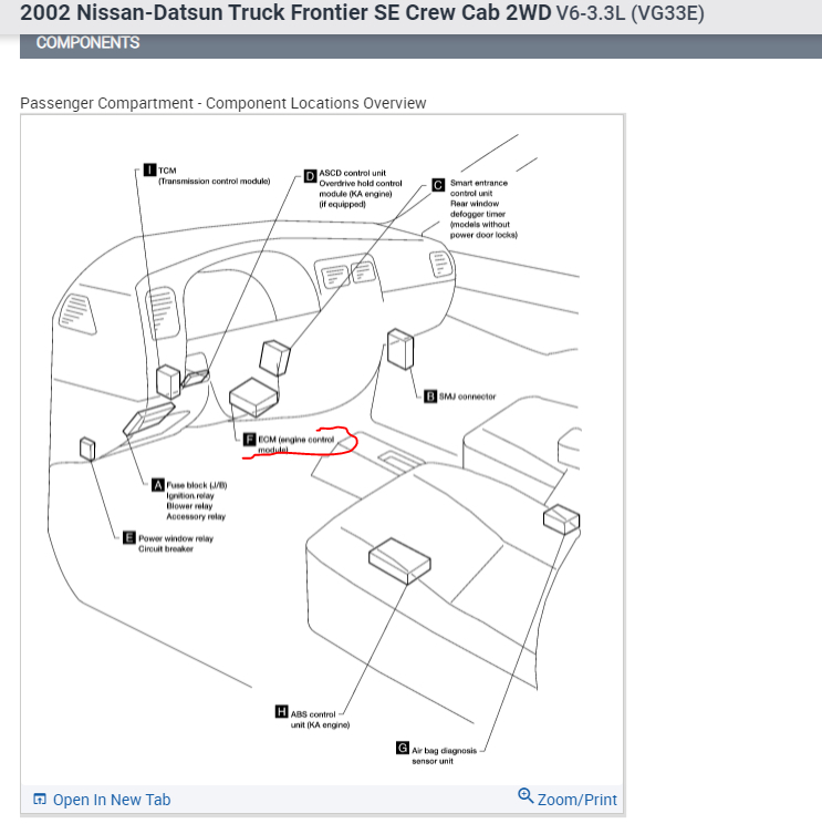

The ECM is located under the dash, just right of the gas pedal.
