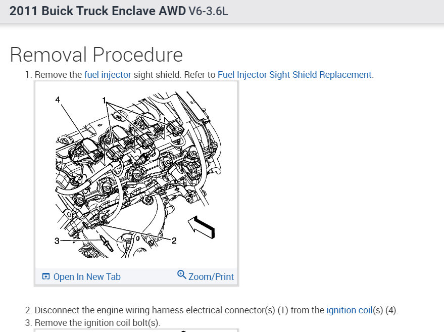

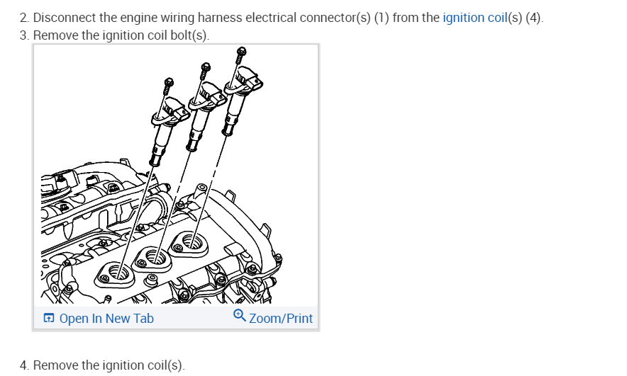

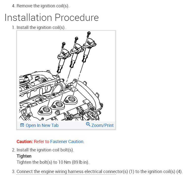

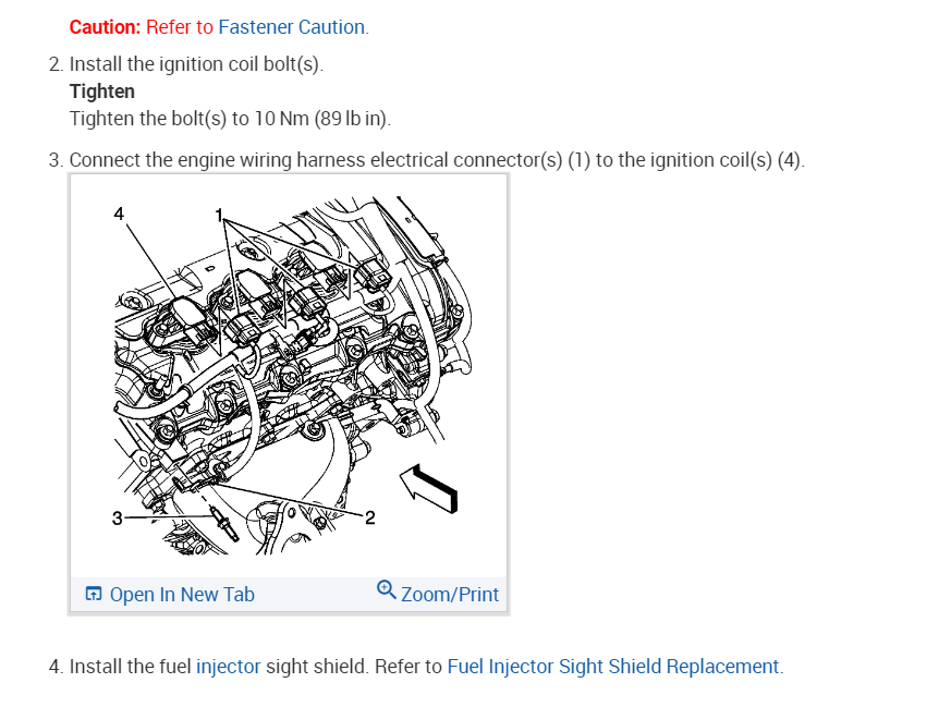

This is common when an ignition coil, fuel injector or oxygen sensor has shorted out, I would unplug them all and replace the fuse, then with the key on, plug them in one at a time until the fuse blows. This will be the bad part that needs to be replaced. I would inspect the engine wiring harness to make sure it has not rubbed through. Let us know what happens and please upload pictures or videos of the problem so we can see what's going on.
