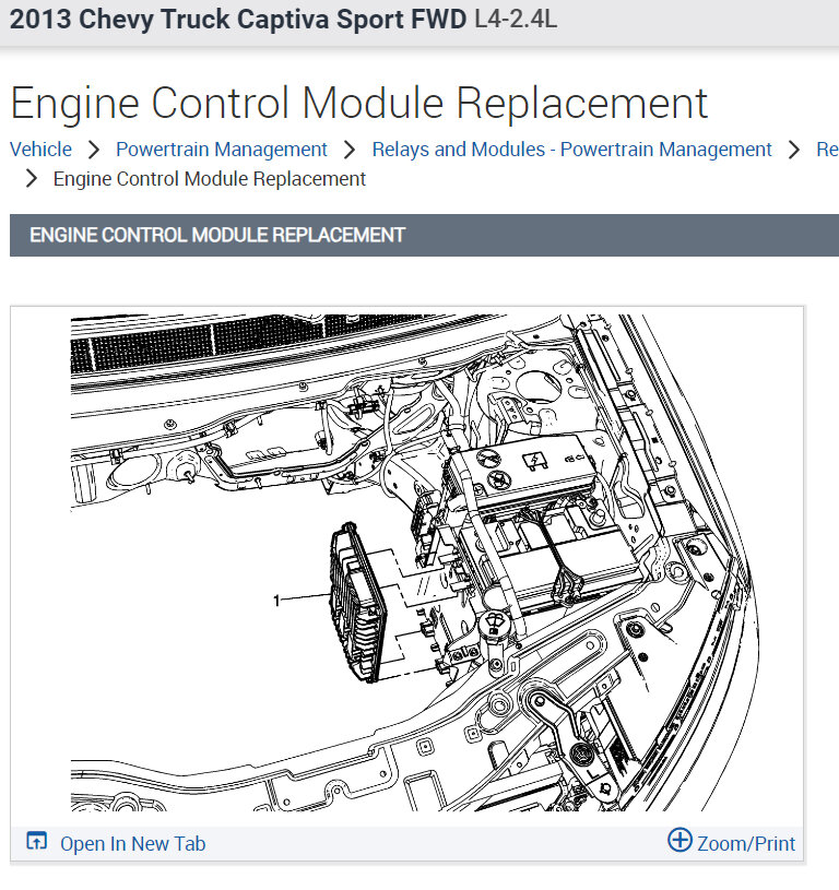

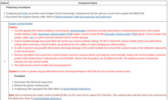

Yep, it is defective they not supposed to rattle, here is how to install the PCM in case you need it. Check out the images (below). Let us know if you need anything else.
