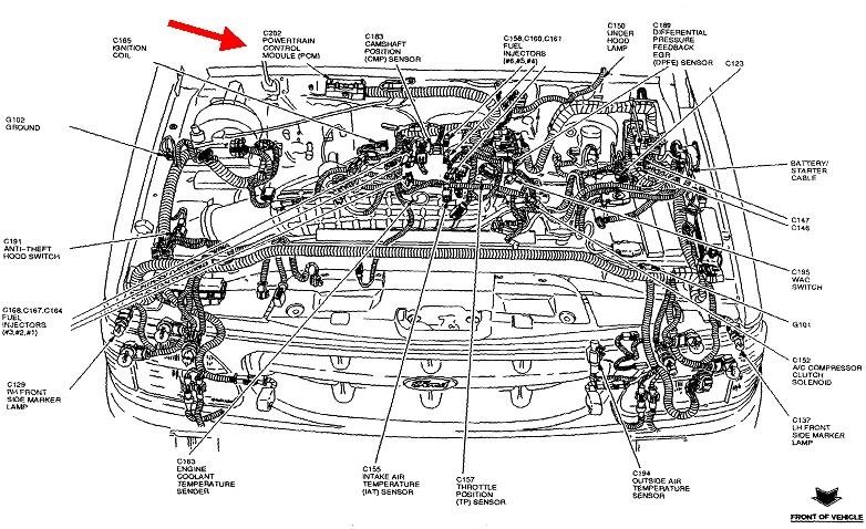

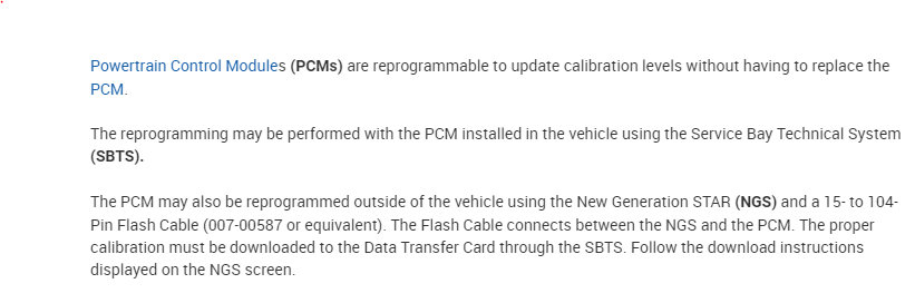

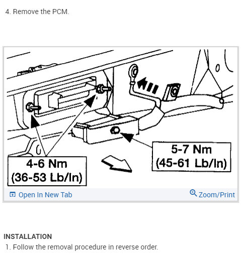

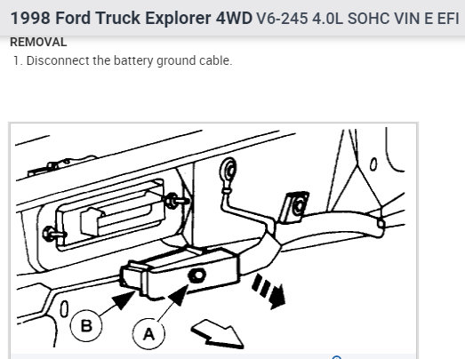

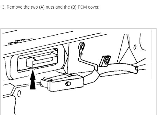

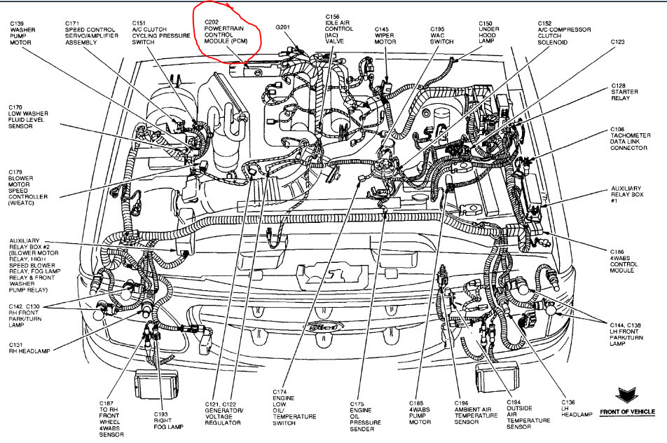

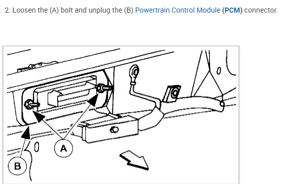

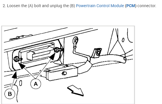

The pcm (powertrain control module) controls all the computer components and drivetrain components on your vehicle. It's not very hard to replace.The pcm is located on the right side of the firewall under the hood.If you purchase a new or used pcm it will have to be programmed to your particular vehicle.They usually run $250-1000 dollars depend if purchasing new or used plus programming. I've attached pictures below showing its location and how to remove/replace.Hope this helps and thanks for using 2CarPros.
