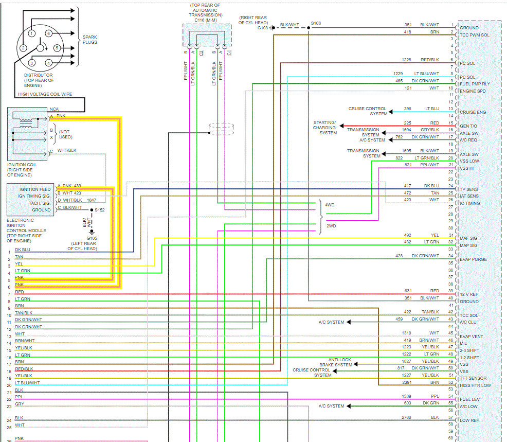

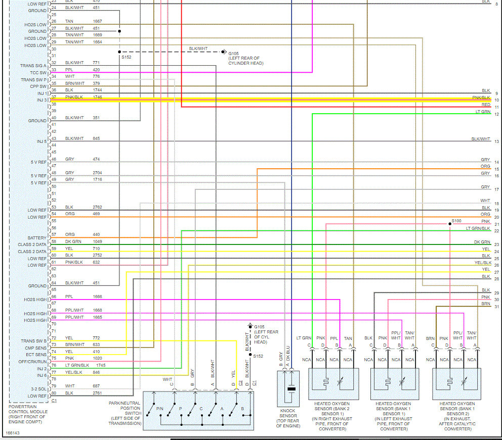

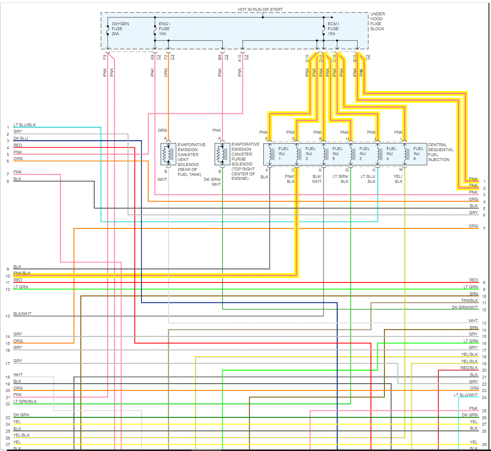

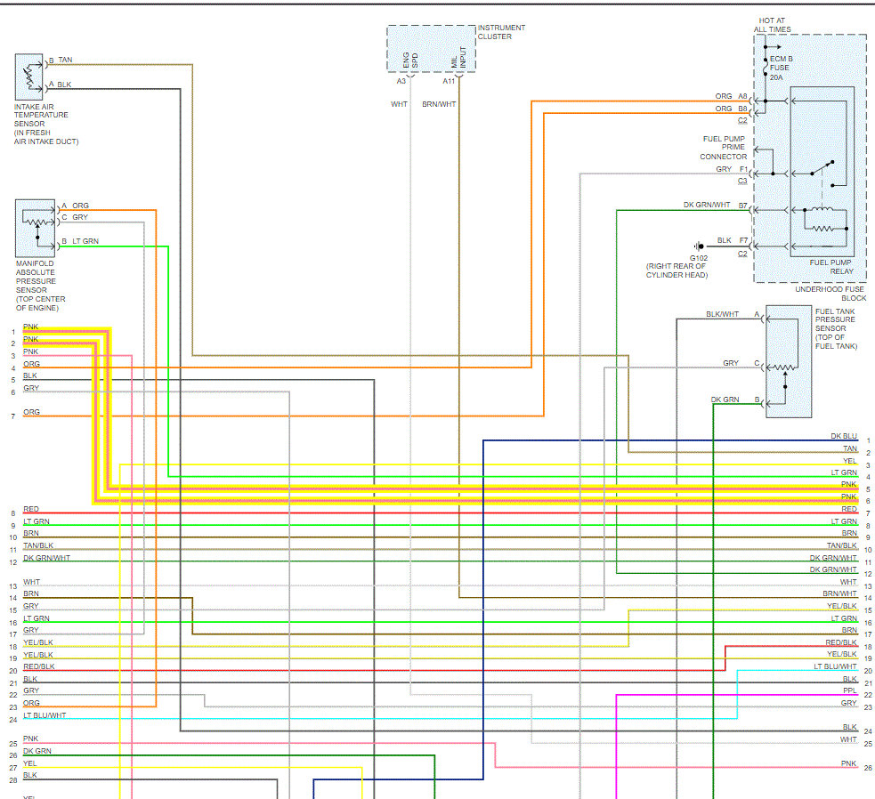

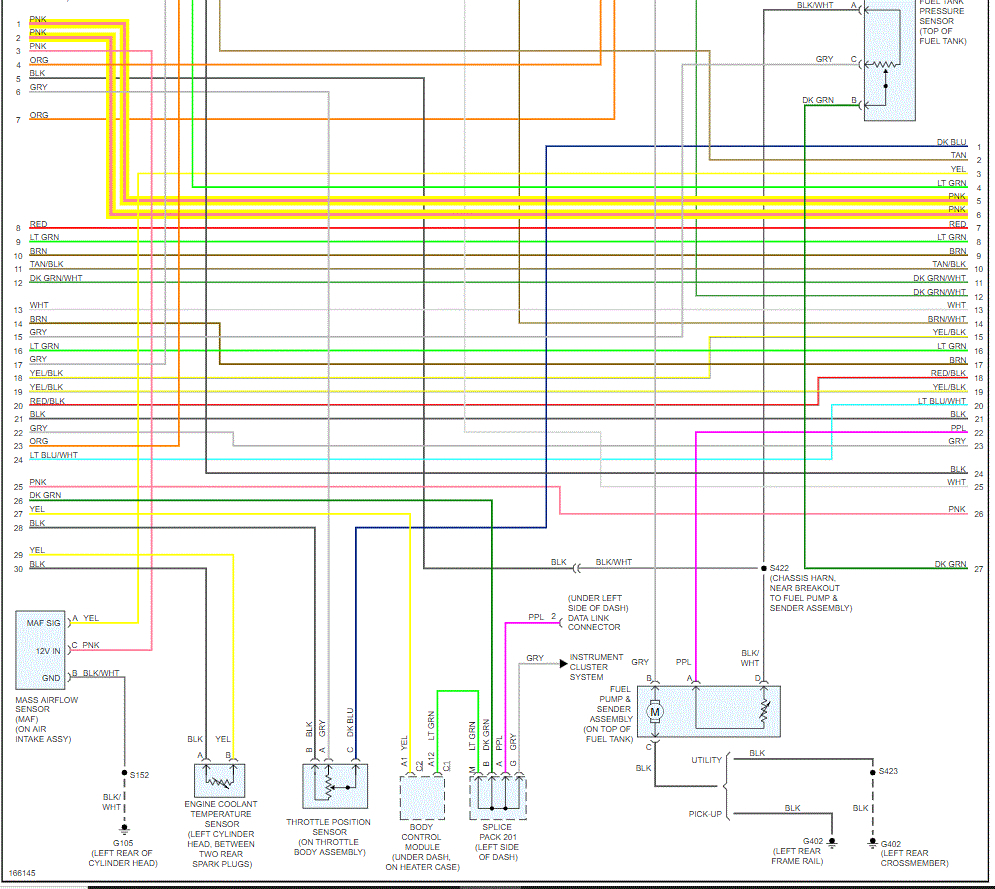

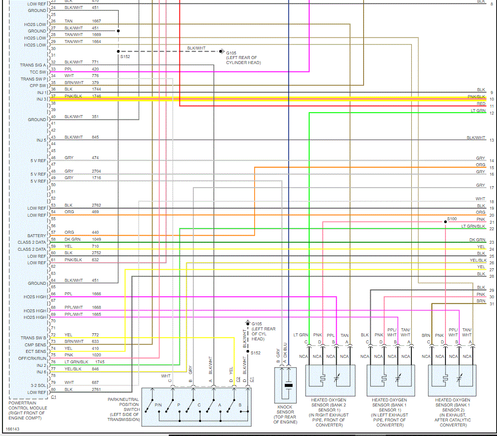

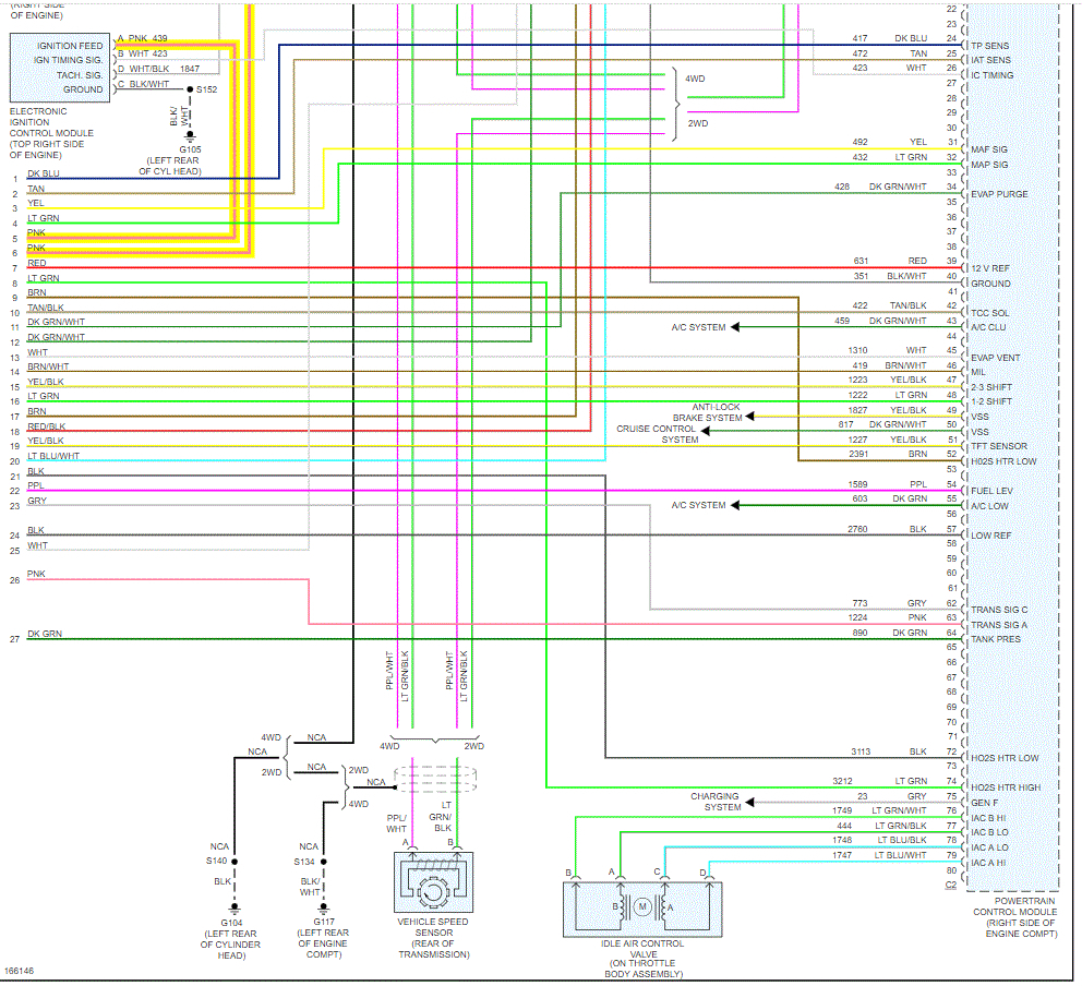

Sorry for the novel, lol. I bought the vehicle listed above LS has almost 175,000 miles at the beginning of this year. Few weeks ago, had a p0200 and p0303 code and flashing SES light so replaced #3 spark plug and wire and replaced full spider injector with a remanufactured one from AutoZone along with the necessary manifold gaskets and the distributor cap. Codes cleared and she drove great. Few days ago, check engine light flashing again went to AutoZone around the block they ran codes got P0200, P0306, P0128, P0102. Driving home stalled out so started checking basic stuff found a blown 15a ECM 1 fuse. Replaced with another one cranked engine and blew another. Did that couple other times keeps blowing ECM 1 fuse. Unplugged spider fuel injector connector at the intake manifold and cranked the engine and it doesn’t blow the fuse. From my understanding this year of the blazer only the injectors, their connection components, and the senders or what not from the ECM are on this fuse and circuit with nothing else like the fuel pump or fuel relay tied into it. I read to test for 12v on the pins at the fuel injector connector and injectors or to look for open grounds or faulted injectors but wasn’t sure how to test injectors if negative terminal is disconnected before removing everything to access the injectors under the intake manifold. Wouldn’t that not do anything with no power to the vehicle? Also noticed no gas comes out of the little bleed valve on the gas lines. Not a mechanic by far but can’t afford parts and labor right now and can’t afford to keep replacing things that are most likely wrong. I can only buy basic testing tools, but I have tools to fix stuff or can get loaners and I’m pretty capable of repairing things so I’m trying to see if someone can please point me in the right direction on what to replace because I can’t pay bills when I can’t get to work. Is it possible it’s the remanufactured spider I just installed or can I rule that out cause supposedly it’s up to spec for reusing? Apologies for a question as long as the Nile but I’m just trying to put as much details in there that I can think of to help make answering easier.
