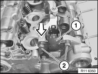

Here is what I have for removal and replacement. The attached pic correlates with the directions.

See pic 1
All screws are secured against falling out, loosen the screws (2) only on the cylinder head but do not unscrew.
Screws (2) can fall out.
Risk of damage to timing chain drive.
Unfasten screws (2).

Remove the sensor (1) upwards.
