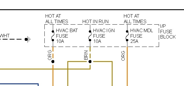

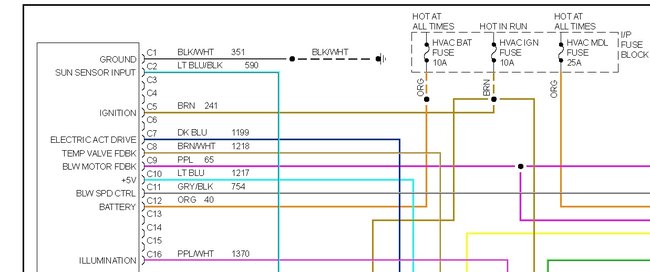

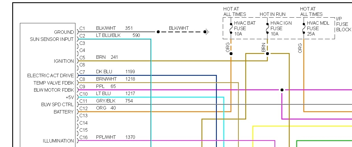

Use a testlite on the fuse circuits in diagram. Even if fuses are good, if no voltage the circuit is still dead. Two of the fuse circuits are hot all the time, one goes hot with the key on.
Apr 17, 2013 at 2:07 PM
CERRY
  • 5 POSTS
All three tested good (as described) with the test light.
Apr 17, 2013 at 2:54 PM
JDL
  • 16,098 POSTS
Other than check voltage and ground at the hvac control, I don't know where to go from here? You can check voltage at the hvac connector, brown wire and orange wire. Check the ground also.
