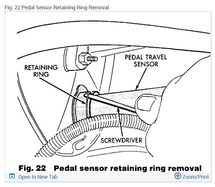

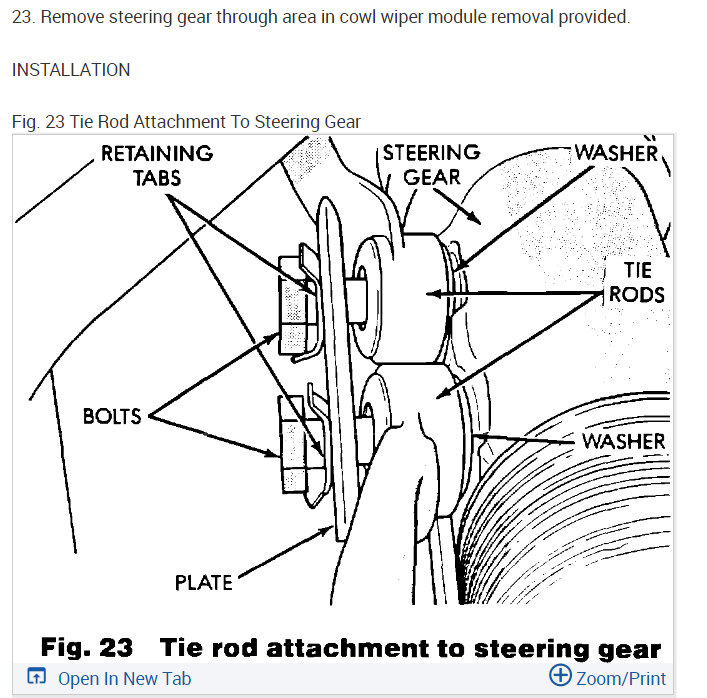

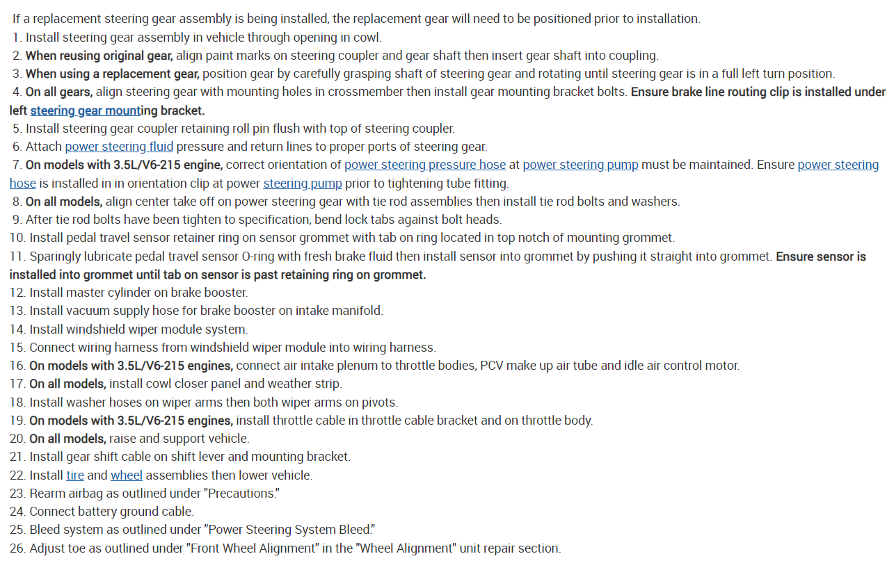

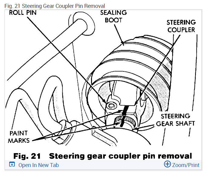

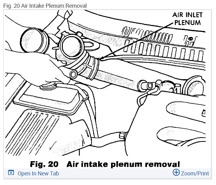

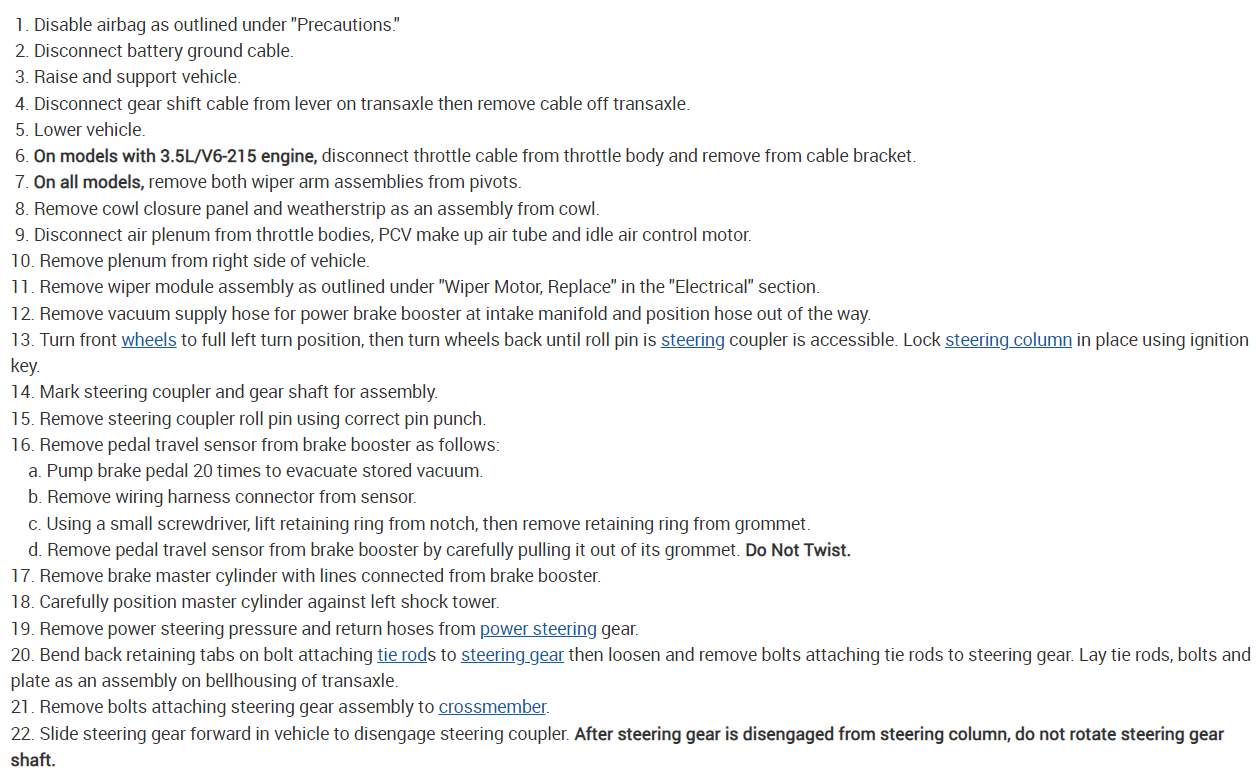

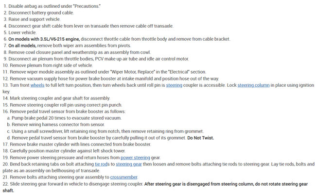

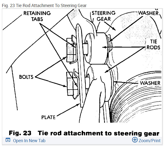

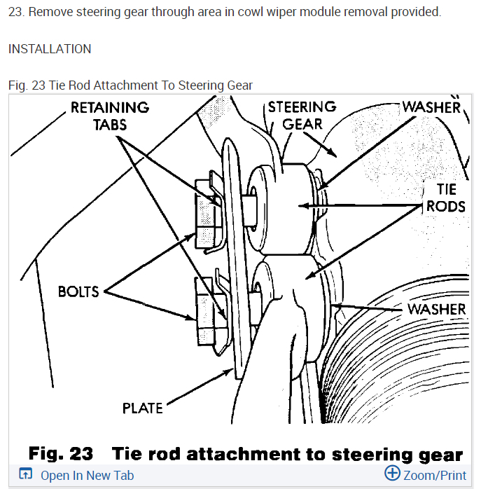

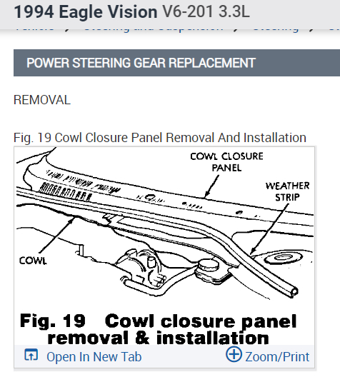

Your symptoms suggest that your power steering rack is faulty. Here is how to change the steering rack out so you can fix the problem. Check out the images (below). Let us know if you need anything else.
