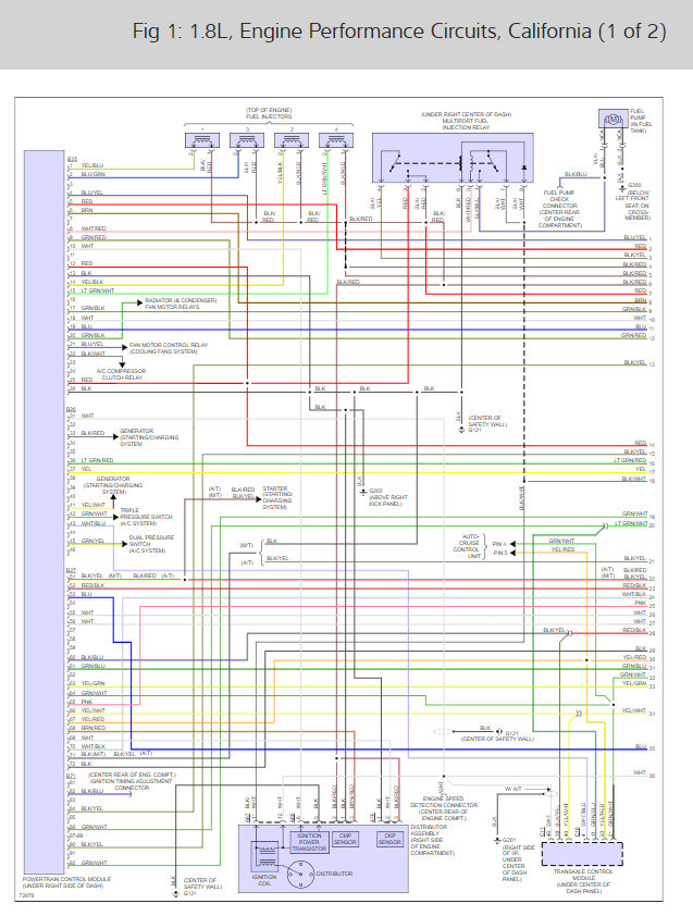

I have a 95 eagle summit that will turn over and not start. We have checked for spark and it has good spark. The fuel pump does seem to work and we disconnected the fuel line from the rail and turned the key and fuel came out. We do not have a way to check the pressure out. no adapter to put in line and no regular pressure check nozzle available. We used a light style tester to see if power was going to the injectors and it did not light up.. But we did not use a tester so I am not sure if there is enough power to light up the test light. but if the injectors are not getting any power going to them what might be the problem then? Please help!

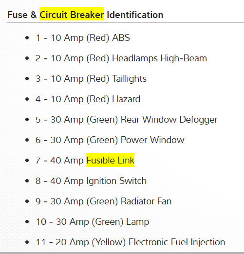

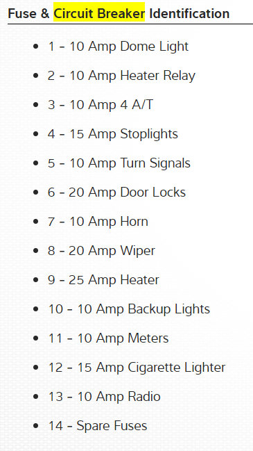

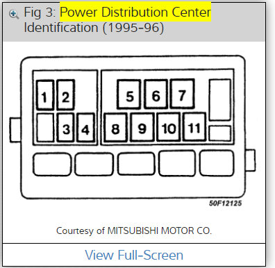

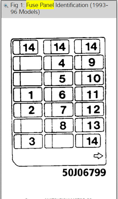

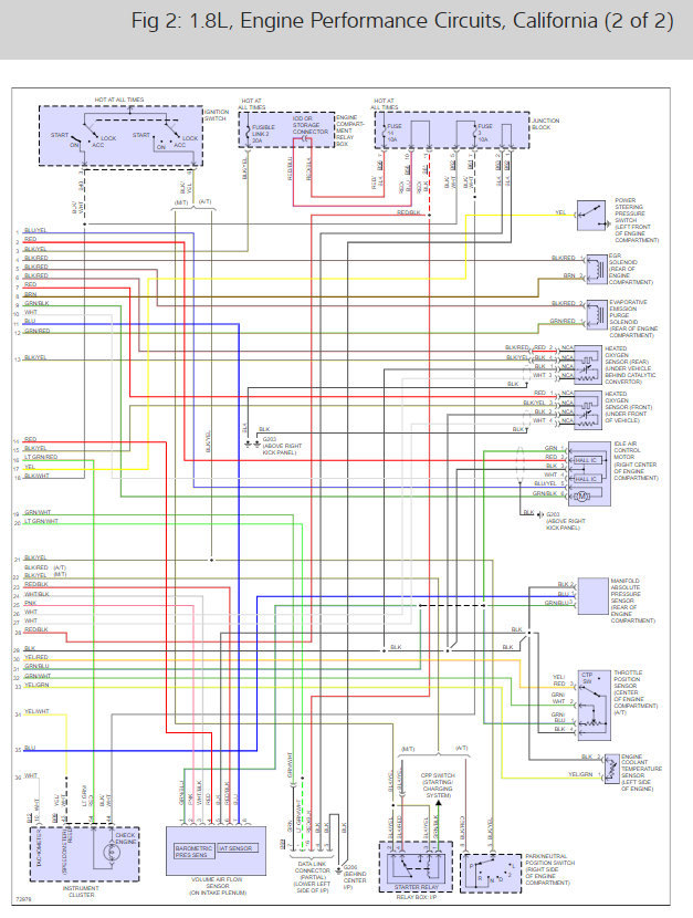

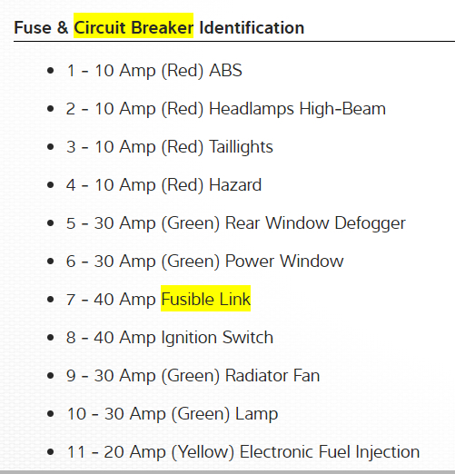

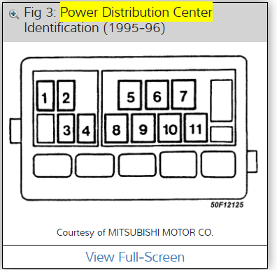

It sounds like you have an injector relay that is out here is a test to help you confirm the failure.
It #11 in the engine fuse panel here are engine wiring diagrams and the fuse and relay locations so you can get the problem fixed.
Please let us know what you find.

Thanks for the diagrams and guide you where right once I replaced the relay the engine started right up! I love this site
