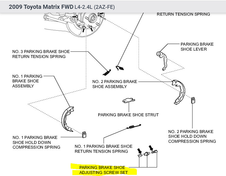

On this model vehicle, you will need to remove the brake caliper and disc rotor to access the adjuster. It is a star-shaped adjuster.
I attached an exploded view of the component below.
If you are not getting any braking and you have the inside adjuster fully set, you may have a broken cable. So, check that.
Also, if the cable is good, turn back the interior adjuster so you can fine-tune it once the adjustment is made at the wheel.
When you remove the brake disc rotor, make sure to clean the components inside with brake cleaner, and inspect the brake shoes to make sure they are good.
Let me know what you find or if I can help.

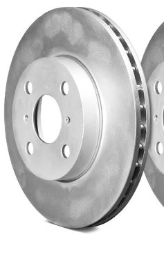

Also, based on my manual, this model only came with rear disc brakes. When you look through the rear wheel, you should see the disc rotor. It will look much like the front brakes. I attached a pic of a brake rotor below. Let me know if that is what you see.
Also, the link I attached explains how to remove the brake caliper, pads, and all that is needed.
See pic below.

Ah, yeah, that's exactly what I see.
