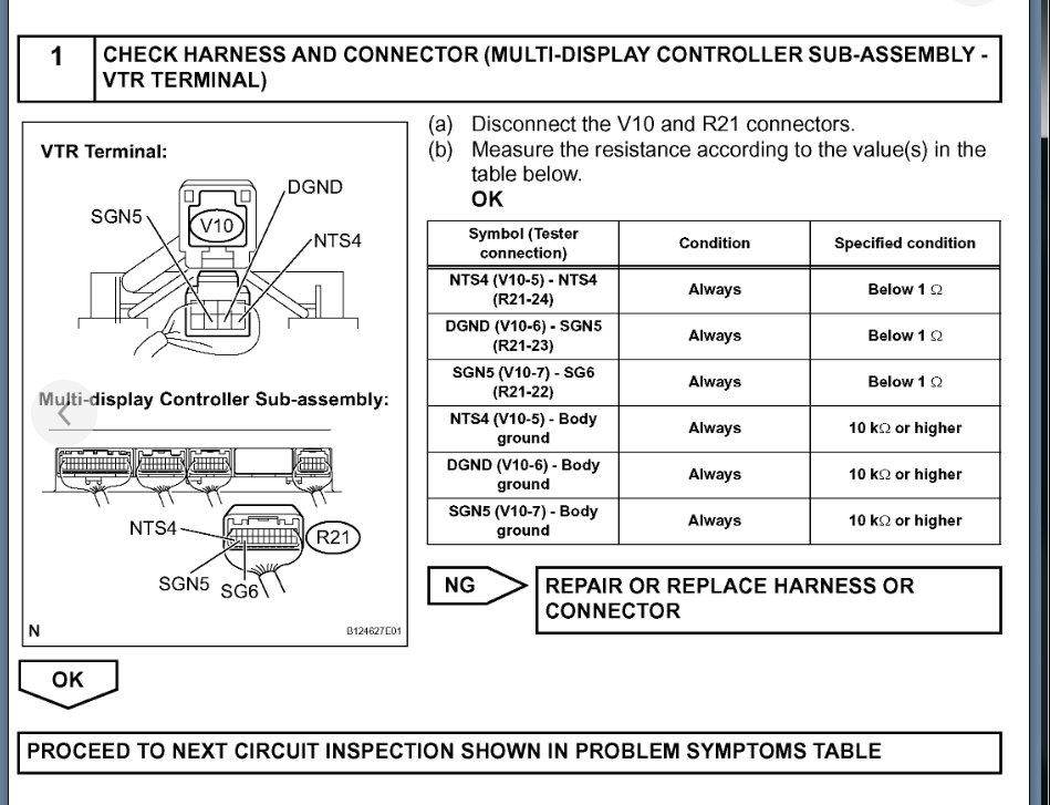

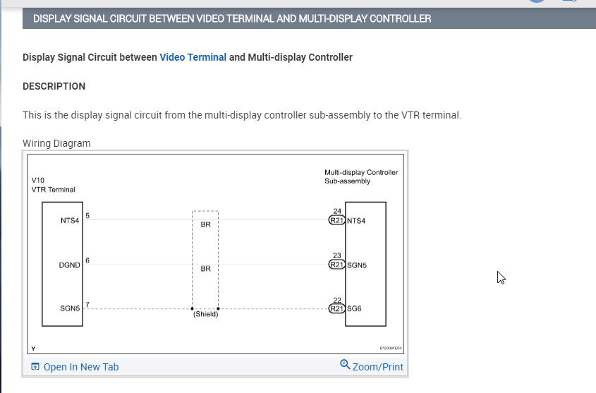

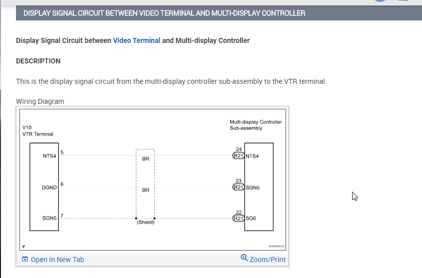

Haha. I totally understand. These systems are great but they are not fun to figure out when something goes wrong.
Let me know your comfort level if you want to try it but it is going to require a lot of disassembly to get to these components.
I am not trying to discourage you but it is not a fun job.
