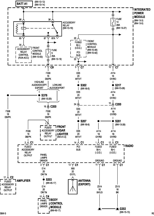

The fuse is located inside the front fuse panel under, (left side) the hood #14 - 20 amp.
