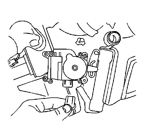

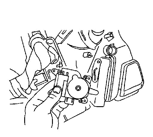

Here are the directions specific to your vehicle for replacement. the attached pics correlate with the directions.
______________________________________
2005 Cadillac STS V8-4.6L VIN A
Air Temperature Actuator - Left
Vehicle Heating and Air Conditioning Air Door Actuator / Motor Service and Repair Procedures Air Temperature Actuator - Left
AIR TEMPERATURE ACTUATOR - LEFT
AIR TEMPERATURE ACTUATOR REPLACEMENT - LEFT
REMOVAL PROCEDURE
1. Remove the left closeout panel.
pic 1
2. Disconnect the left air temperature actuator electrical connector from the actuator.
3. Remove the left air temperature actuator screws.
pic 2
4. Remove the left air temperature actuator.
