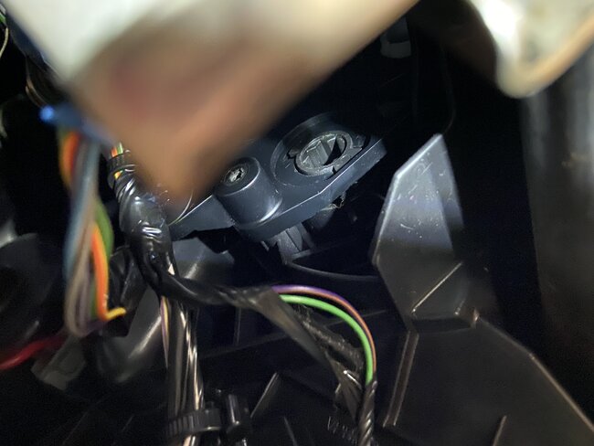

CAREY BLINDENHOFER
Hi Joe,
The pic was hard to get a bead on due to the awkward location.
This was the best I could do.
If the tabs are on the outside of the hole, you can move the connector, but I wouldn’t say it was moving the interior flap, but I definitely didn’t try too hard as it’s very difficult to grip, and I didn’t want to break anything.
Aug 9, 2023 at 12:59 PM

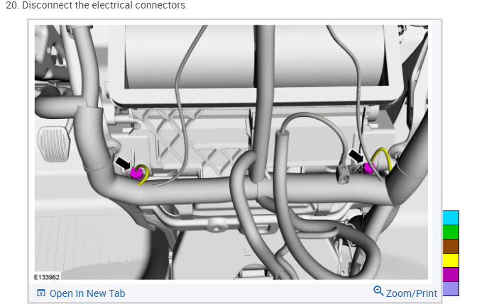

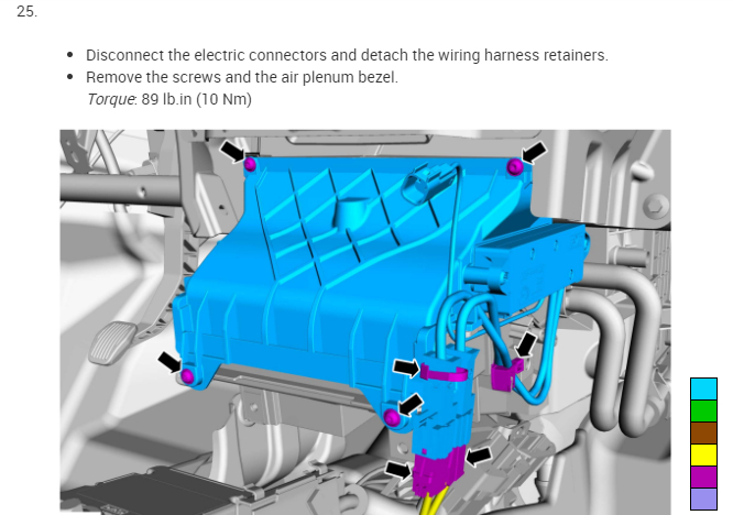

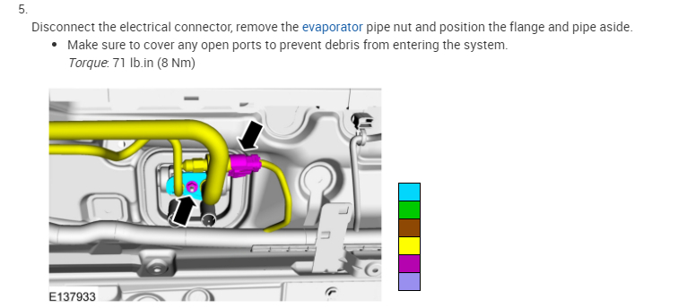

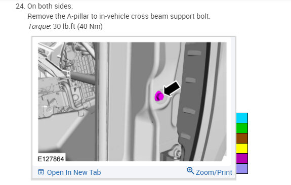

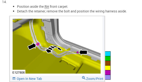

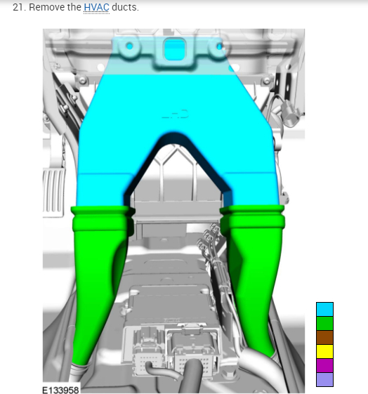

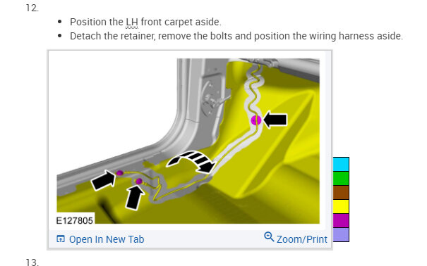

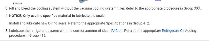

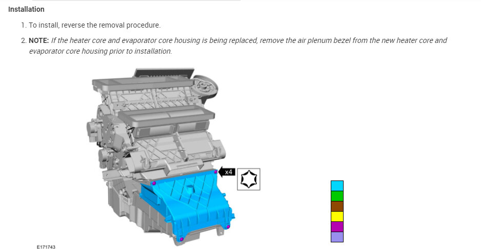

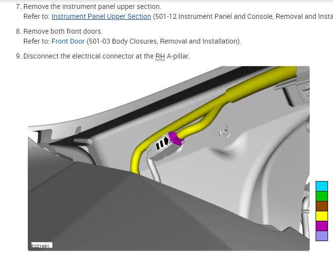

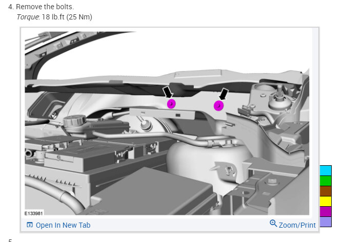

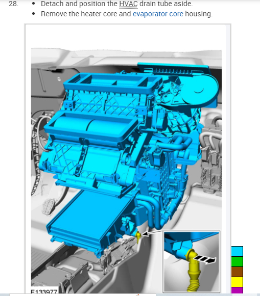

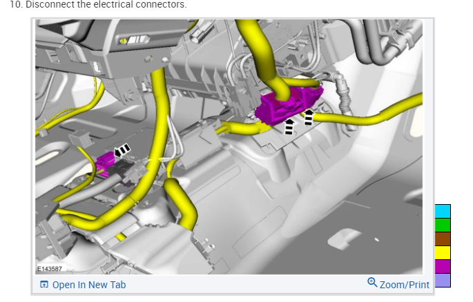

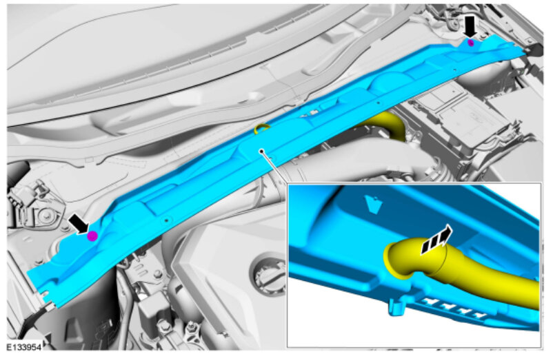

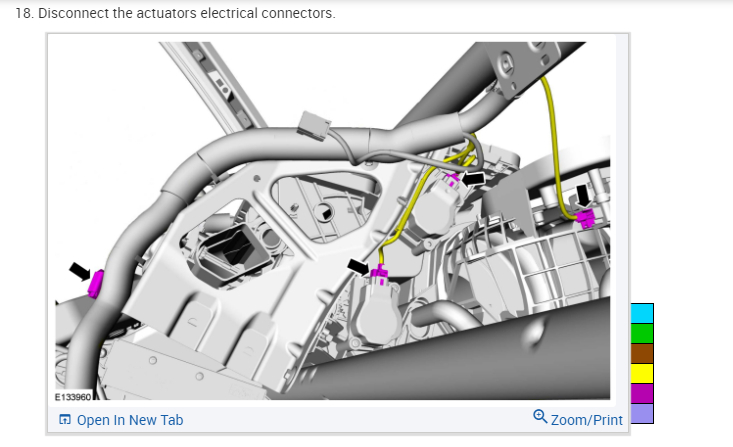

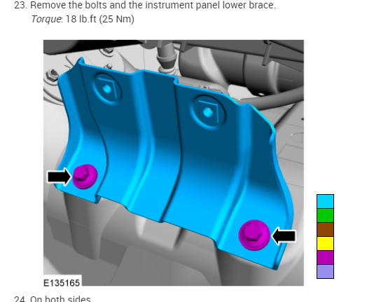

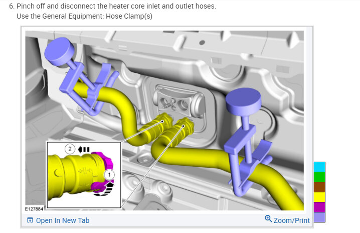

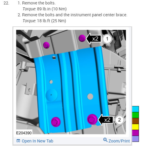

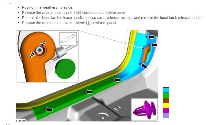

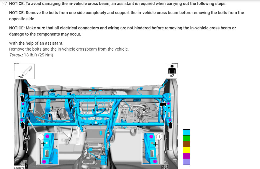

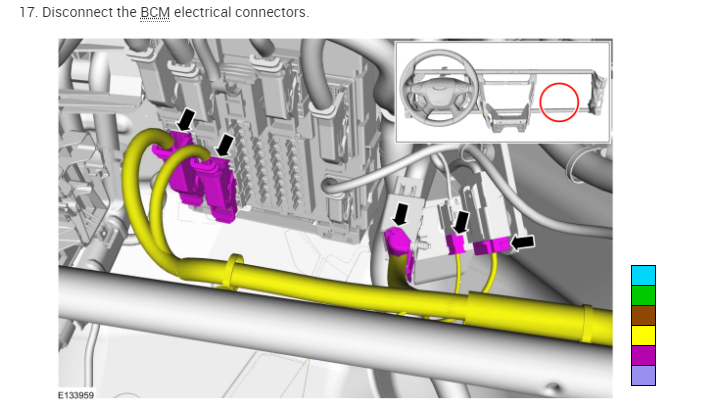

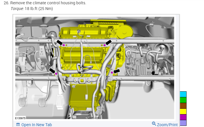

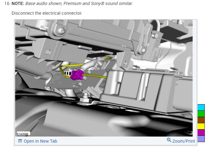

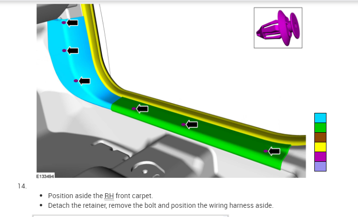

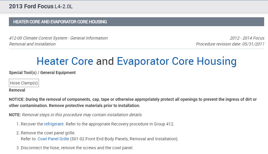

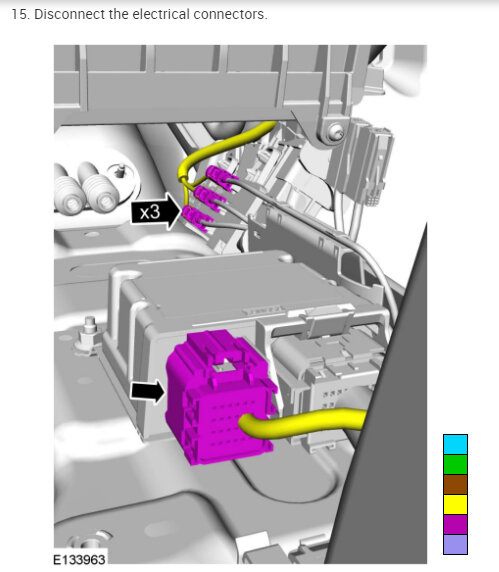

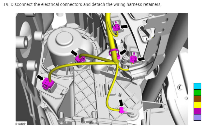

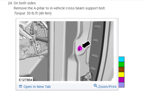

The pic is fine. I have a feeling that part is either cracked or the door is stuck. The only thing I can suggest is if you can't access it to see if the door moves, we likely need to remove the unit which requires removing a lot of parts. Also, the heater core and evaporator will need to come out at the same time. Heck, they even tell you to remove both front doors. Ugh! See step 8 in pic 6.
I attached the directions below for the removal of the housing for you to see. It is a bit overwhelming but doable.
Question: Are you able to fully remove the part with the tabs for inspection?
See pics below.
