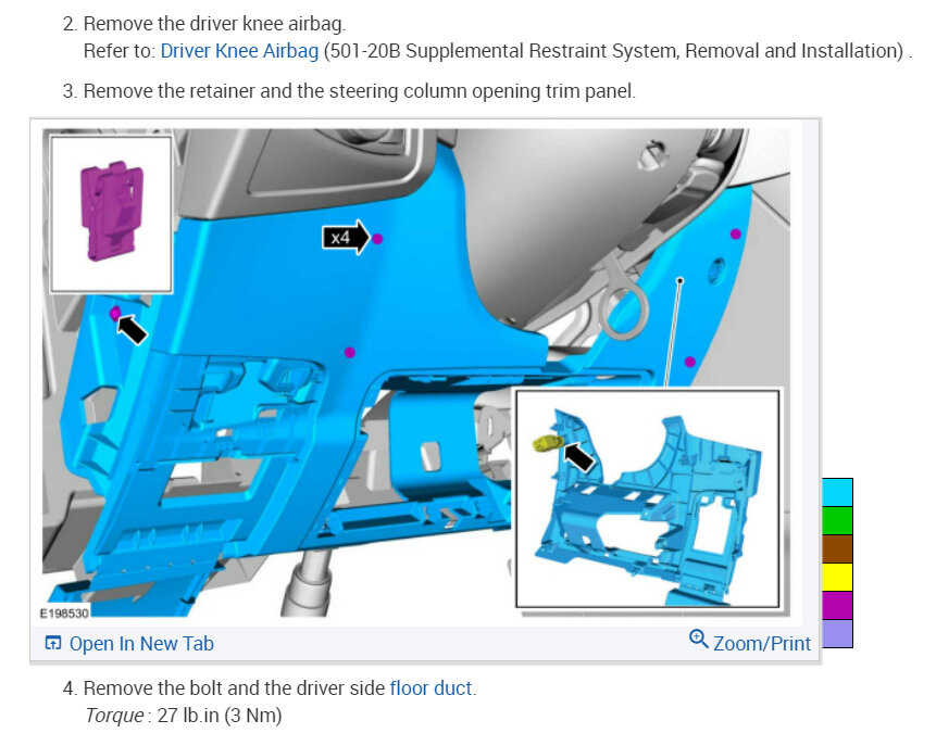

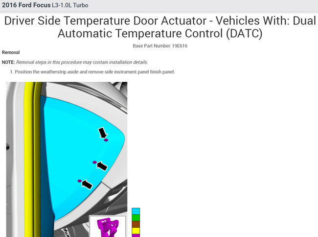

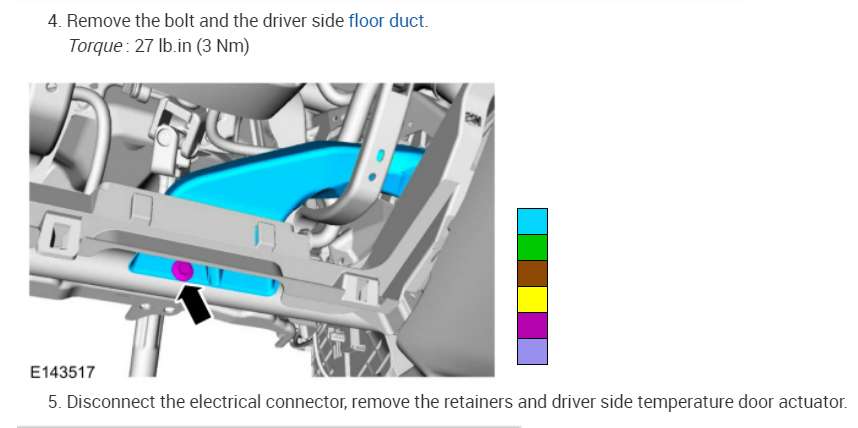

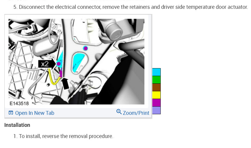

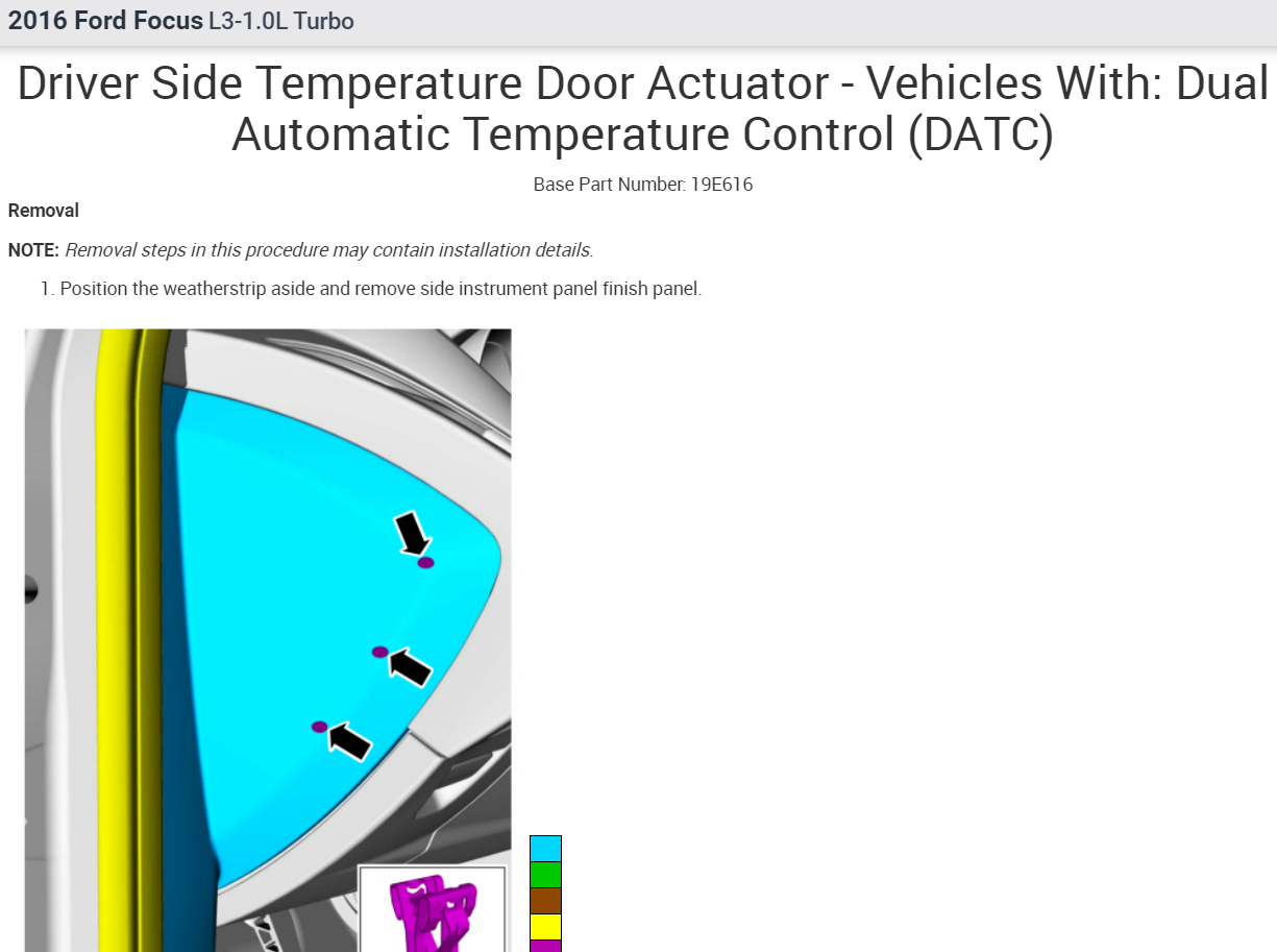

Yes, this happens when the driver's side temperature blend door actuator has gone bad. here is how to change it out, you want to confirm the problem you should do a CAN scan.
You can get a CAN scanner (Controller Area Network) which will work on most cars from Amazon.
Here is a video to show you how:
https://youtu.be/u-4syLc-ifQ
Here is how to change the actuator out in the images below. Please let us know if you need anything else to get the problem fixed.
