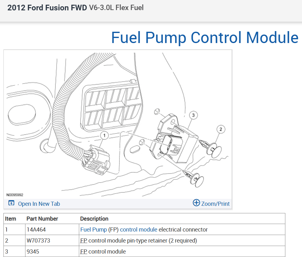

If all of the spark plugs are black, I would swap out the FPM. Here is a guide to help as well.
https://www.2carpros.com/articles/why-an-automotive-engine-will-run-rich
Position aside the LR quarter panel luggage compartment trim.
Disconnect the Fuel Pump (FP) control module electrical connector.
Remove the 2 pin-type retainers and the FP control module.
To install, reverse the removal procedure.
Clear the codes once completed. Check out the images (below). Please let us know what happens.
