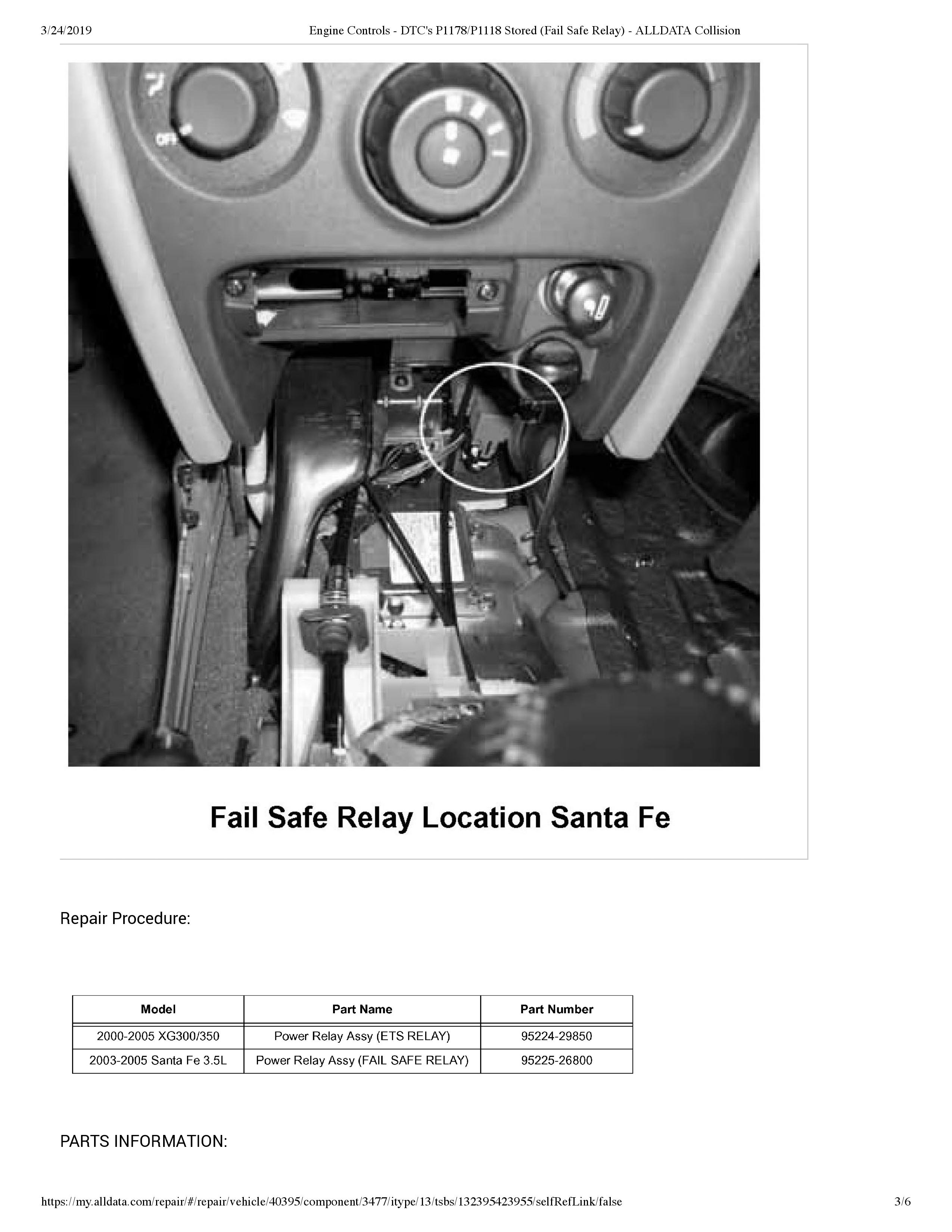

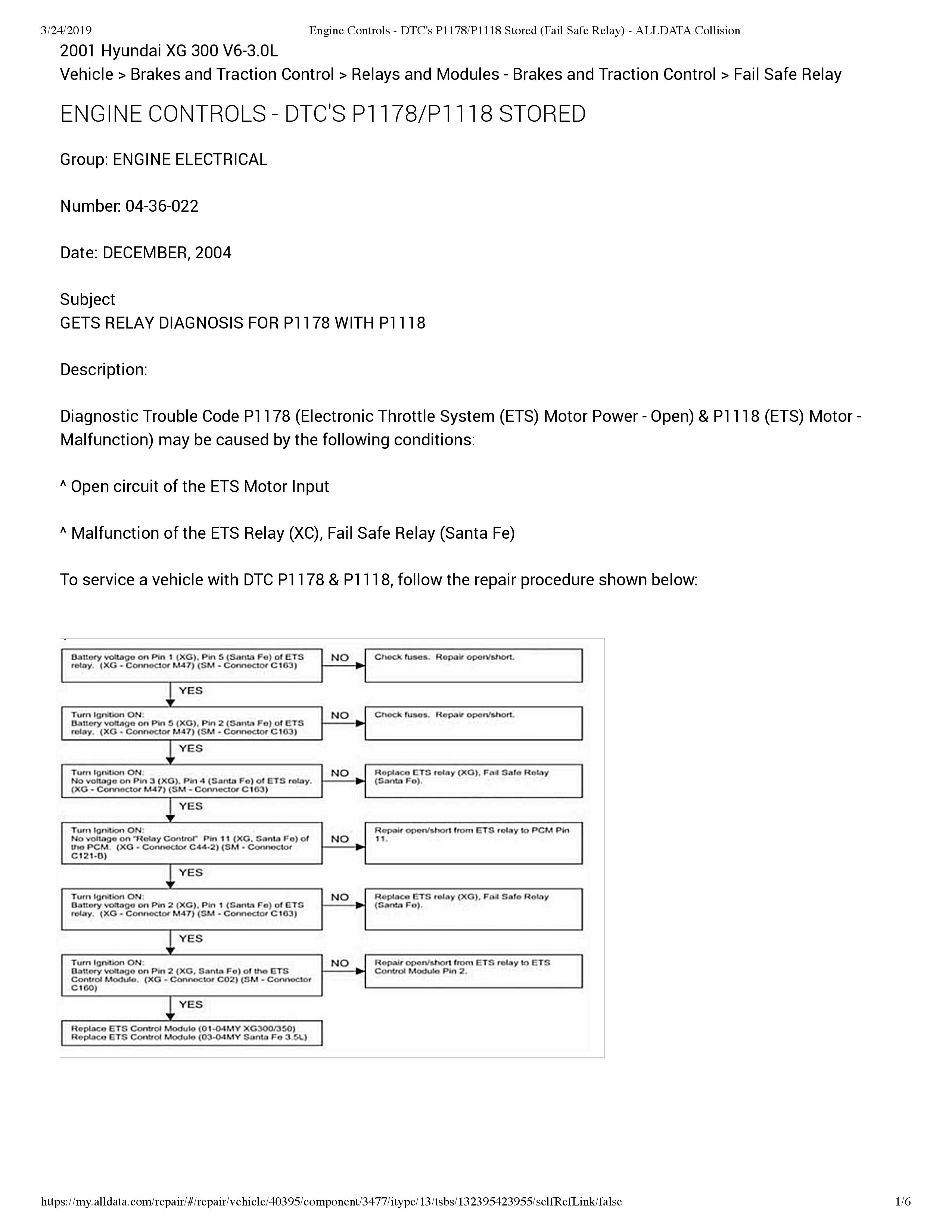

Hey BPRESTON72190,

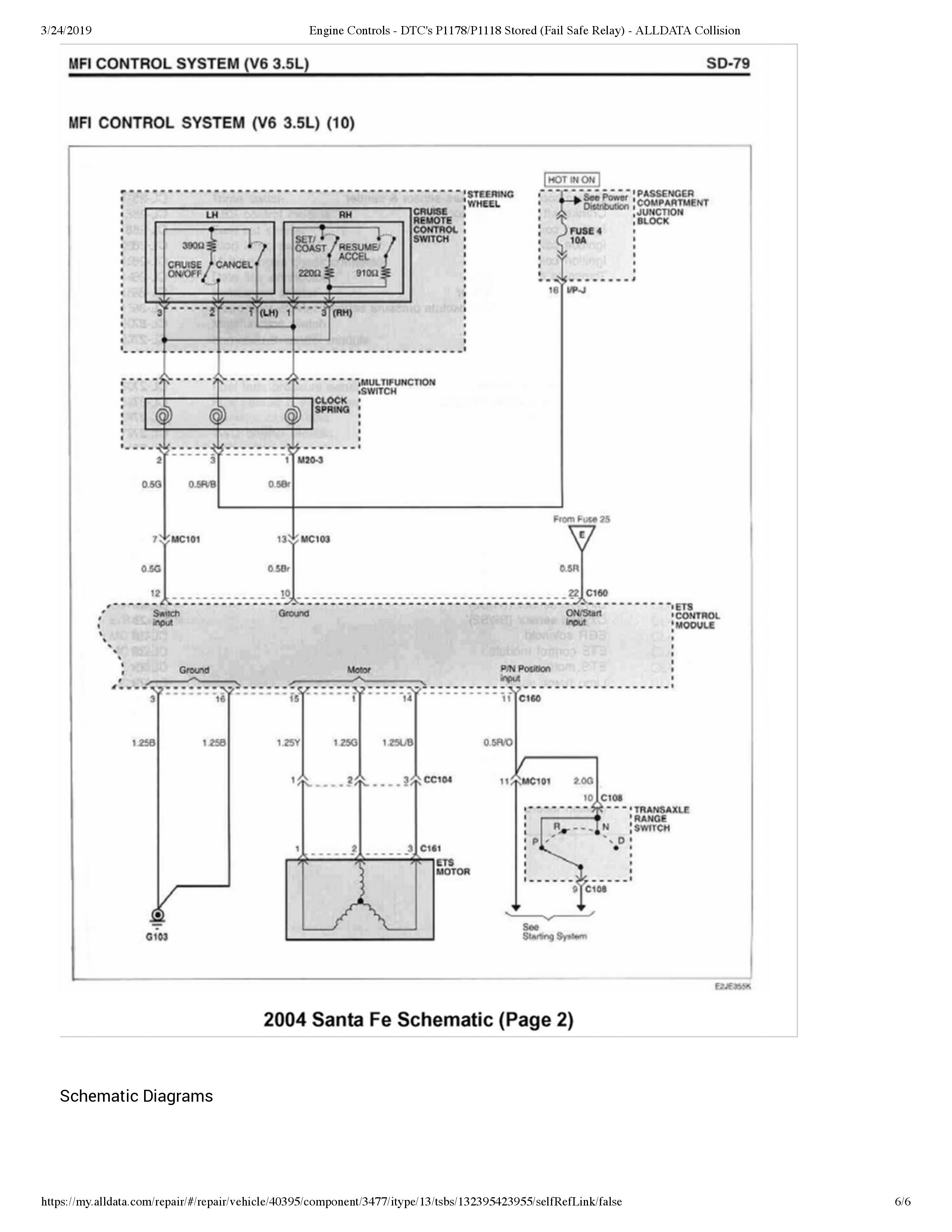

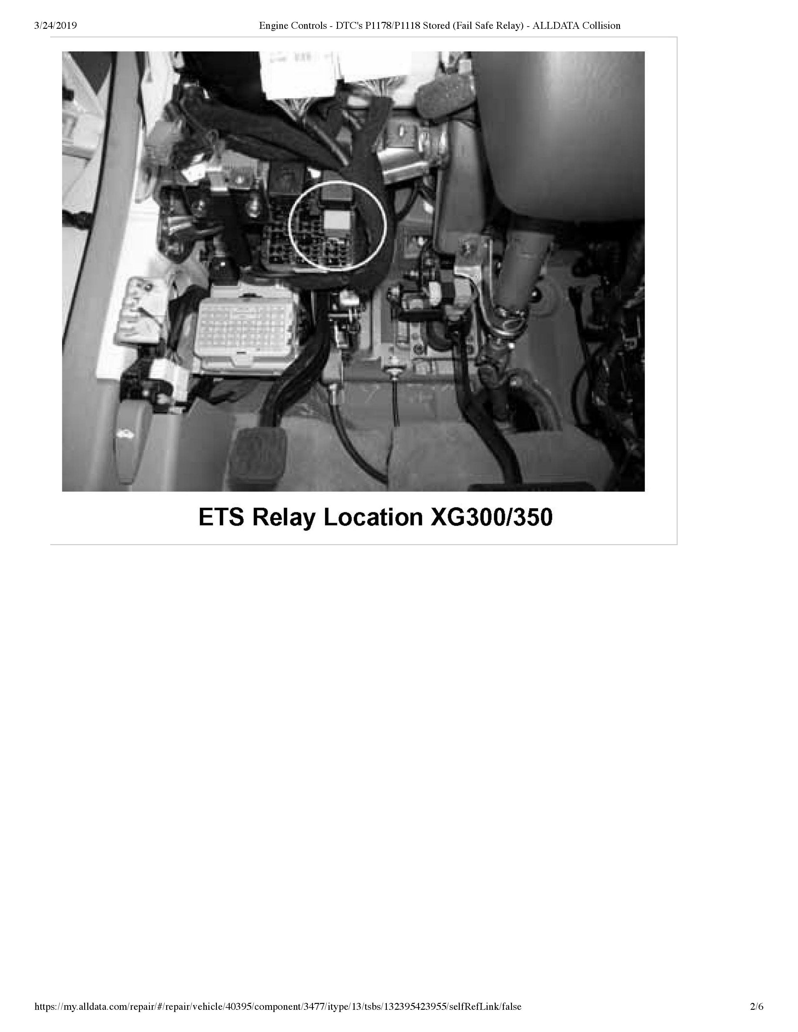

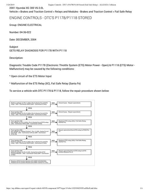

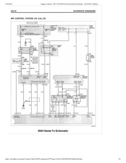

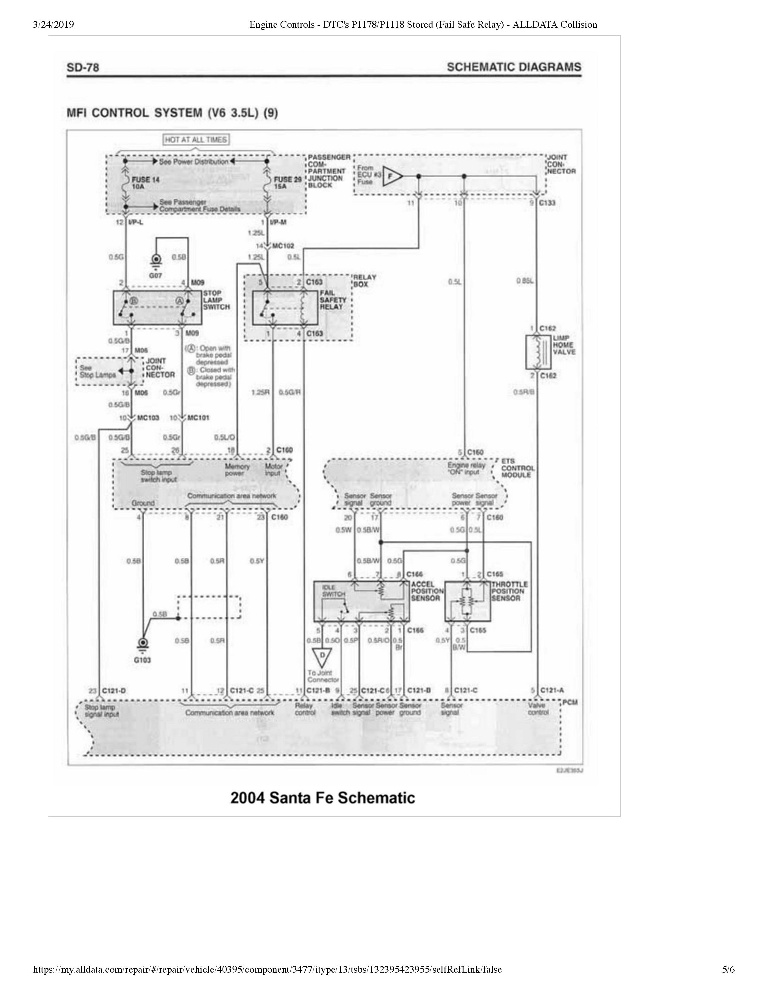

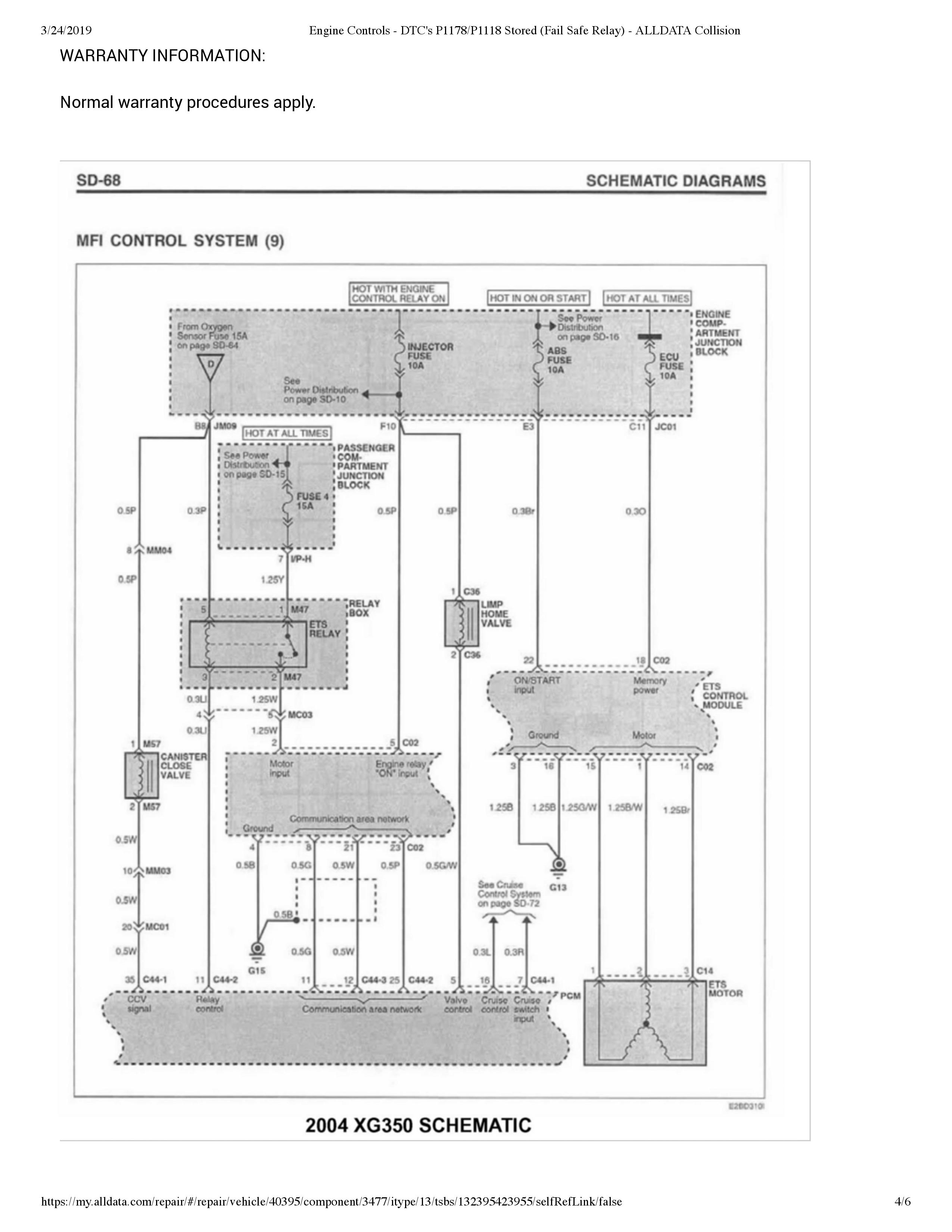

After checking the information i have for this vehicle i have found a TSB (technical service bulletin) that may cover the issue you have.
It does require the codes P1118 and P1178 to be stored however it does describe a fault with the ETS (Electronic Throttle System) relay.
What scanner are you using?
I would have a read through the TSB, it contains some good trouble shooting guidance and wiring diagrams.
Hope this helps. Let me know if you have any further questions.
regards, Joe
