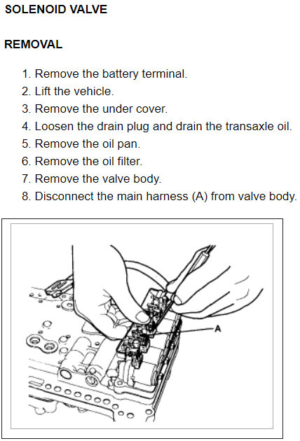

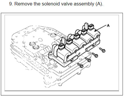

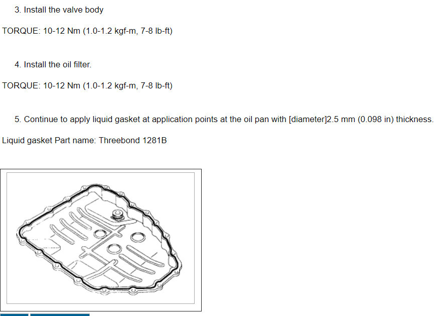

This guide will give him an idea for what it will take to remove the transmission pan:

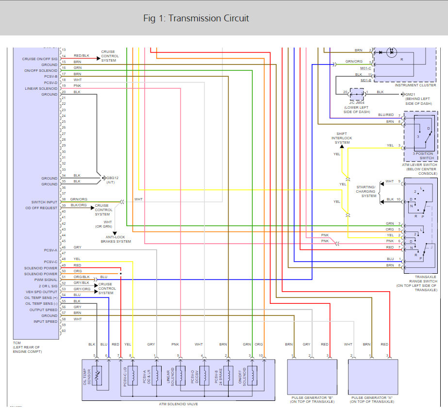

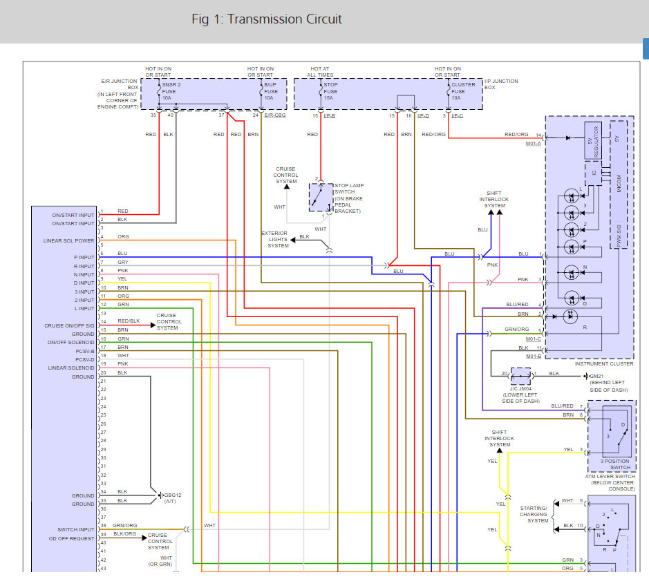

Below are the transmission wiring diagrams to help him get started.
Check out the diagrams (below).
