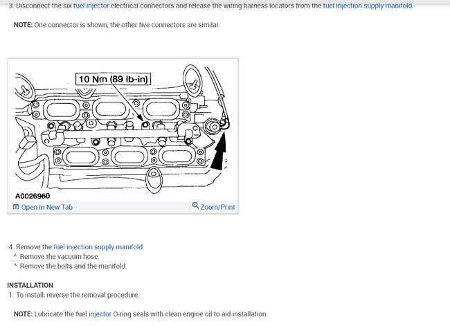

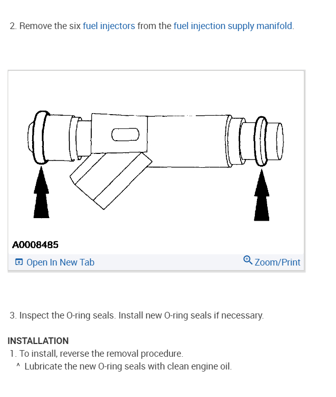

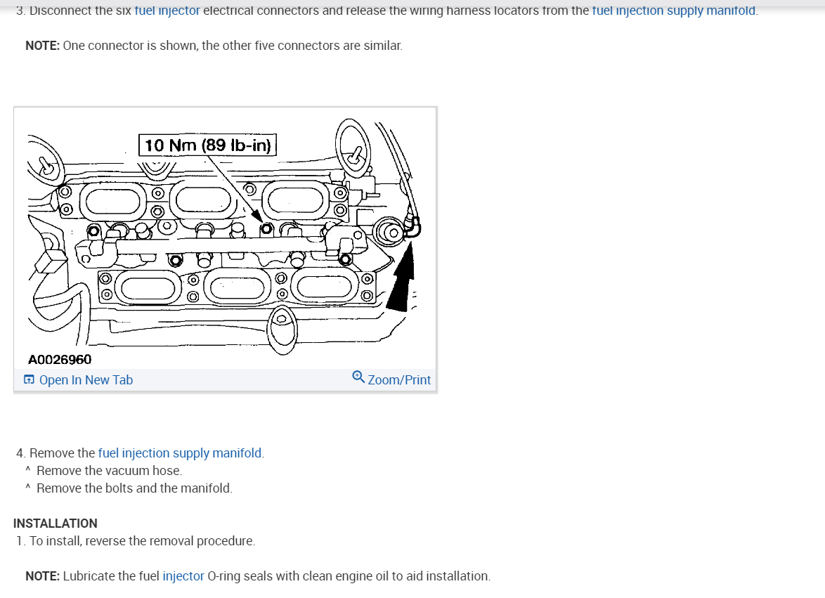

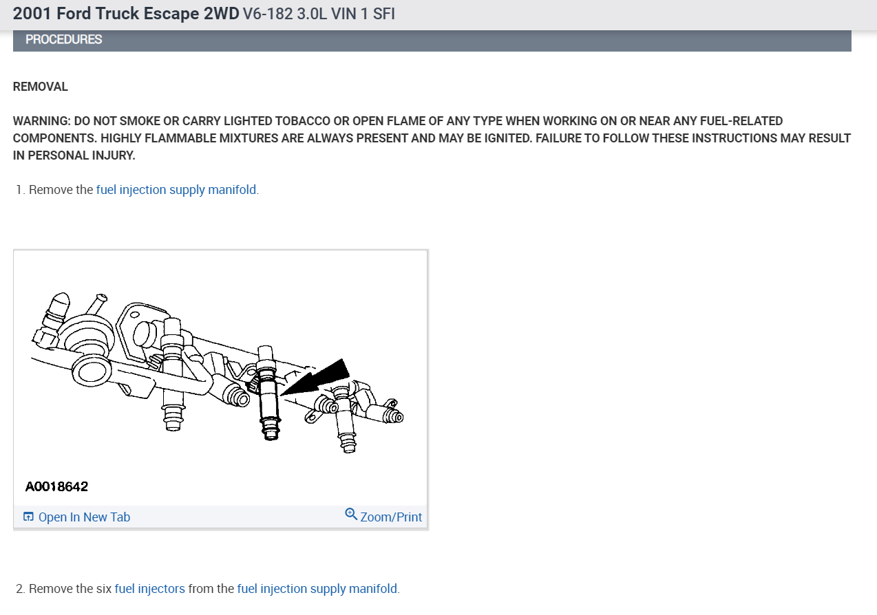

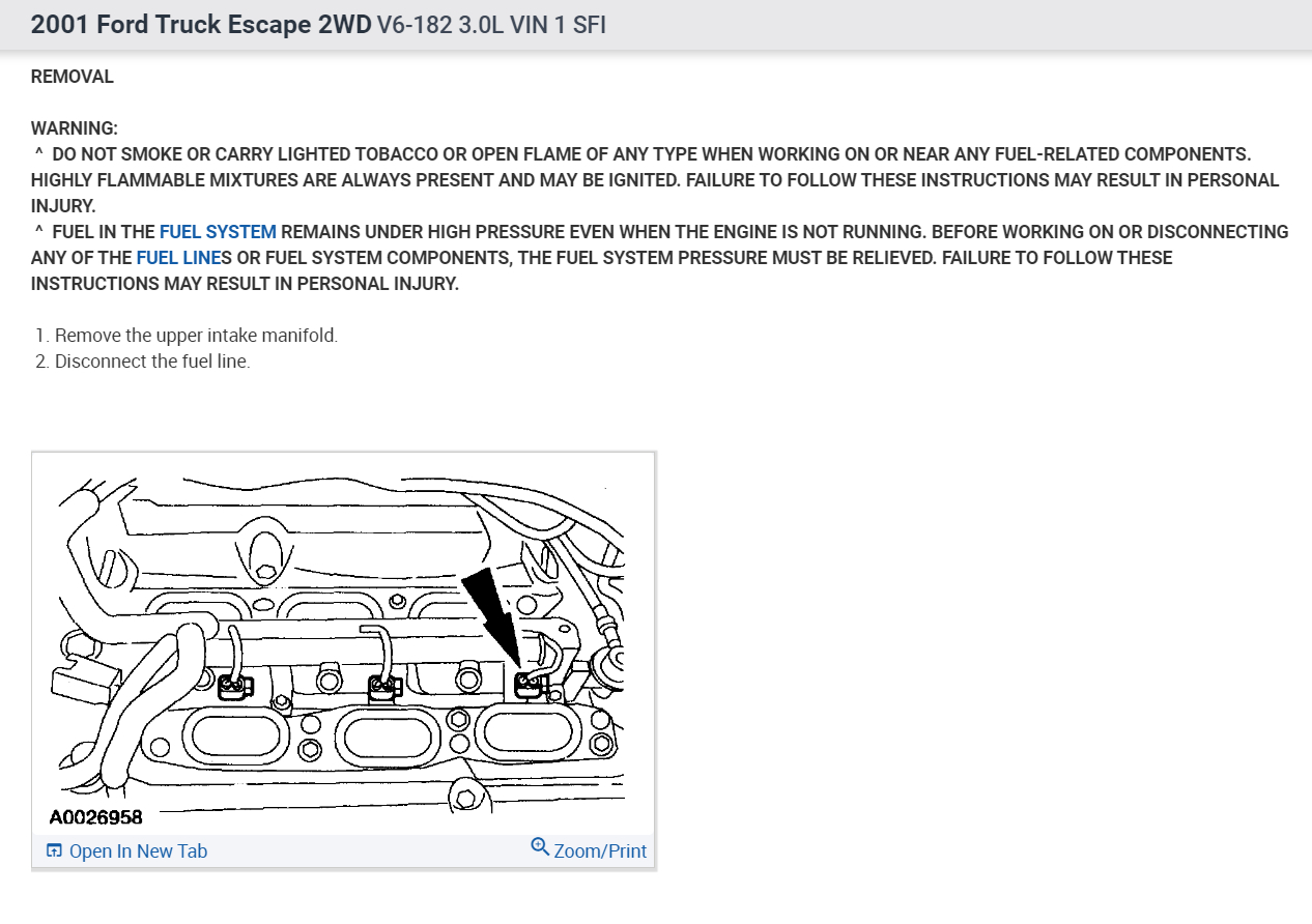

The P0153 trouble code is the oxygen sensor is not properly regulating the fuel levels. So, you have a fuel injector that does not close completely at times. You may be able to remove the spark plugs and look for the one that is darker than the others which will be the cylinder that is having the issue. Here is a generic guide on how to replace the injectors that will help walk you through the process with instructions below to show you how on your car.
https://www.2carpros.com/articles/how-to-replace-a-fuel-injector

P1151 is a Lack of upstream heated oxygen sensor switching, which means the sensor is way lean or rich which a bad injector can do. I would service the throttle bore and do the injector work.
Here is a guide to help walk you through the cleaning:
Please go over this guide and report back.
