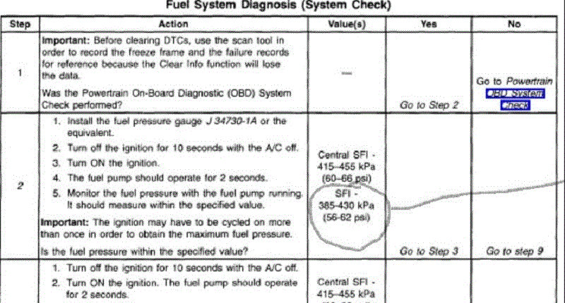

My fuel pressure at the test port by manifold is in the expected rang. Specs call for 55 to 62 and it is running at 58-59 psi. I changed the fuel filter anyway. while the fuel filter was off I tested the pressure at the feed side of the filter. It was about 69-70 psi. I did check for vacuum leaks all around the exterior top engine with carb cleaner. No change in idle speed. As far as the misfire, how does scanner know that there is a misfire (~177 count) and as I stated before I can see it firing. I will check compression.

fuel pressure on this engine should be 60-66 psi key on only. the 55-62 is for a 7.4L if itdoesn't meet minimum that may be your problem.

I am not sure where your info is coming from. I am sure the range is 55-62 for my GMC 1500 truck 5.7 L. here in MI 600 ft. above sea level. I have two other GMC as stated in the original post. I use the 98 daily. I just checked the pressure with key on and it is steady at 58 or 59 psi. My GM code flow chart spec. is 55-62 psi according to my VIN number. Thanks for you time anyway.

The pressure you are referring to is for a different fuel injector system. It is the central SFI my is the SFI.
