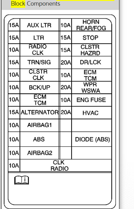

Did you check all fuses with the system on? If all fuses are good:
P0651 - Sensor Reference Voltage "A" Circuit/Open:
P2106 - Throttle Actuator Control (TAC) System - Forced Limited Power:
So these codes are telling us the PCM has shorted out, you can get a preprogrammed unit by searching Google or Ebay.
Sep 18, 2023 at 11:12 AM

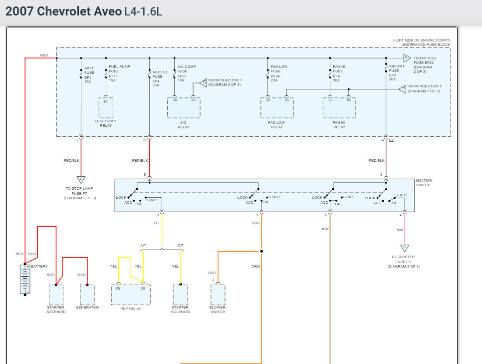

Replaced battery fuse with original equipment hard to find discontinued parts. Amazon thankfully had this part. I may be wrong on the connections any chance of a diagram on this battery terminal set up. I took pictures but my phone did not save them because of issues with full memory.

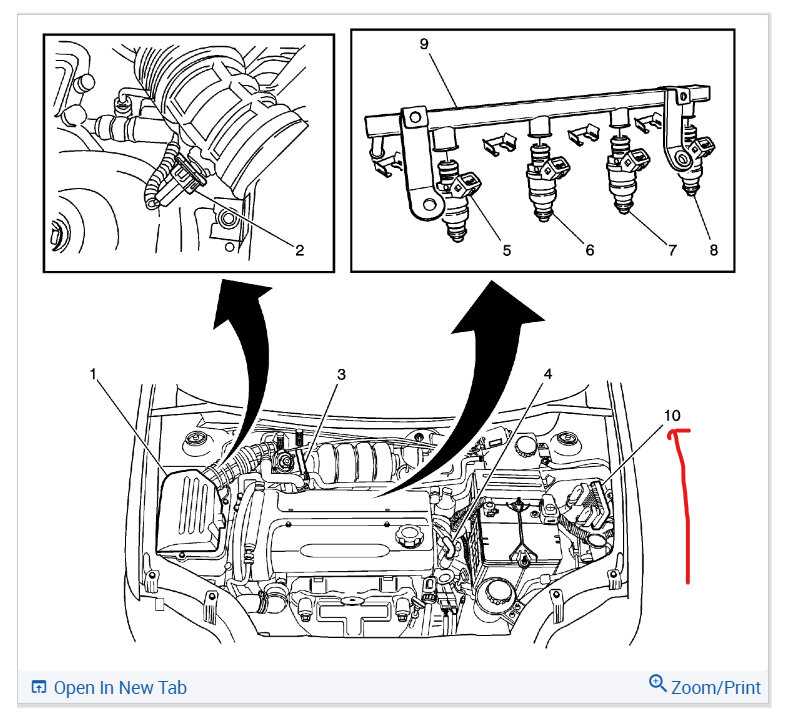

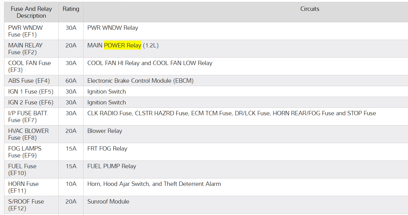

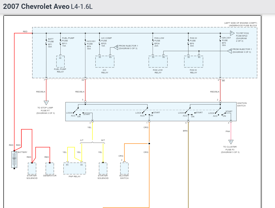

Sure, here is the main power wiring diagrams so you can see how the system works and where to test for power. This guide can help:
Check out the images (below). Please let us know how it goes.

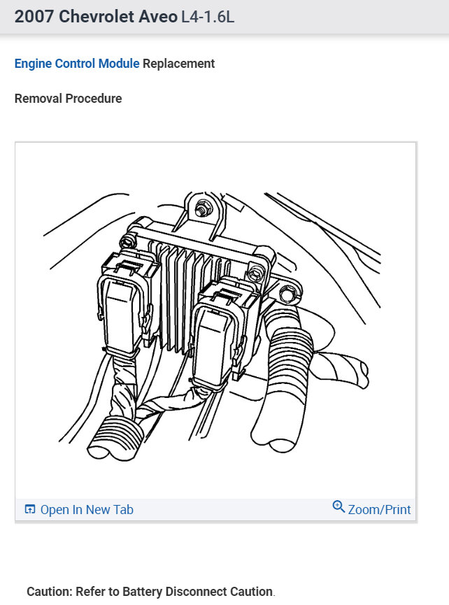

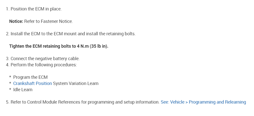

I'm reading my online repair manual and it's telling me that I need two keys or transponders inside of my vehicle in order to program this car. My question is how do I know if the ECM that I purchased was programmed I'm just going by what they're telling me that AutoZone. Also I have checked all of the top side power and everything checks out I'm going underneath today to start that from the bottom side and I believe this may have something to do with the auto locks it's inside the ignition in the steering wheel column I may be wrong but that's where I have narrowed it down to without being said I need to get another key made for this car is there any way that you can tell me what the part number is for the transponder key so that I don't order the wrong one I said 2007 Chevy Aveo 5 hatchback..
Sep 22, 2023 at 4:36 AM
CRITTERMOM21
  • 10 POSTS
Please also send instructions for relearning the car from scratch.
Sep 22, 2023 at 4:37 AM
You can get a transponder from Amazon; just put it in the car, you will have one. You can have a mobile locksmith come out to do the job/program the ignition key it should cost about $250.00. Also, I would scan the PCM to see if any codes are stored.

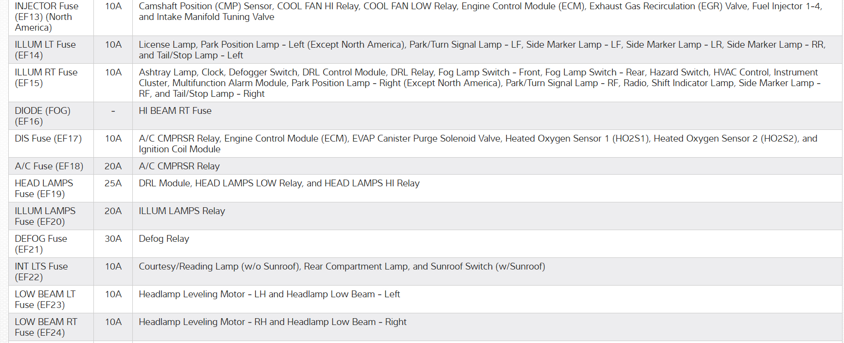

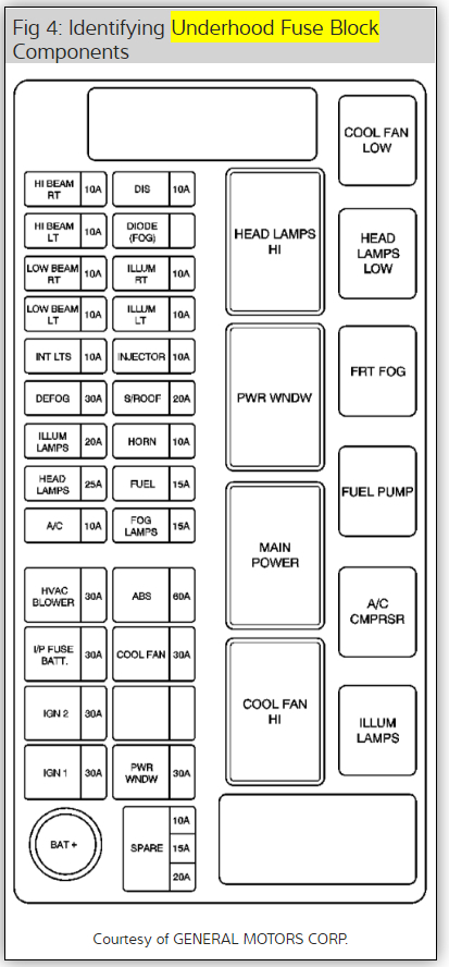

Okay, I've done all these. I need a screenshot of the fuse boxes. Both inside the car and under the hood. The alarm still is screaming, and the front driver tire will not turn when we pulled it to keep it from being a squirrel home. I've got a Haynes repair manual. But the book seems to leave out the hatchback in some scenarios. And also, will go into few details and then cut you off saying well you won't be able to do this, and you'll need to take the car into be on a computer. I have the software for these things so that gets me nowhere again. I'm leaning towards getting a completely new wiring harness. It's a fairly decent price online and doesn't entail a lot of rocket science. Any ideas please help. And just stay with me I'll get this car going. It has all new parts. No reason not to.
Nov 21, 2023 at 7:22 PM

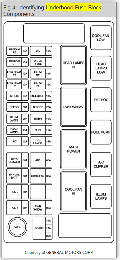

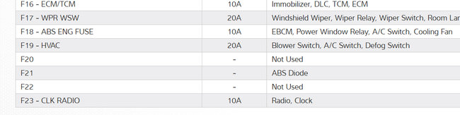

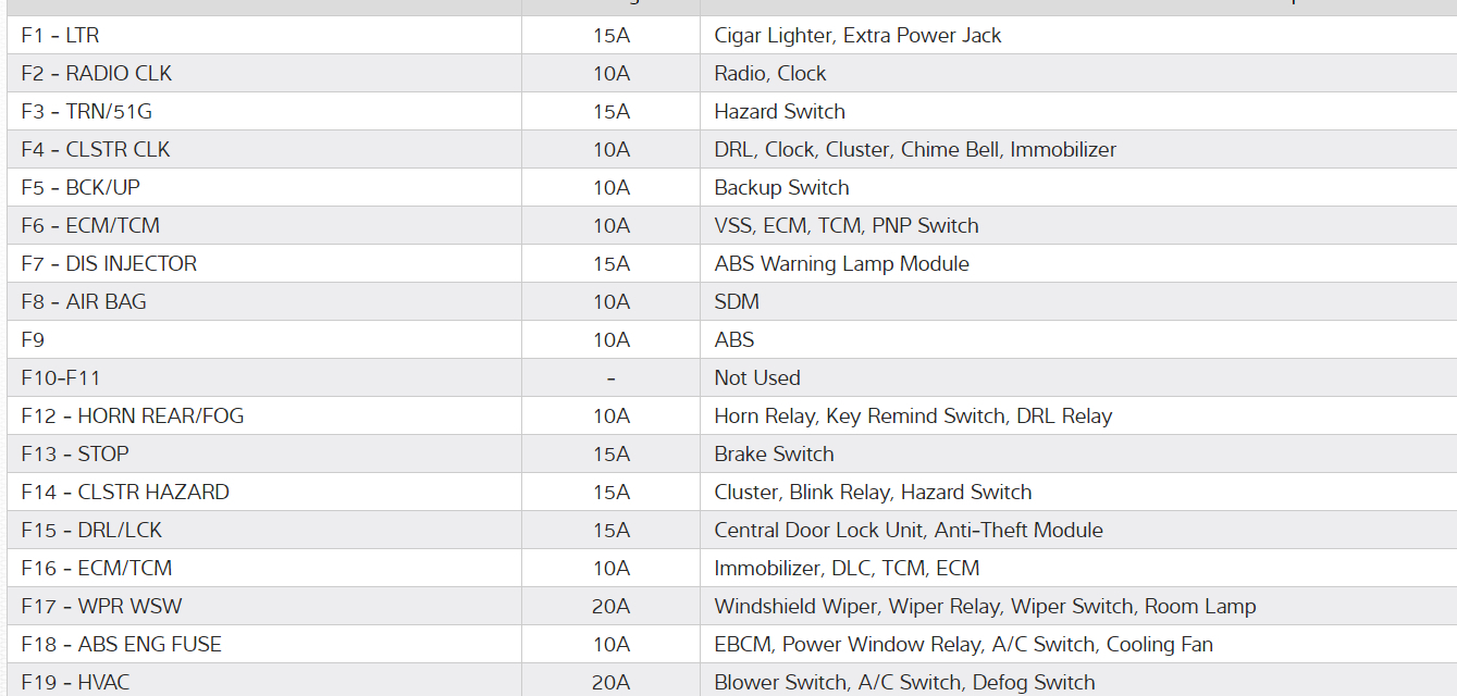

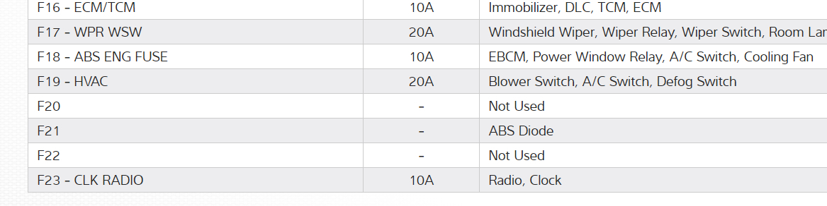

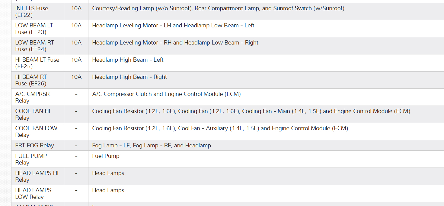

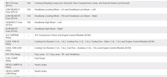

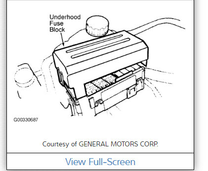

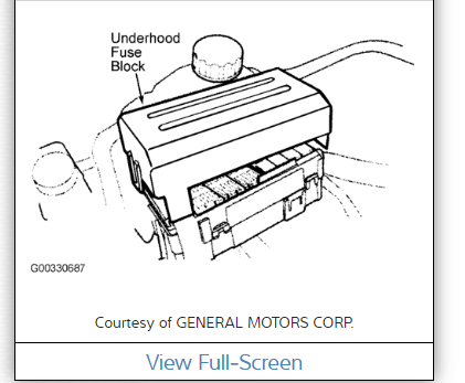

Yep, no problem. Let's get the car running. Here is a guide to help check the fuses and the panel locations and the fuse identifications as well:
Check out the images (below). Let us know how it goes.
