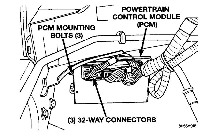

This code is for a failed PCM> Internal processor error.
The PCM needs to be replaced. It is located in the engine compartment.
