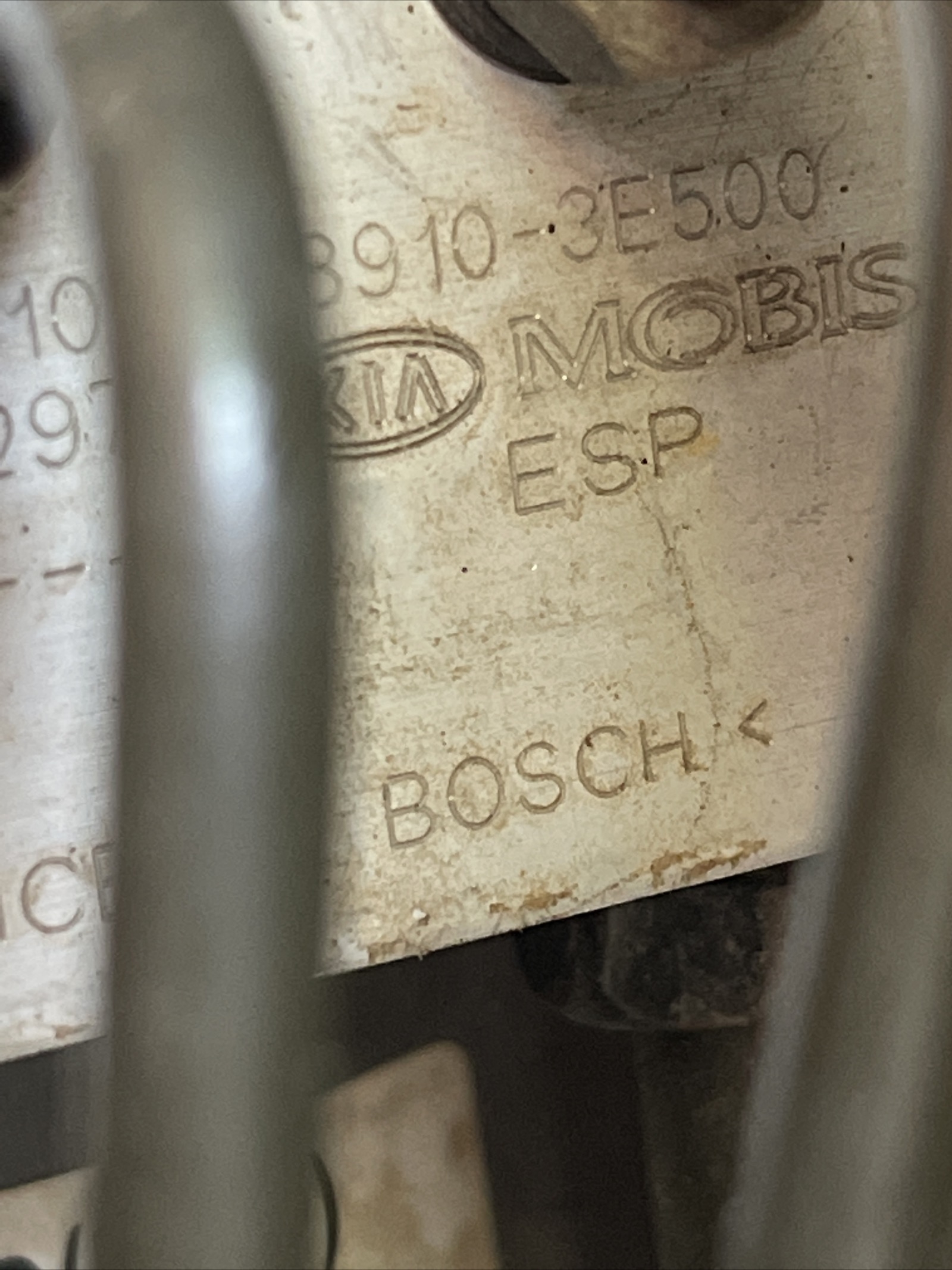

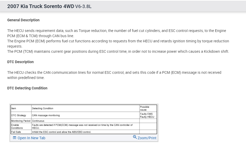

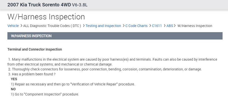

Problem: ESP light illuminated (always on)
Symptoms: Limp-Mode activated when ESP Off indicator trigger causing lost performance.
When to occur: Ignition on, no ESP OFF light, when car moving ESP OFF lights illuminated.
I have trouble to reset the DTC because it keep coming back.
I have faith that my ECU is still good condition because it if bad my car won’t crank/start.
