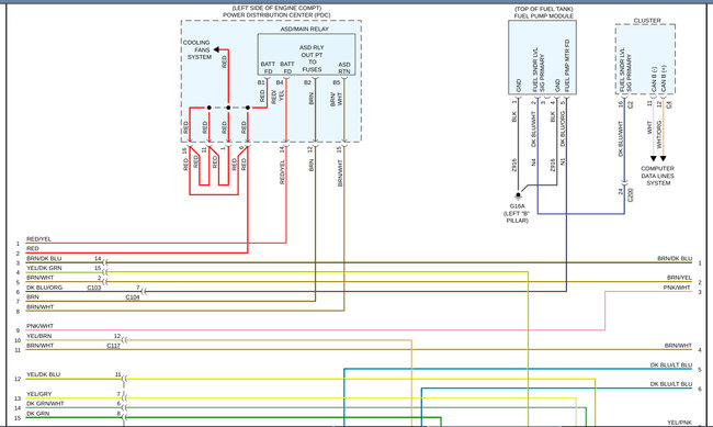

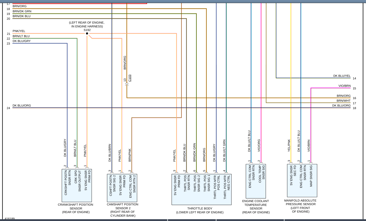

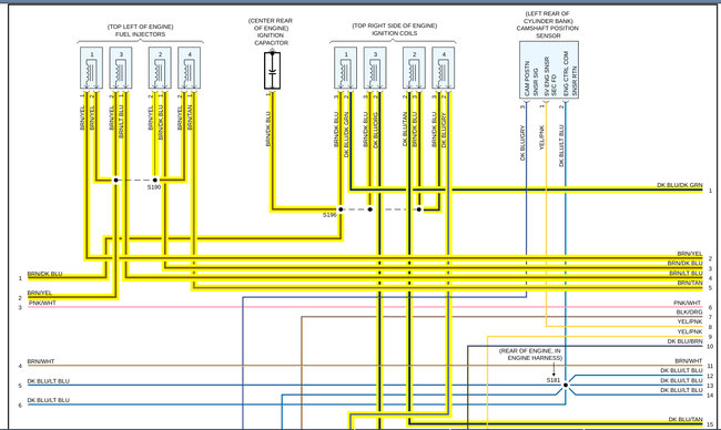

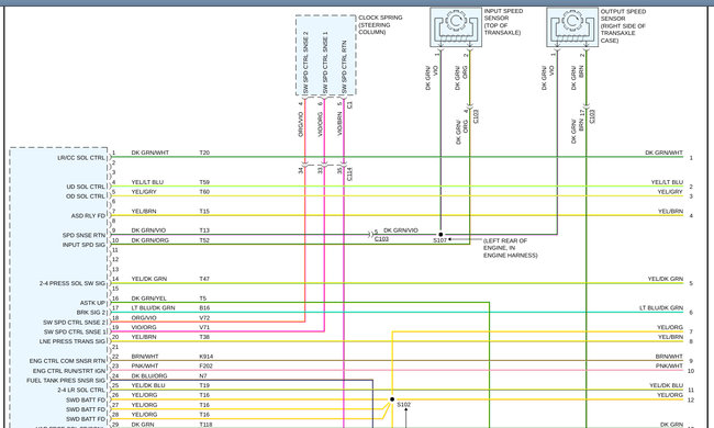

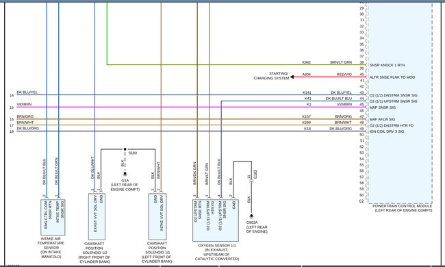

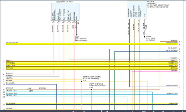

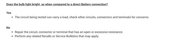

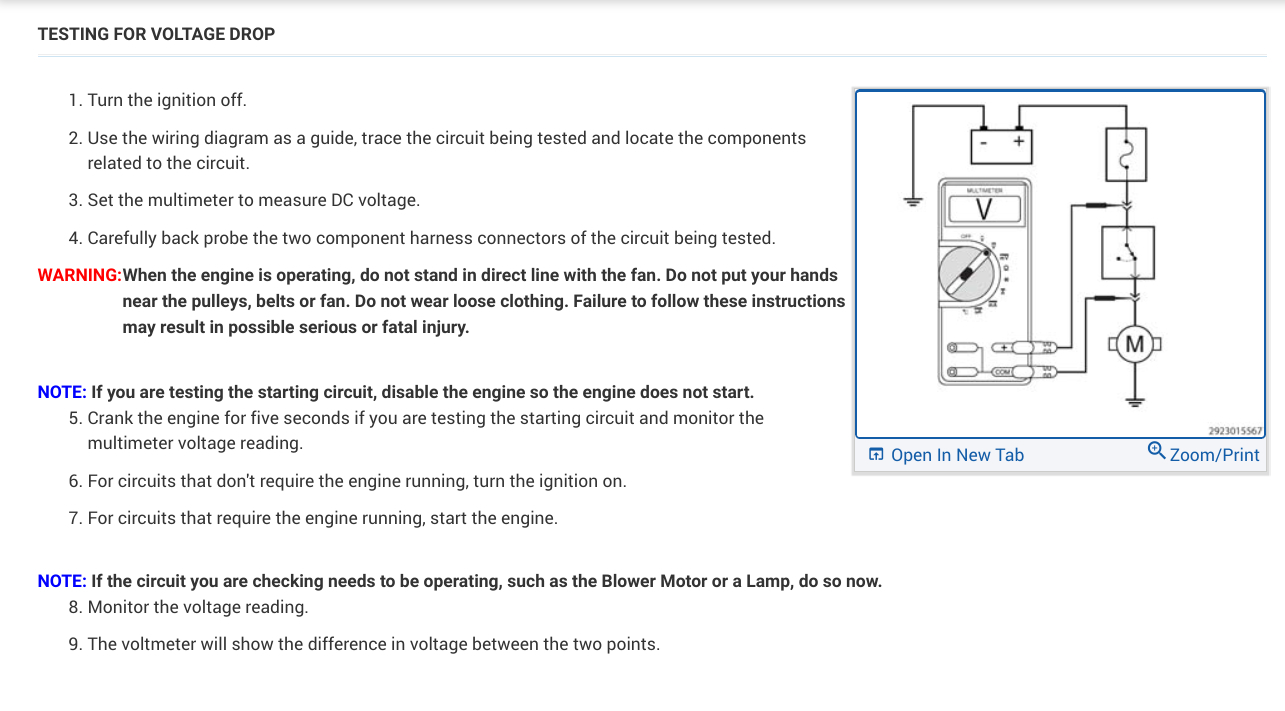

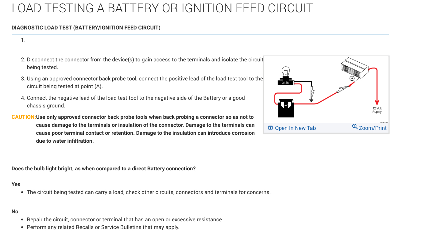

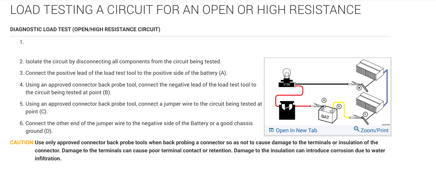

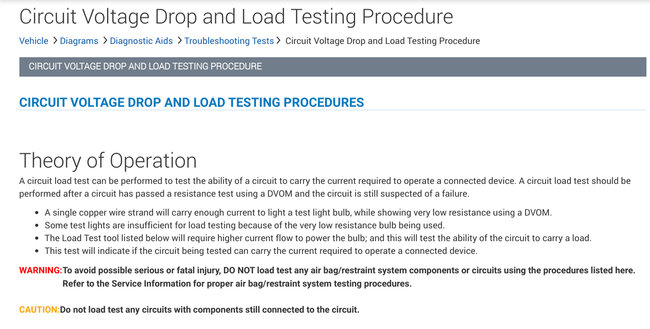

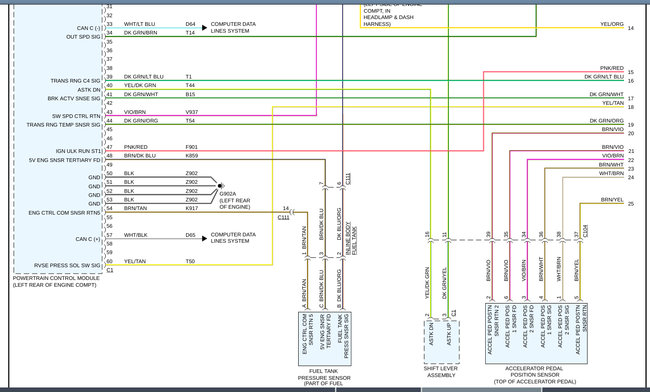

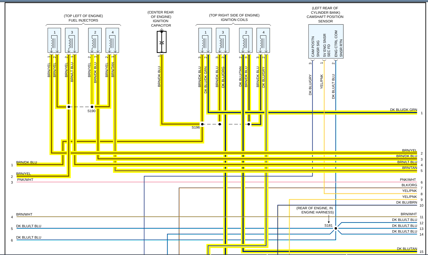

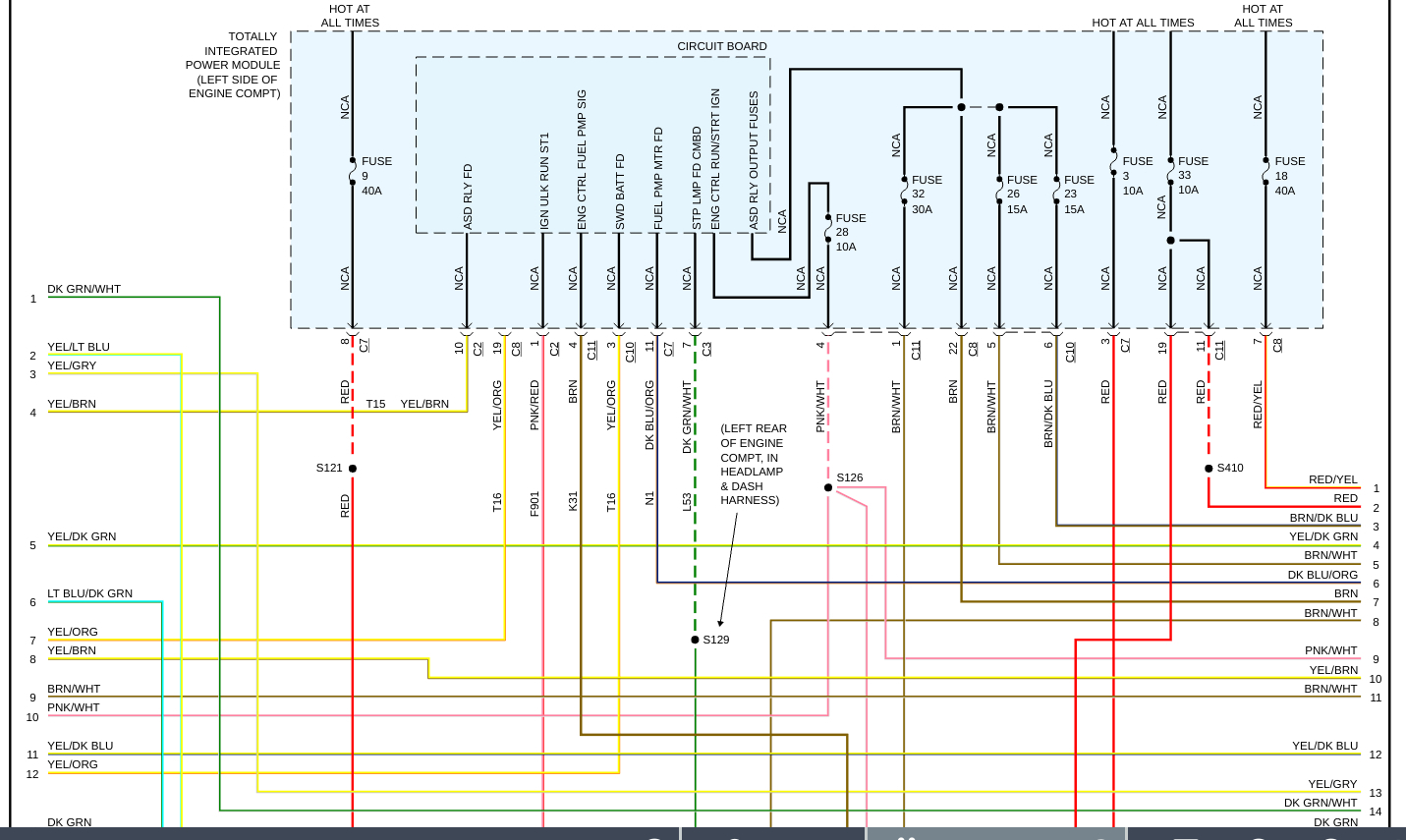

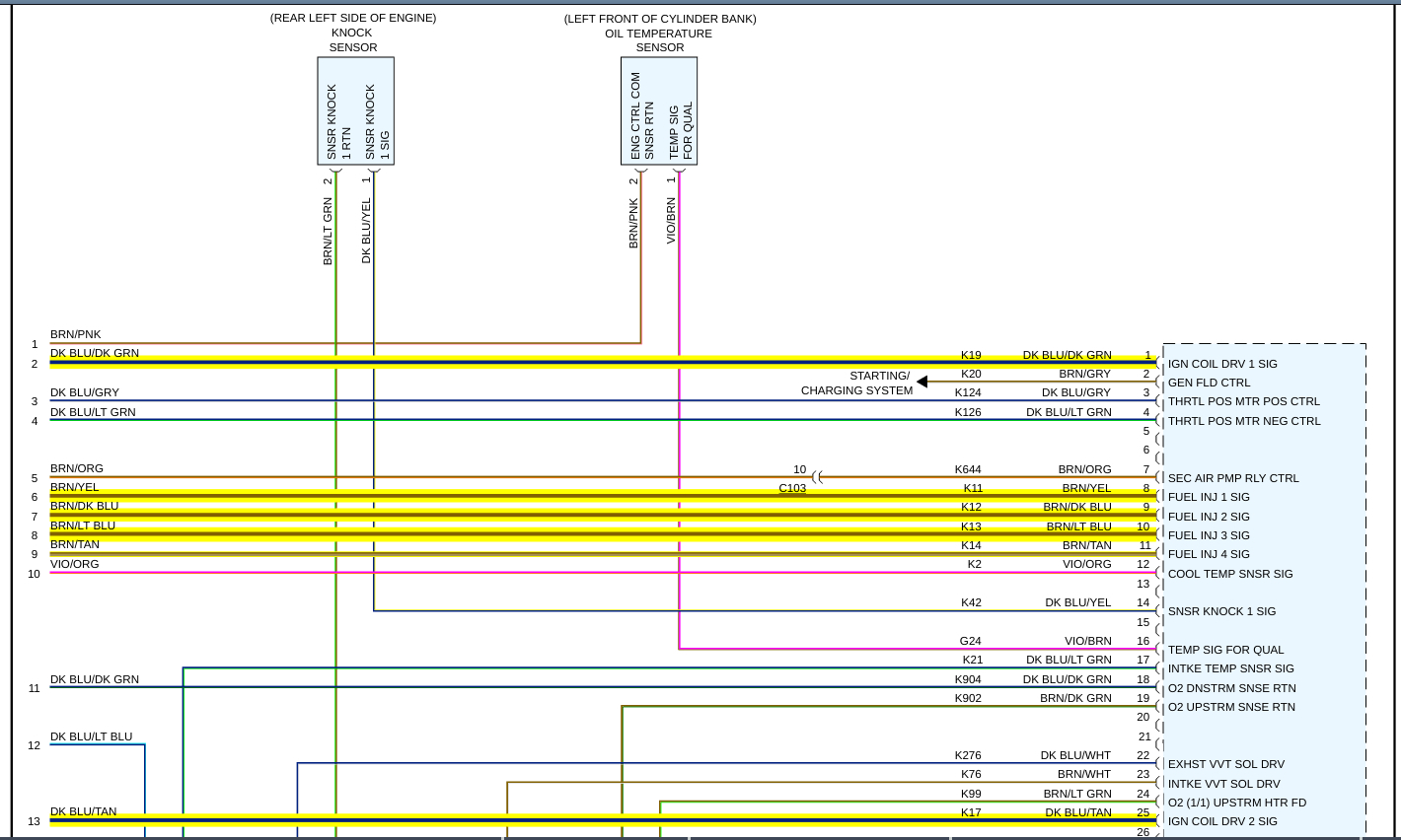

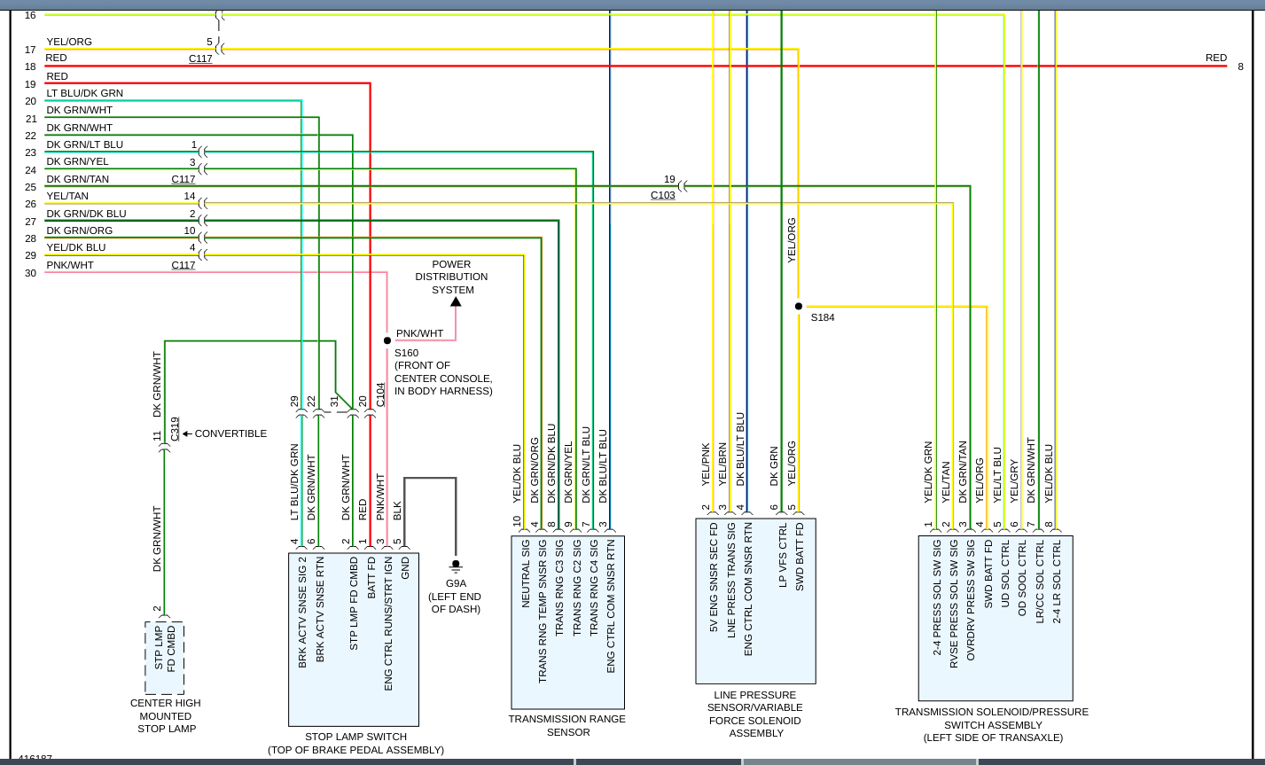

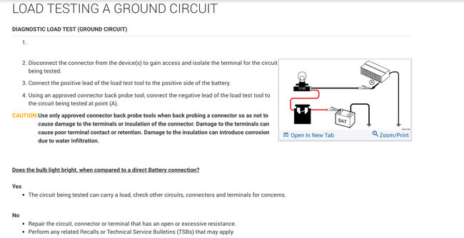

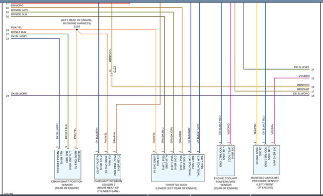

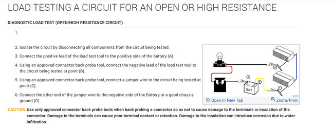

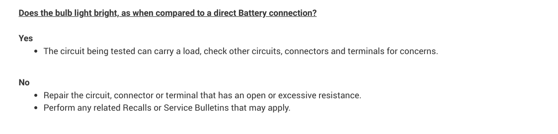

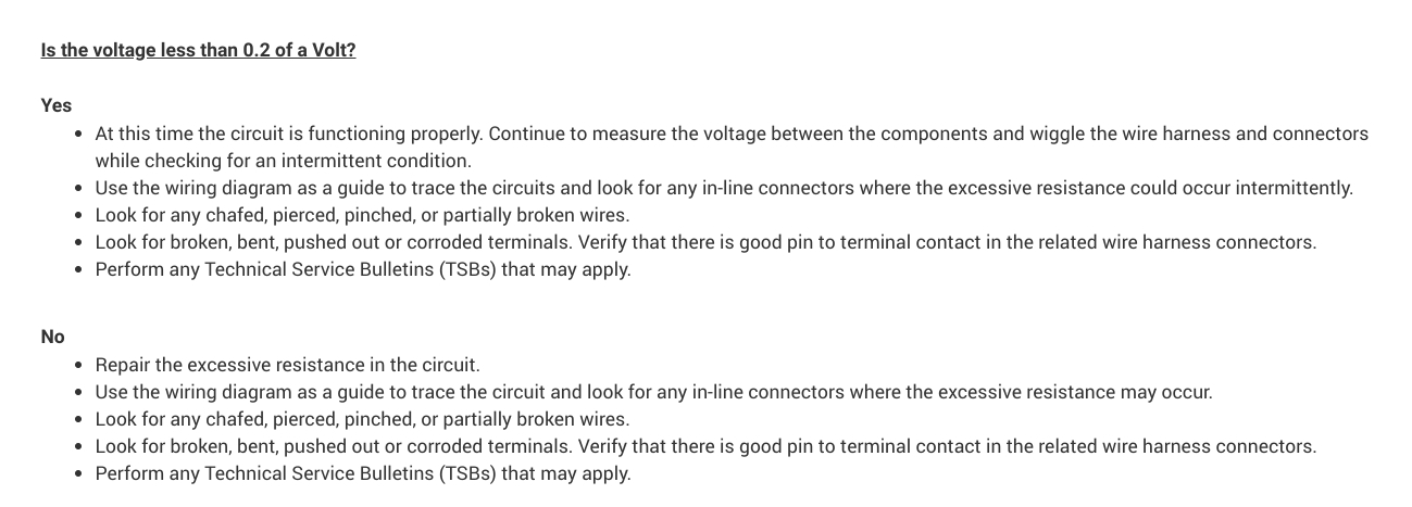

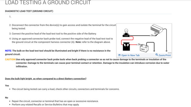

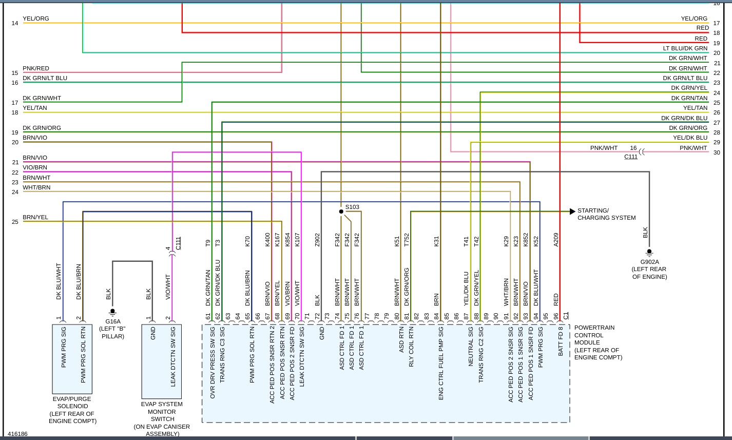

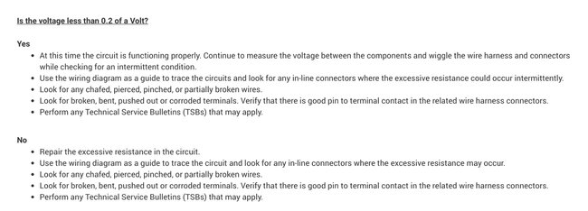

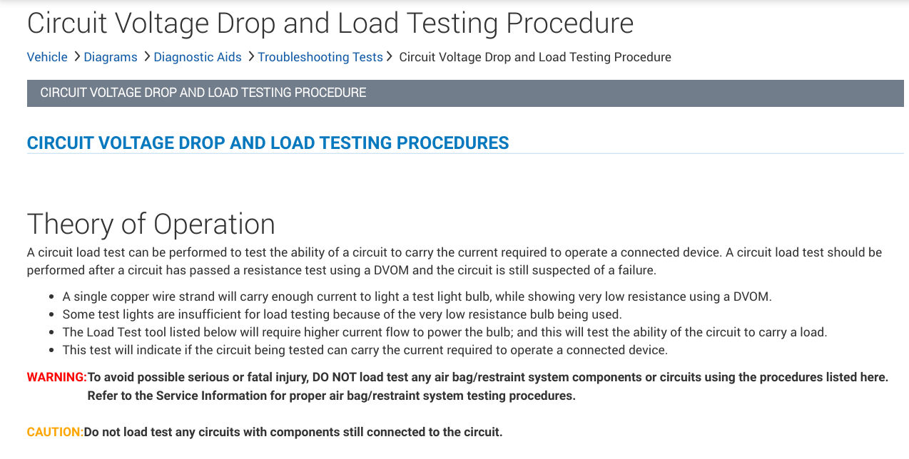

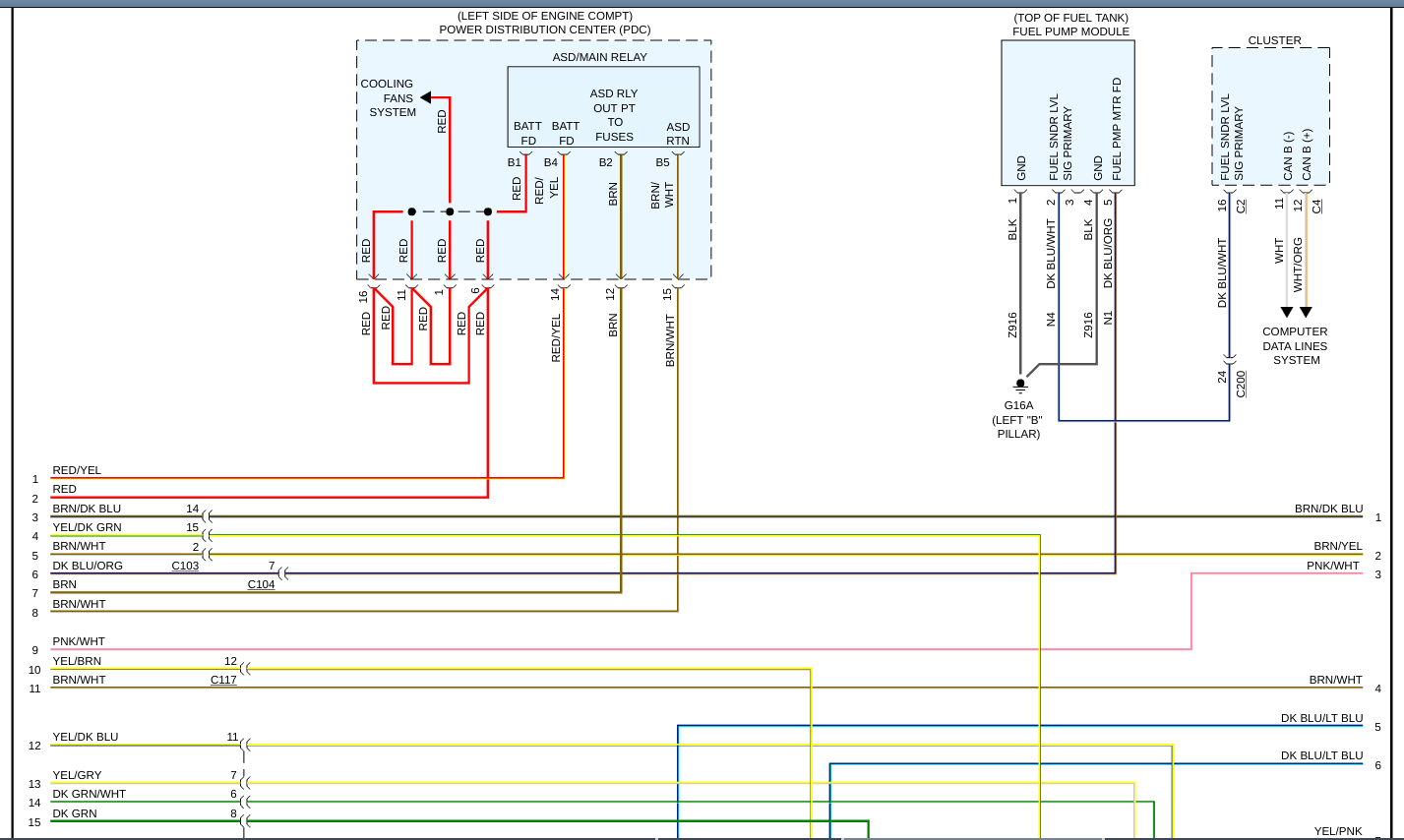

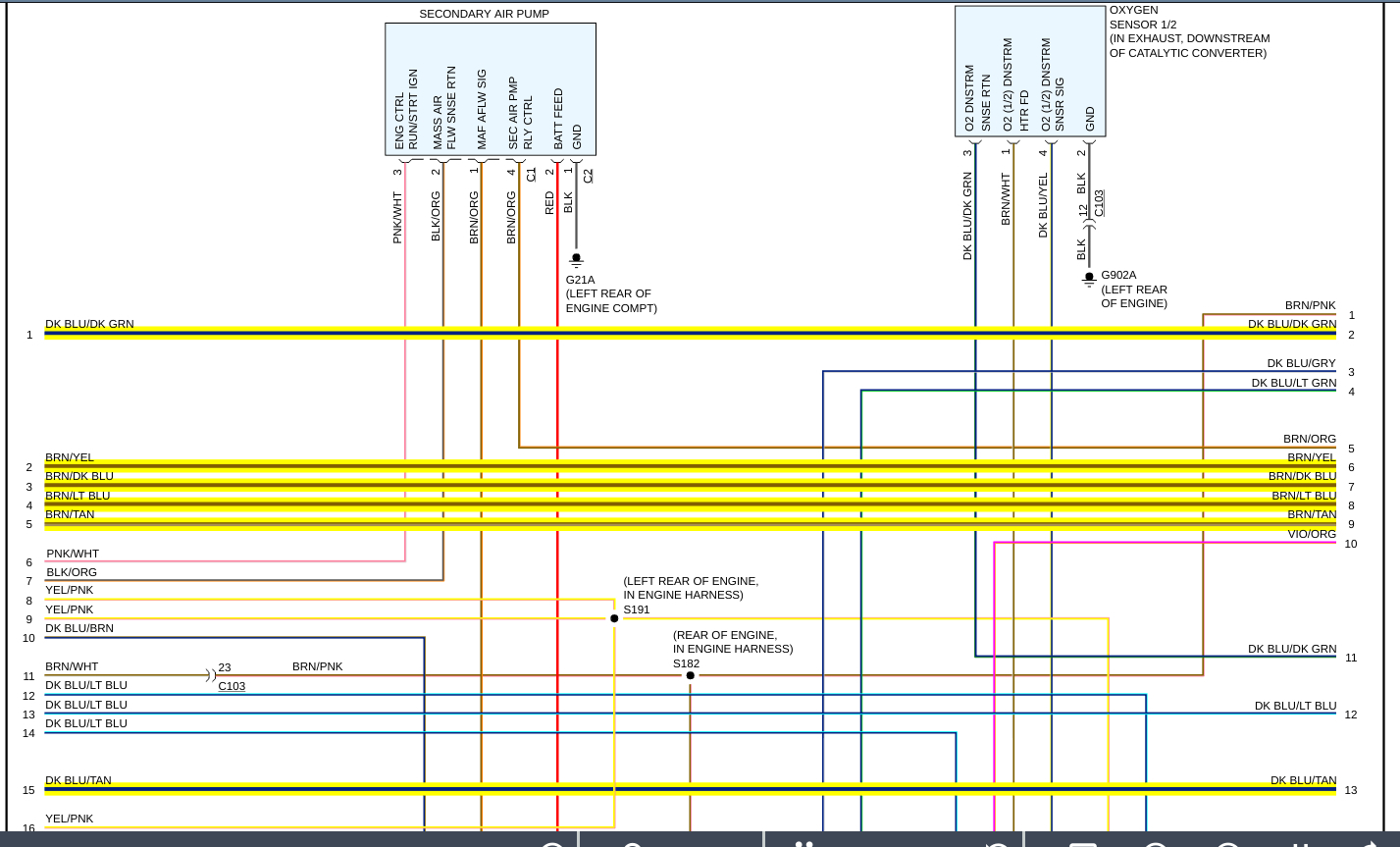

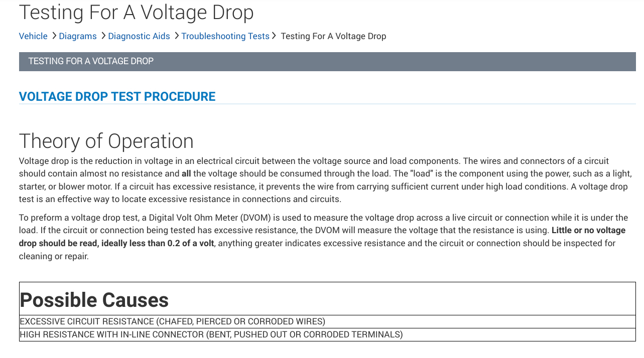

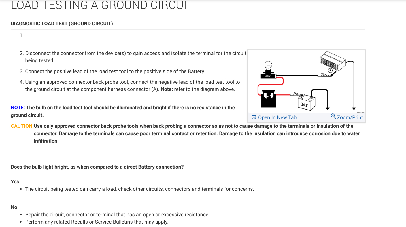

Direct Trouble Code [DTC] P0301 is a DTC for cylinder 1 misfiring. It is usually caused by a bad coil on plug [COP], bad spark plug, or bad fuel injector. Also you should inspect the wiring on the fuel injector or the COP and the electrical connector for unwanted resistance. In the diagrams down below I have included the Engine Management wiring diagrams for your vehicle along with guides on how to find opens in an automotive electrical circuit, and how to find unwanted resistance in an automotive electrical circuit using voltage drop. You will need to use a Digital Multi Meter [DMM] to use these guides, so here is a link below explaining how to use one, if needed:
This guide can help as well
Please go through these guides and get back to us with what you find out.
Thanks,
Alex

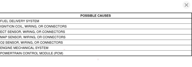

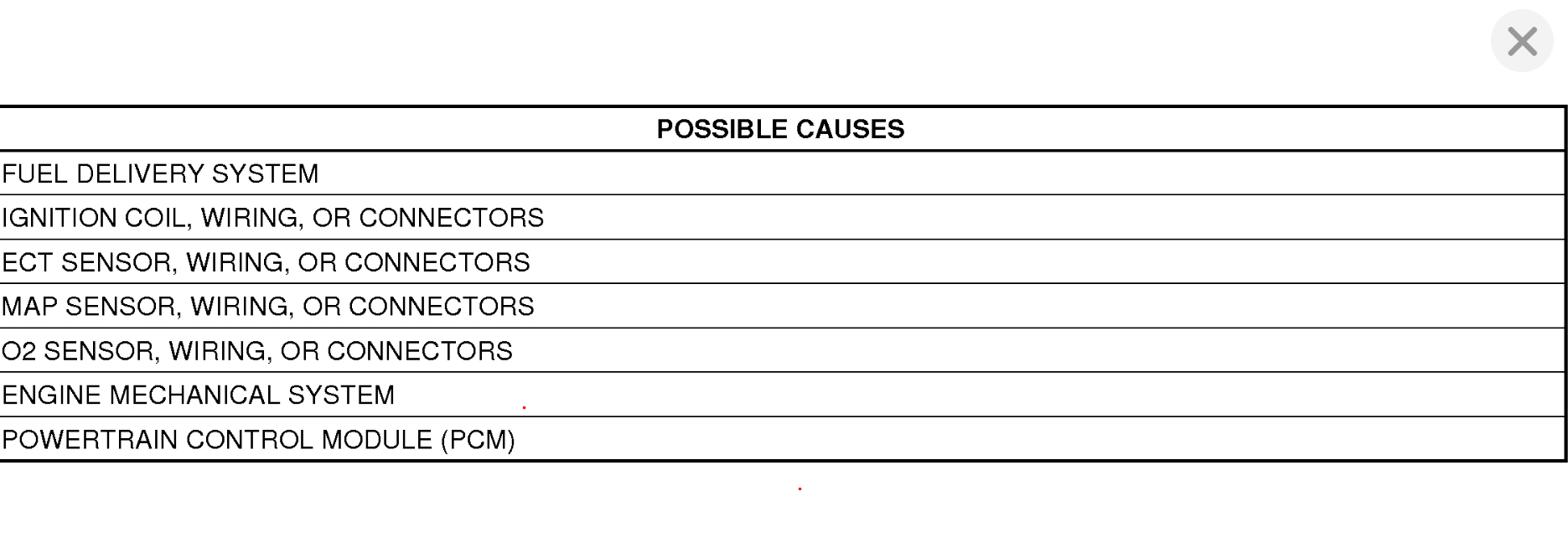

There are a number of things that can cause a misfire. See the attached pic. Also, take a look through this link and see if anything helps.
https://www.2carpros.com/articles/engine-misfires-or-runs-rough
With that, are you getting spark to the cylinder 1 spark plug? Have you checked fuel pressure?
Let me know what all was done so far and how you determine the coil is good.

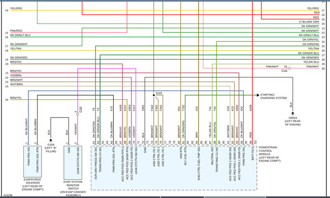

Okay, so you have a P0301 and you swapped the coil and it did or didn't follow where you put the coil? Reading your question suggests it did follow the coil and now that cylinder is missing? Or did you mean you moved the coil from #1 to say #2 and it still has the P0301 code and missing on #1? If it is the second one I would probably check the plugs especially if they haven't been changed in a while. Then use a noid light or a test light to check the injector.
Sep 10, 2020 at 5:29 PM (Merged)
RANDY1955
  • 71 POSTS
No, I meant the first one whatever cylinder I put it in it showed as P304 or 303 and so on.I also purchased a new coil did the same thing as the old one checked the new one out primary and secondary it checked out. so now what?
STEVE W.
  • 15,113 POSTS

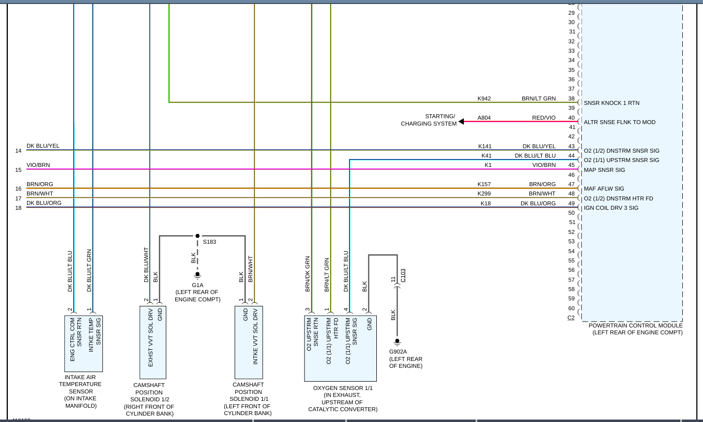

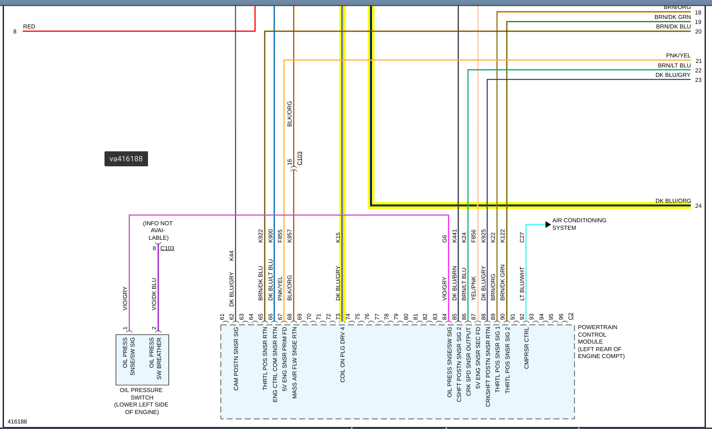

Okay, so the misfire follows the coil but a new coil still misses when put on there. That would indicate that the coil was bad but it may have shorted the driver circuit in the PCM. You should have battery voltage on the Brown wire with Blue trace. That is fed from the same fuse as the other coils, but you could have a bad connector. Next would be to check for the driver signal, it is simply the PCM pulling the coil to ground and releasing it. The fastest way to test it would be a simple test light or noid light that will flash when connected in place of the coil. No flash would mean the transistor in the PCM has failed and you need a new PCM.

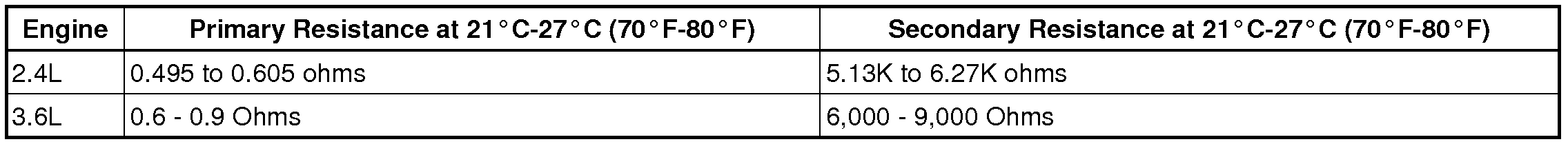

Does any one know the specs for the primary and secondary ohm readings for the coil on plugs?

Posted specs below. Let us know if the information was helpful. Check out the diagrams (Below). Please let us know if you need anything else to get the problem fixed.
