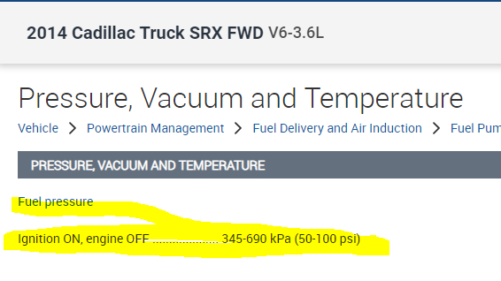

I attached the fuel pressure specifications below. Also, do you have a live data scan tool? If you do, we need to watch the O2 sensor voltages.

See pic below.
