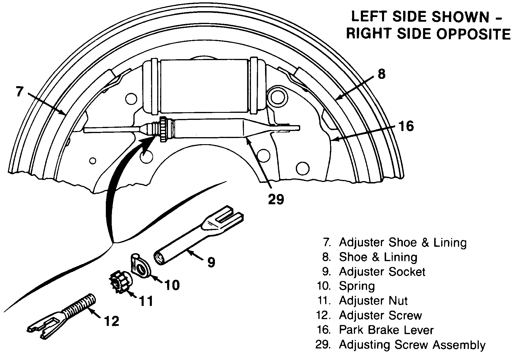

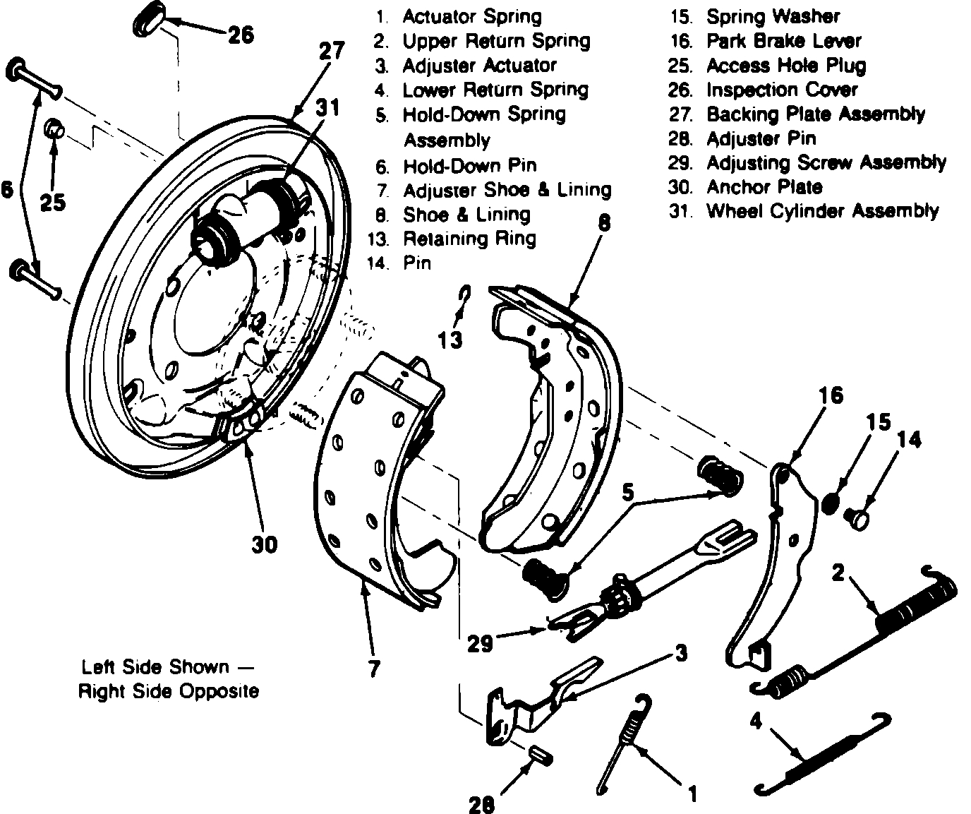

Or here are the directions from Alldata. The attached picture correlates with the directions.
____________________________
1988 Chevy Truck C 1500 Truck 2WD V8-350 5.7L
With Leading/Training Brakes
Vehicle Brakes and Traction Control Drum Brake System Brake Shoe Adjustments Drum Brakes With Leading/Training Brakes
WITH LEADING/TRAINING BRAKES
Exploded View Of Drum Brake Assembly.
Pic 1
Exploded View Of Adjusting Screw Assembly
Pic 2

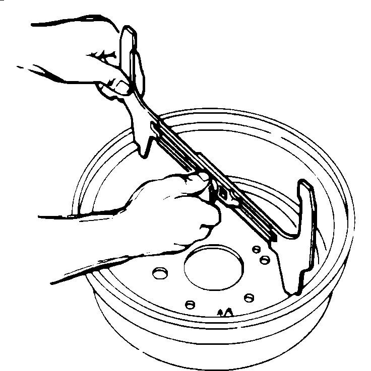

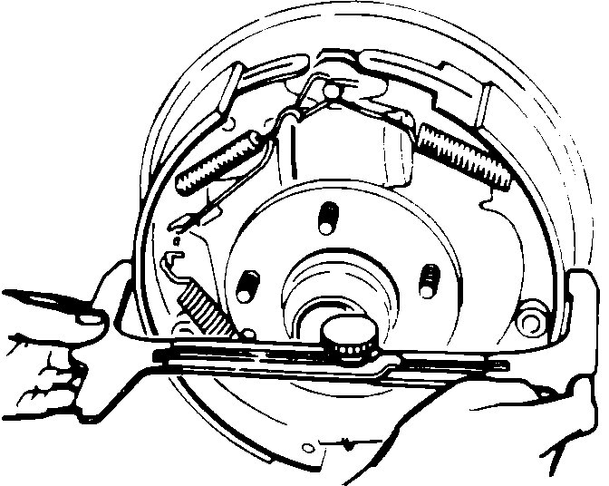

If you look at pic 3 and 4, they show how initial adjustment is done.
Fig. 7 Measuring Brake Drum Inside Diameter
Pic 3
Fig. 8 Adjusting Brake Shoes To Brake Drum Inside Diameter
Pic 4
8. Using suitable brake drum to shoe gauge, Fig. 7, measure brake drum inside diameter. Adjust brake shoes to dimension obtained on outside portion of gauge, Fig. 8.
