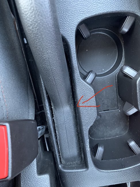

How can get something dropped in between the slot beside the parking brake handle?
2016 CHEVROLET SONIC
40,000 MILES • AUTOMATIC
SORLENT
I dropped something in between the gap of the emergency brake and need help getting it out. It is not magnetic.

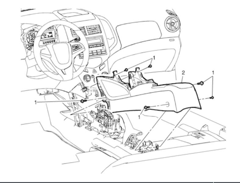

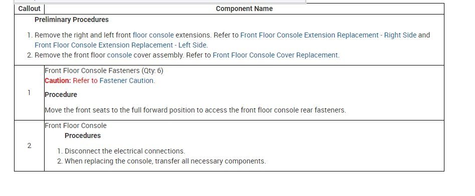

Good morning,
The console will have to be removed in order to access the area around the brake release. I attached the procedure below with a picture for you. Check out the diagrams (Below). Let us know what happens and please upload pictures or videos of the problem.
