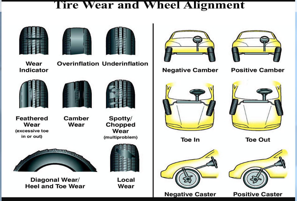

If the noise is the same no matter what you do and it starts at lower speeds and stays the same then I suspect the tires are the issue.
Below is a chart that will help you inspect the tires to make sure they don't have wear patterns in them.
Let us know what you find. Thanks

Thanks. I've had tires changed and alignment with no difference. The noise has increased over the past few months so I've given it to a transition mechanic to see if there are issues with the auto transmission.
The sound is constant when driving from 20klm per hour till around 90 klm and is at the same rhythm with no change regardless of speed. At over 90 klm it diminished and is less obvious.
If it was mechanical or tires I'd say there would be a increase in rythmic noise but there isn't.
