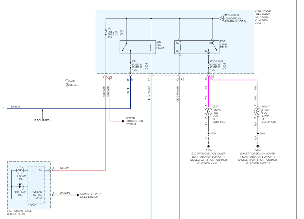

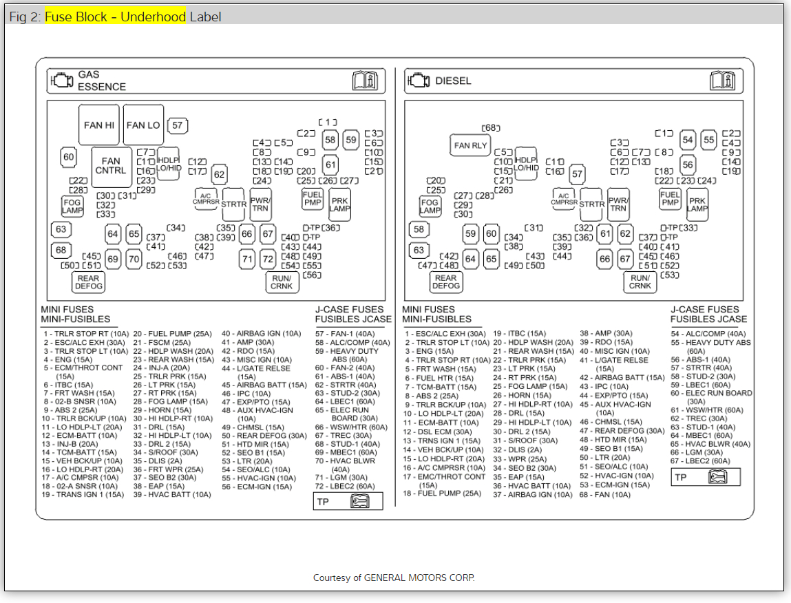

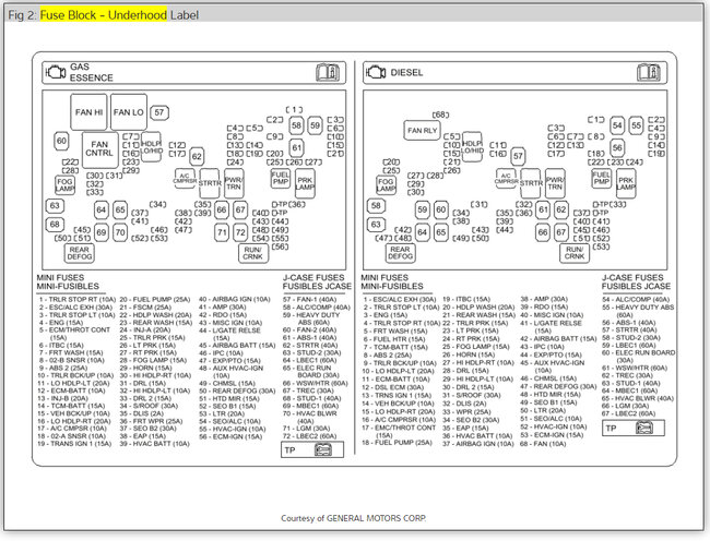

I would check the fuse # 31 or 28 int he under hood fuse panel here is a guide to help and also there is a relay DRL PCB int he same fuse panel I would swap that out if the fuse is okay.
Check the images below you please get back to me.
