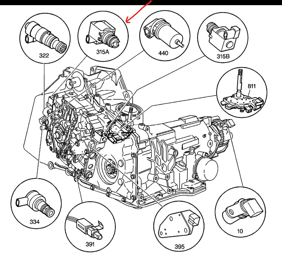

Car will only go forward in second gear.
Aug 27, 2023 at 11:53 AM
CERTIFIED EXPERT
53,854 POSTS
This can mean the first gear shift solenoid needs to be replaced but we should run the codes first, here is a guide to help:

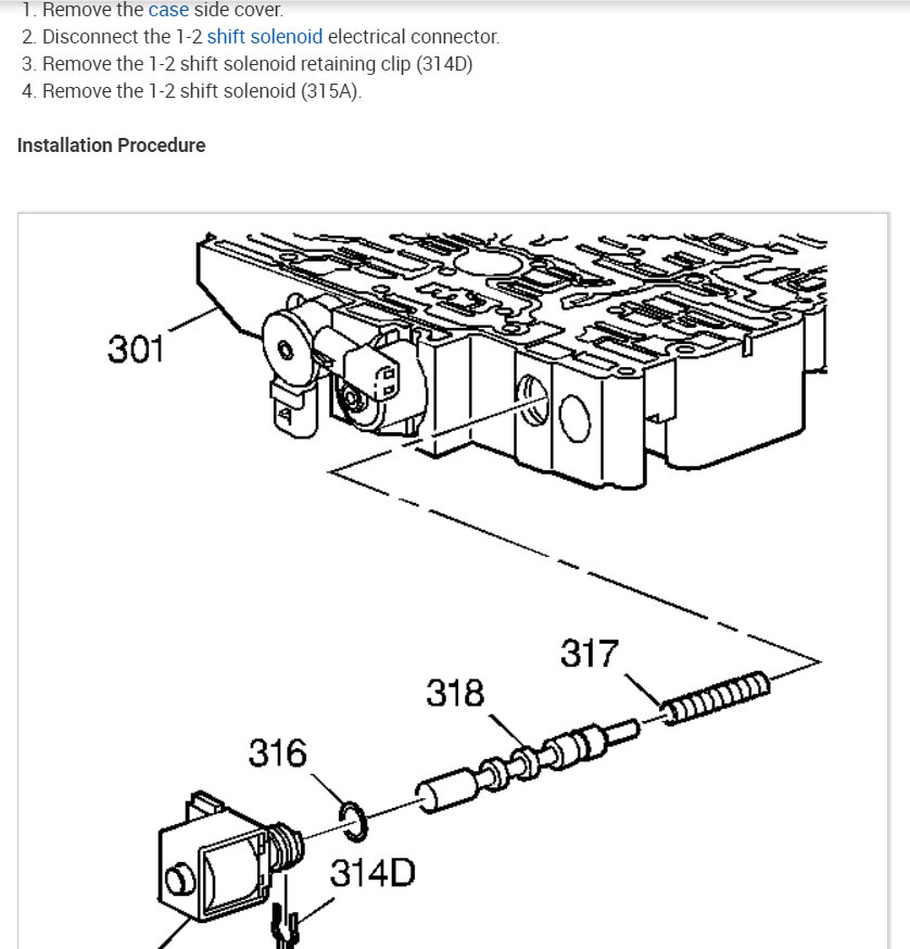

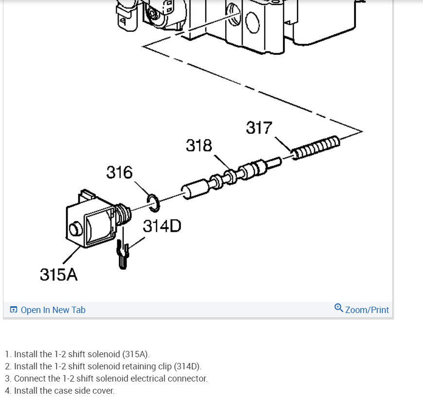

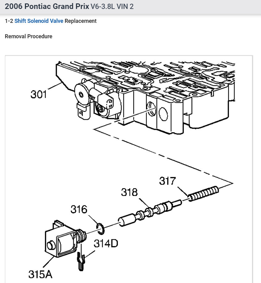

Here is how to change the shift solenoid out in case you need it. Check out the images (below). Please let us know what happens.
