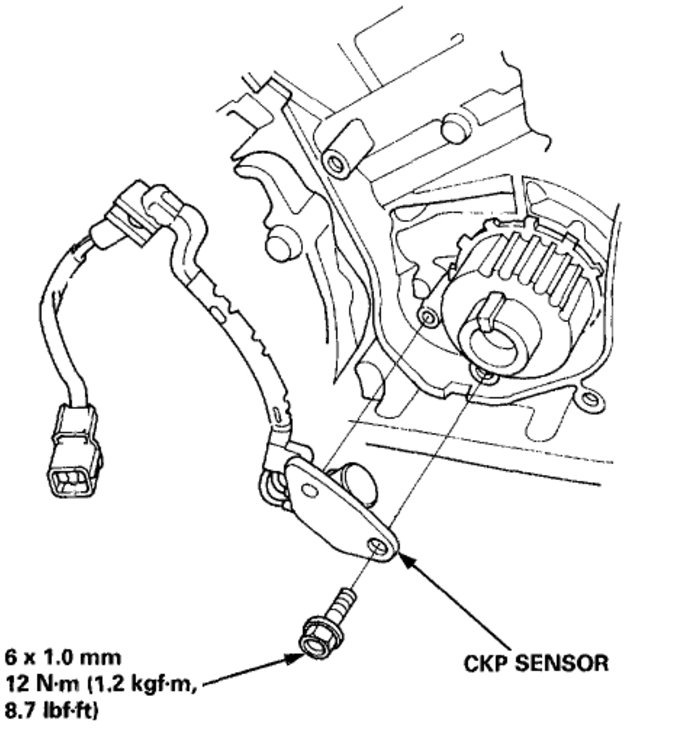

It sounds like you have a crankshaft sensor going out. When this sensor fails it may or may not trigger a check engine light. Here is a guide to show you what you are in for when changing the sensor along with some diagrams on what it will be like on your car. (below)
and
https://www.2carpros.com/articles/engine-stalls
Please let us know what happens so it will help others.

Hi Mark,
These two issues are not related. I would start with the crankshaft sensor because the computer cannot see when the sensor is bad in most cases. Next start a new question for the ticking axle issue.
