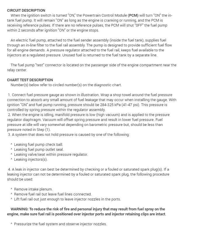

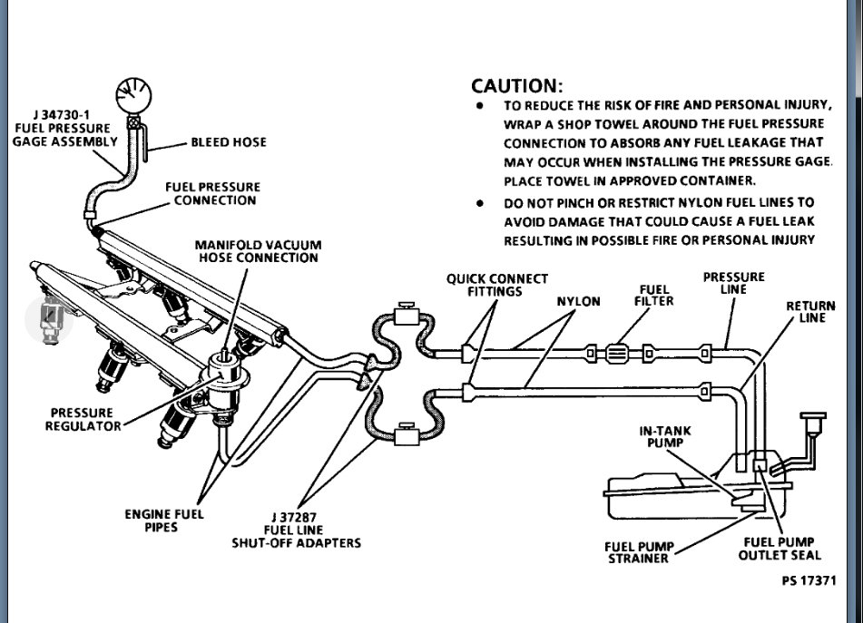

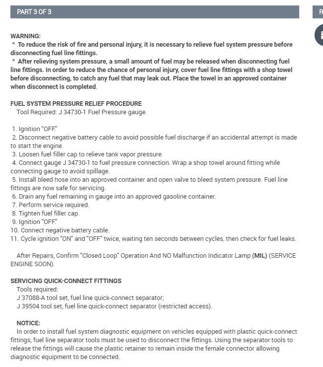

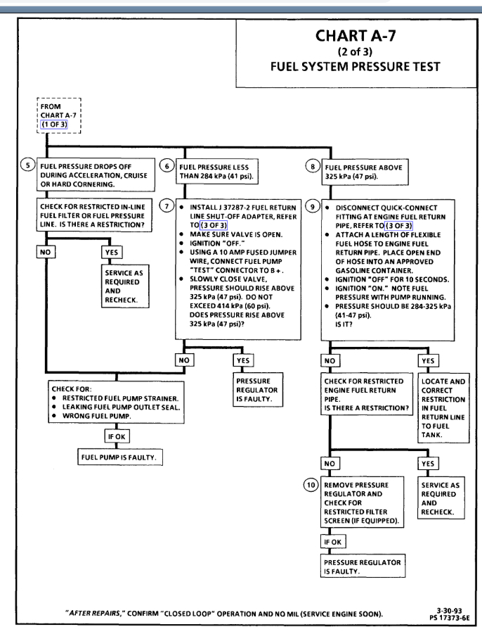

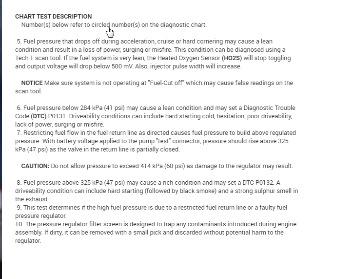

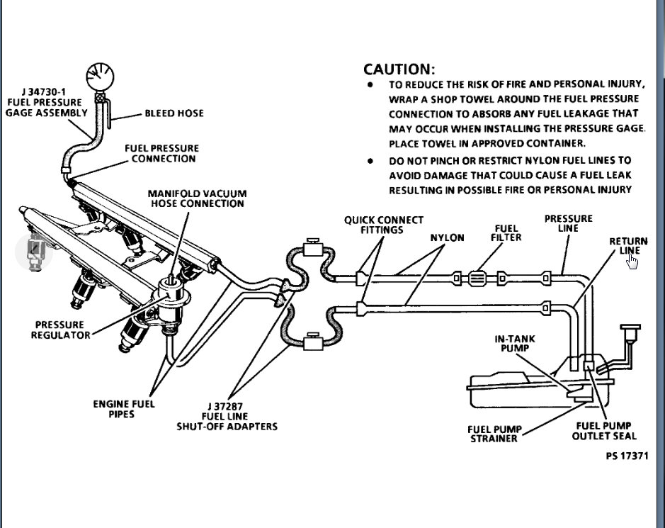

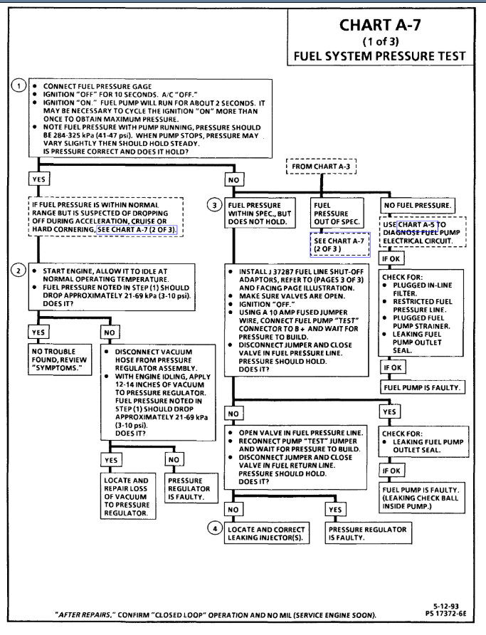

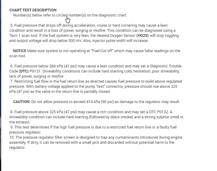

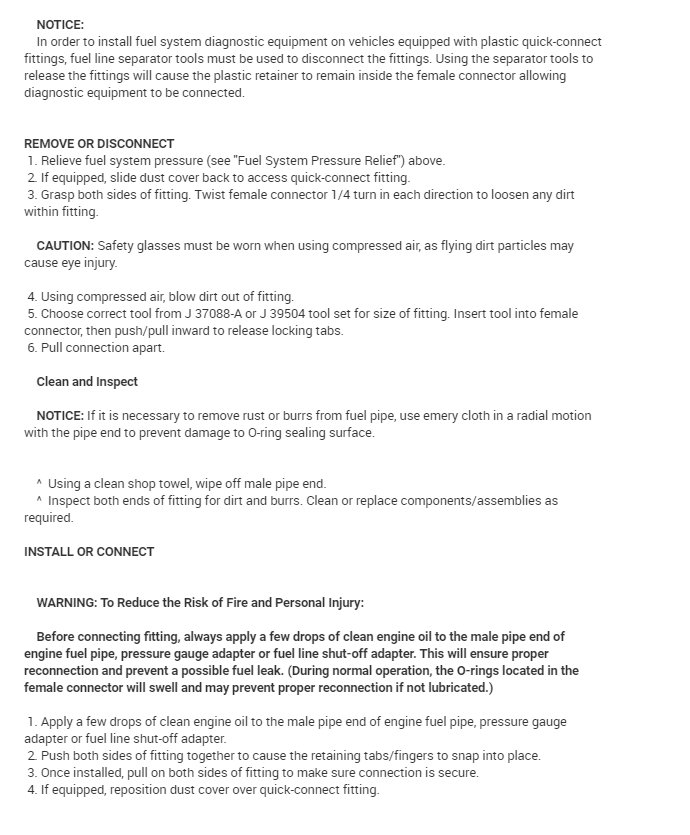

Let's start with getting the fuel pressure as this sounds like it is getting starved of fuel. I attached the complete fuel system test that we need to follow to determine if this is the issue.
Let e know what you find and we can go from there. Thanks

Now, if you find codes, let me know what they are. If nothing is found, then we need to start checking different components. First, confirm the fuel pressure is within the manufacturer's specs.
You will need a fuel pressure gauge to do this, but most parts stores will lend or rent one to you.

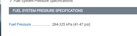

Here are the specs for this vehicle.
1994 Oldsmobile Cutlass Ciera V6-3100 3.1L MFI VIN M
Fuel System Pressure SpecificationsNehicle Powertrain Management Fuel Delivery and Air Induction Fuel Pump Fuel Pressure Specifications Pressure, Vacuum and Temperature Fuel System Pressure Specifications
FUEL SYSTEM PRESSURE SPECIFICATIONS
Fuel Pressure .................... 284-325 kPa (41-47 psi)
_________________________________________
