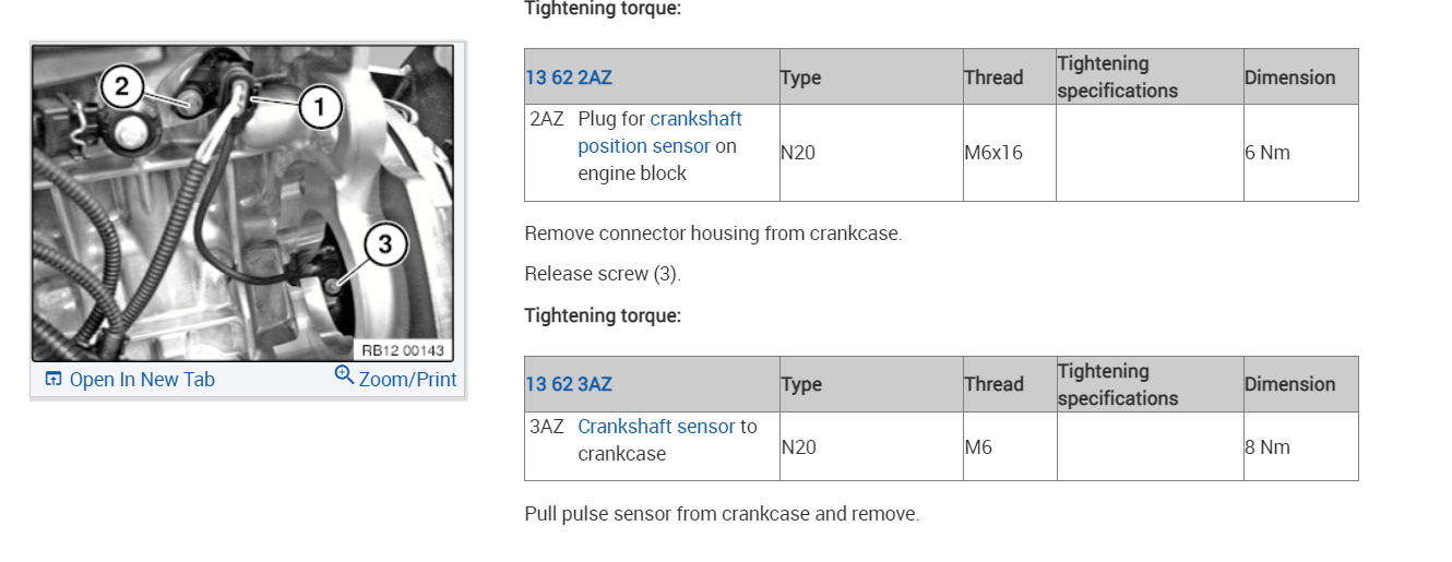

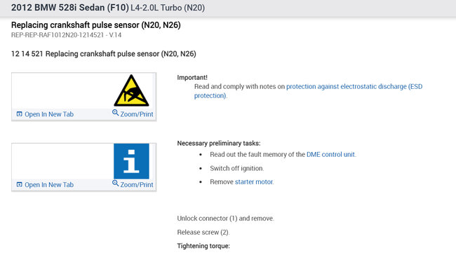

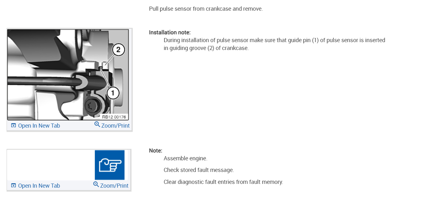

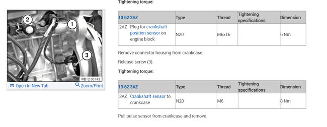

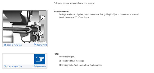

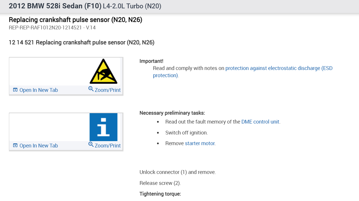

Yep, breaking down is no fun, the information on our end says the codes is for both the crankshaft and camshaft sensors so I would replace the crankshaft position sensor and if that doesn't fix it the timing chain might be the issue which is common on these cars.
code P1339 generally indicates a malfunction within the circuit of either the camshaft or crankshaft sensor.
Check out the images (below). Let us know what happens and please upload pictures or videos of the problem so we can see what's going on.
