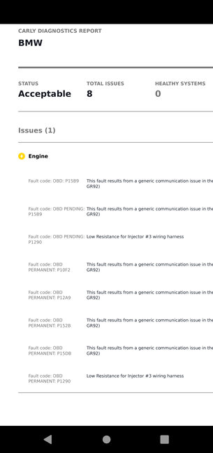

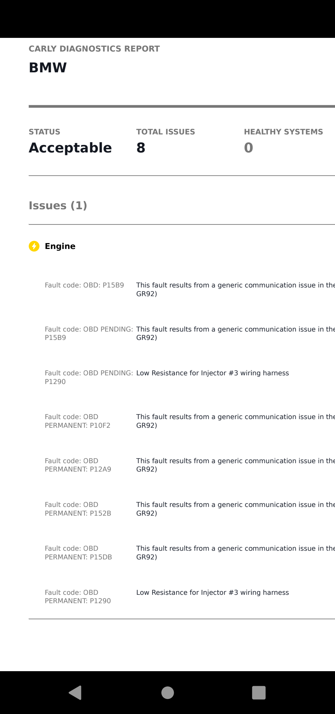

Yes, the charge pipe has been checked and secured. I have a picture of the p codes.

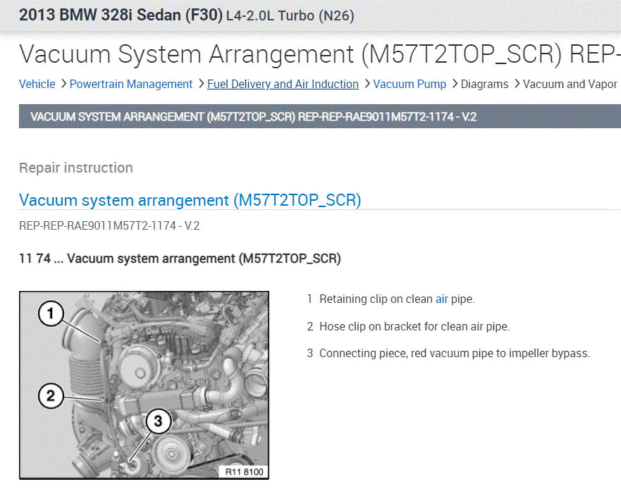

Thanks for the updated codes. Interestingly, some I show and others not. After going through them and thinking you were hearing a noise, the one that caught my interest was the P10F2. That isn't a generic communication code as mentioned on the printout. It indicated the charge air pressure is too high in relationship to the barometric pressure.
Have you checked the wastegate? Its purpose is to divert excessive exhaust gases away from the turbo. It controls the speed of the turbine preventing it from spinning too fast. I'm questioning if that is what you hear.
The P12A9 indicated a pressure difference also and is related to the after-run. The after-run determines whether the ambient pressure, intake-manifold pressure, and charging pressure sensors are all registering a single pressure reading.
The remaining codes are not found in my manual for this year, make, and model.

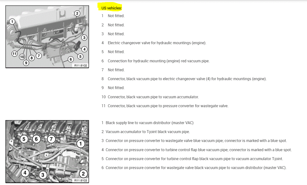

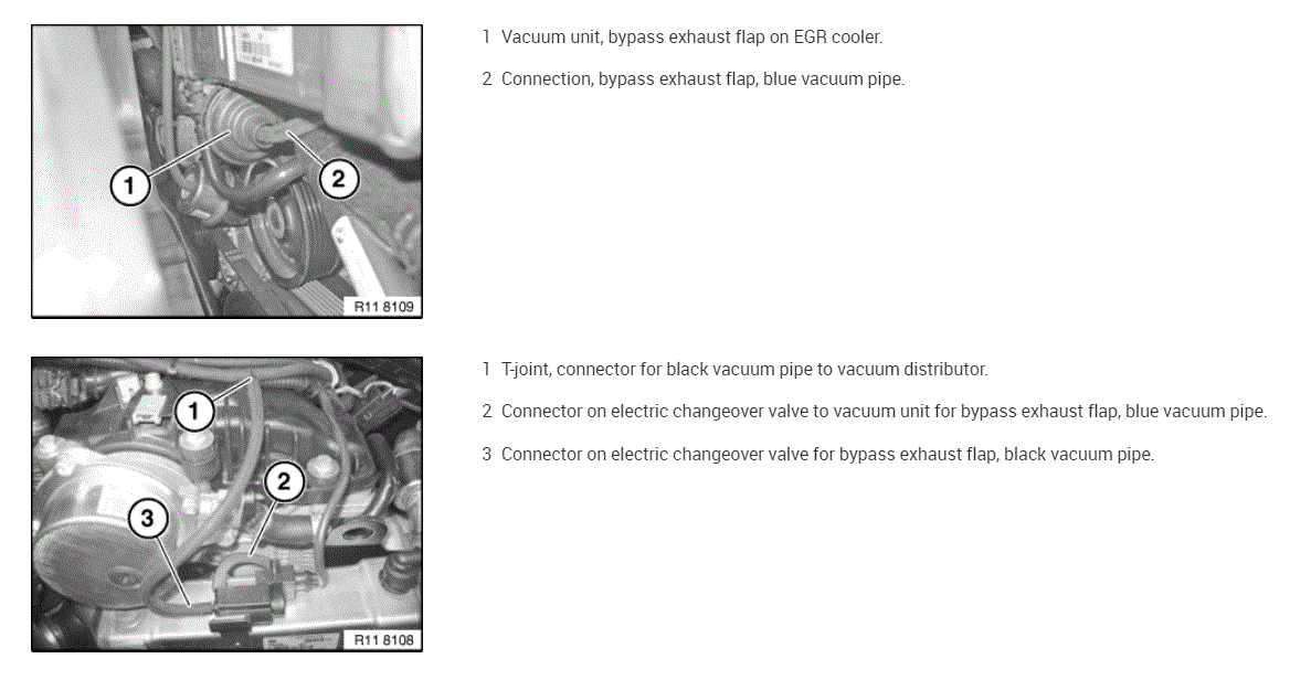

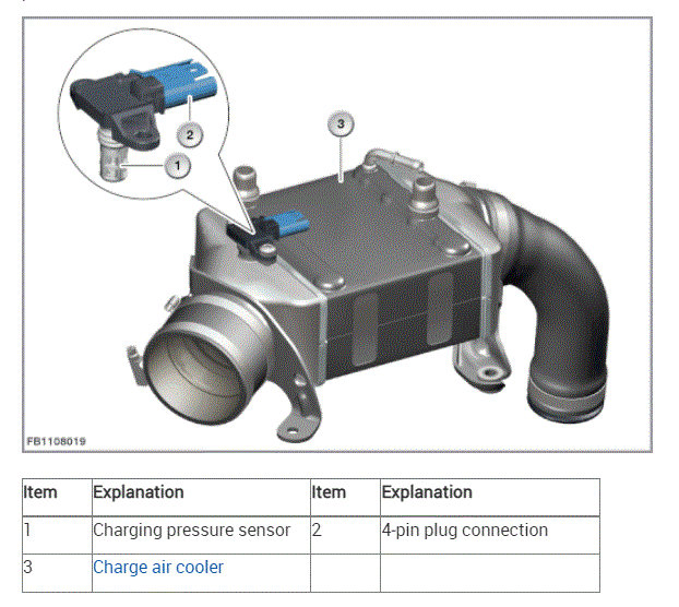

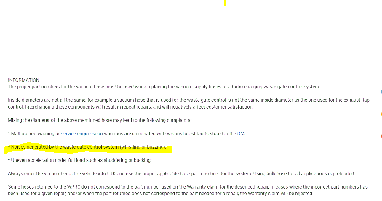

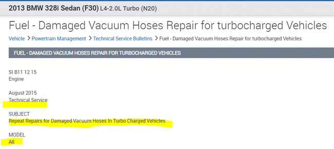

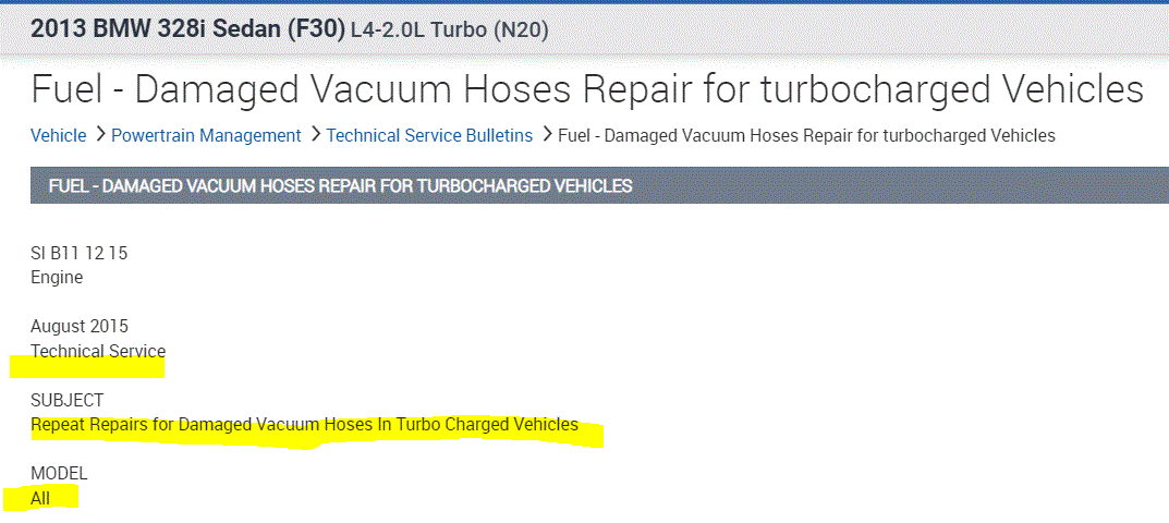

Pic 1 below shows the sensor. Also, I came across a technical service bulletin that you may find interesting and may actually be the issue. Read through pics 2 and 3.
Let me know your thoughts.
See pics below.

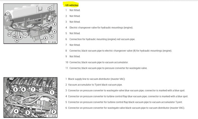

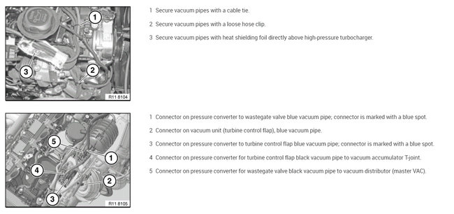

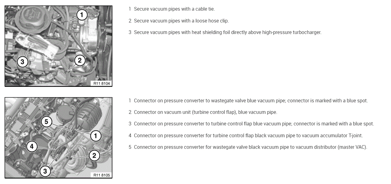

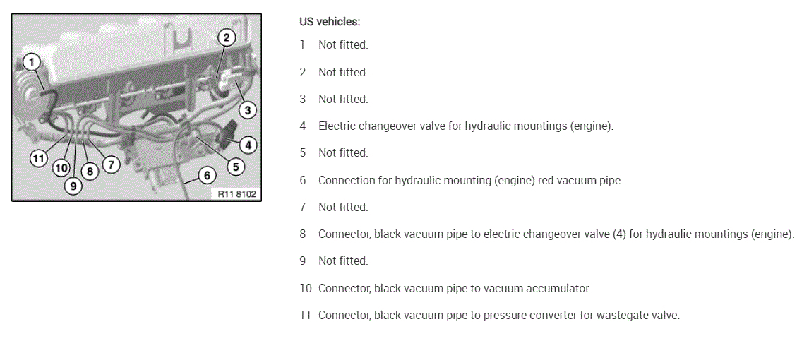

I've had the wastegate off, it was stuck closed. Got it freed up and put back on. I've replaced the vacuum line on top of the engine, but I can't seem to find it anymore. Would you happen to have a diagram of the vacuum hoses? My engine is the N26 not sure if that matters too much or not.
May 16, 2022 at 9:39 PM

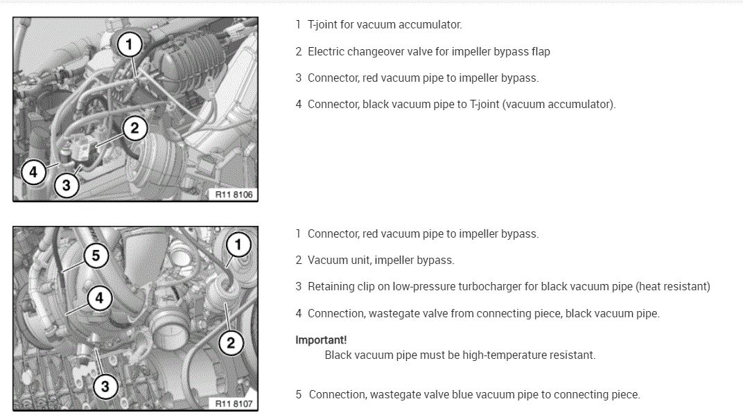

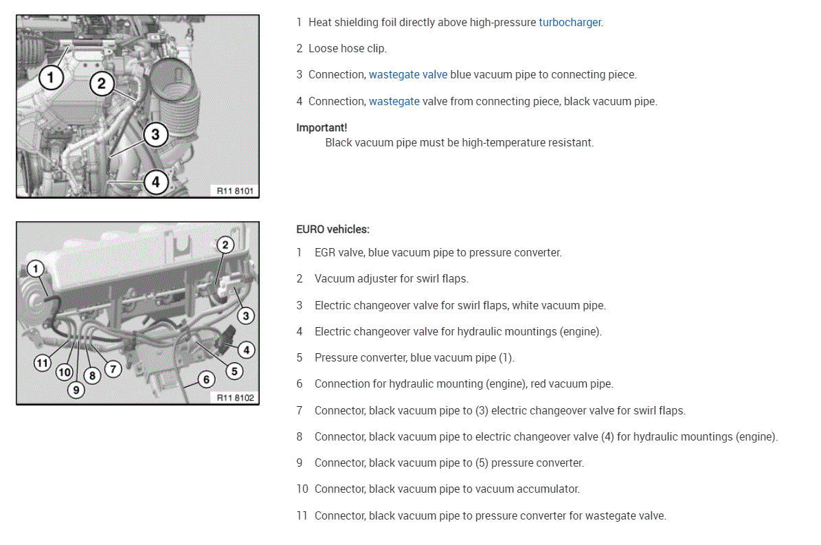

You are one of the few that know the engine. LOL Yes, it helps.
I attached everything I have related to the vacuum system. Take a look through them and hopefully, they will help.
Take care and let me know if you have questions.
See pics below.

Sorry for the late reply. I just wanted to thank you for your help. I still have a few little minor issues, but my main concern was getting it out of limp mode, and I was able to do that. I loosened the wastegate arm and PB Blasted the heck out of it and put it back on and tightened the nut back up and it was out of limp mode. Still tries to stall out at idle but runs so good. Thank you again for all your help.
