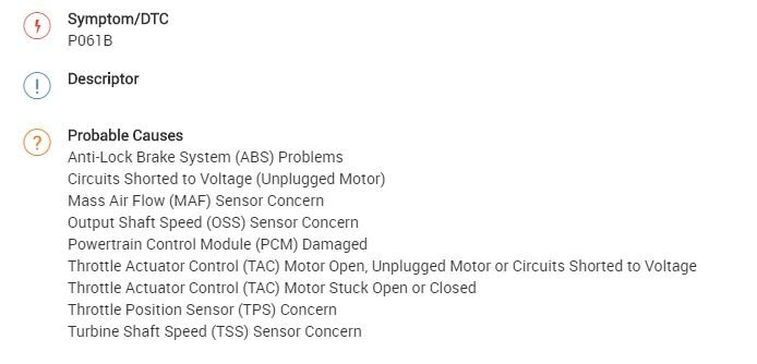

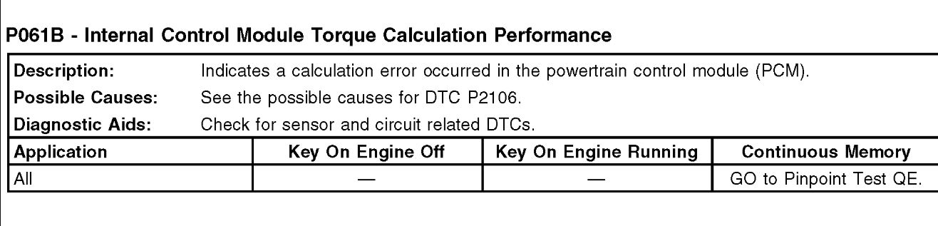

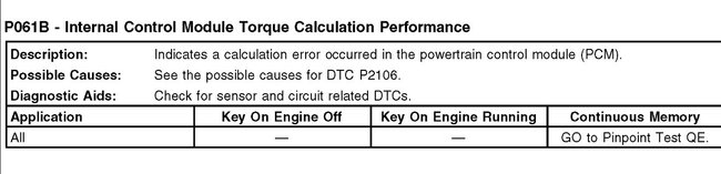

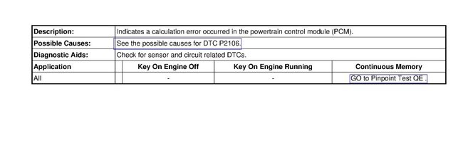

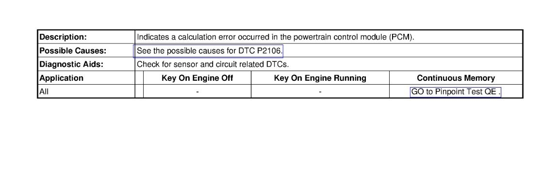

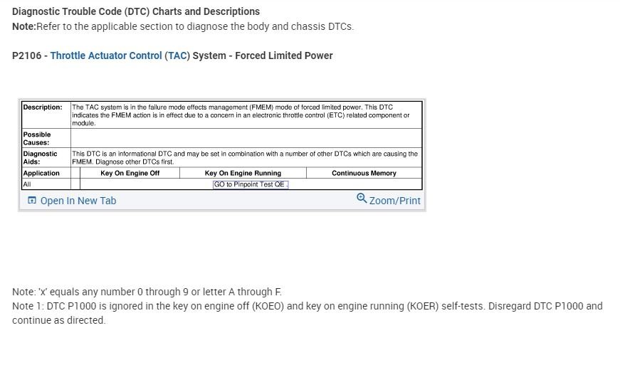

When driving in snow or slush above 45 mph, I feel a quick jerk or hesitation on an intermittent basis. After a couple of times the wrench light for the drive-train comes on and I loose engine performance. Only happens in snow, not rain or dry pavement regardless of the temperature outside. Shut the engine off and restart and the light is out and drives okay until the next jerking episode.
